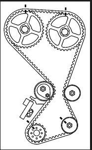

Please send a diagram or and a picture to assist in changing.

The timing belt should be changed between 90,000 and 110,000 miles. To change the timing belt will require you removing the front balancer and timing cover.
Here is a guide to show you how to remove the balancer:
https://www.2carpros.com/articles/how-a-harmonic-balancer-works
See the diagrams (below).
