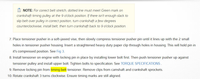

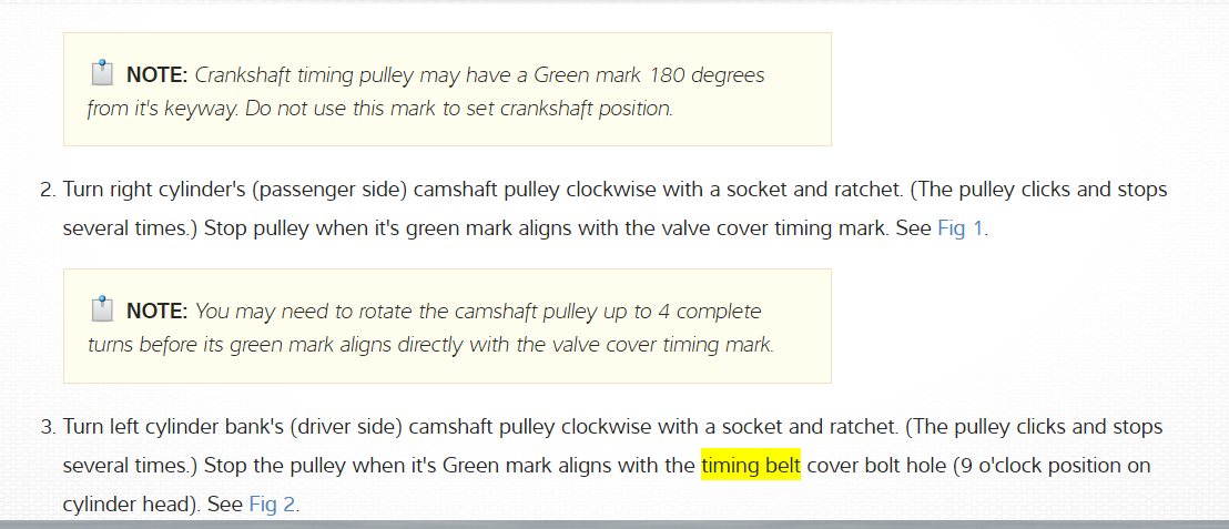

I'm trying to set the timing on. It has notches and green marks as well. can someone please tell me how to do this? I am no mechanic. I have replaced the thermostat, water pump, timing belt and pulleys as well as fuel injectors and crank sensor. please help me!

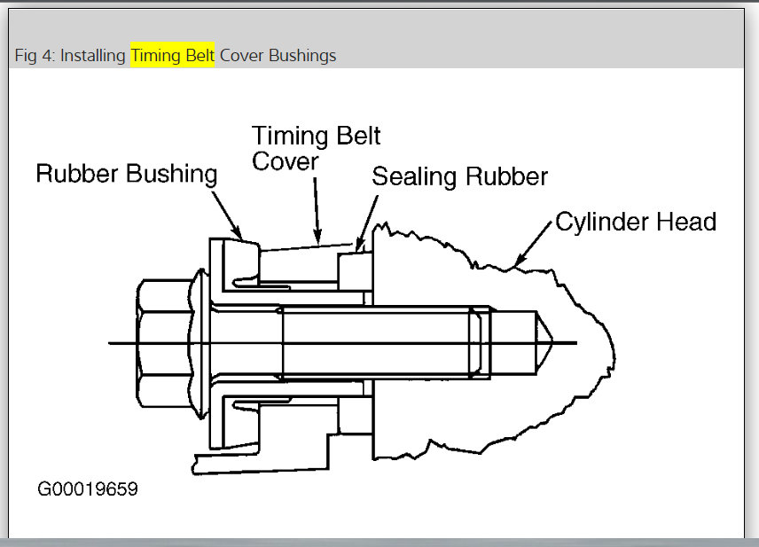

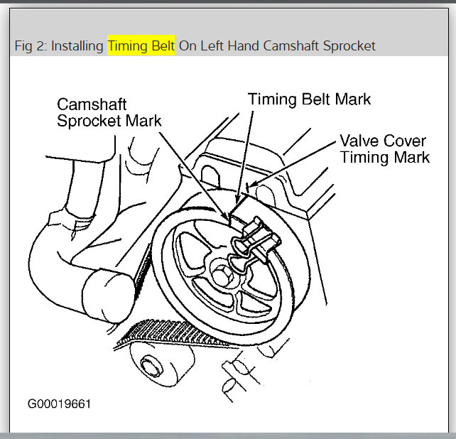

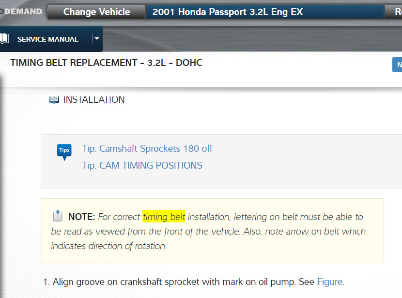

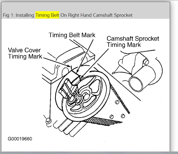

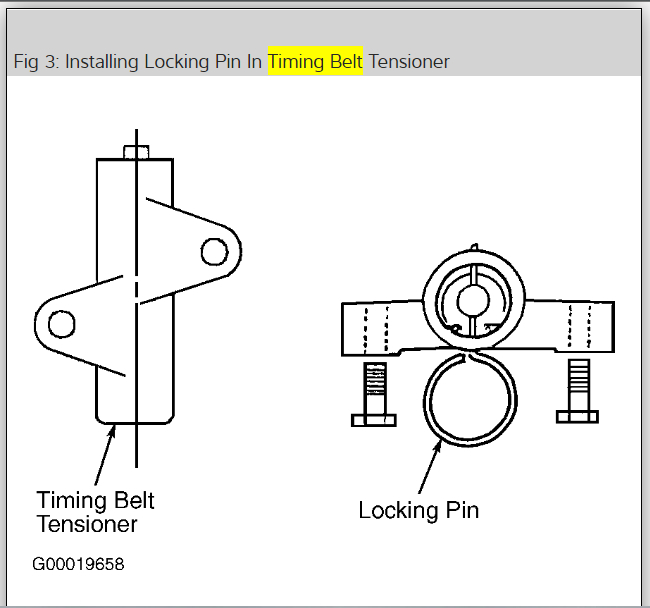

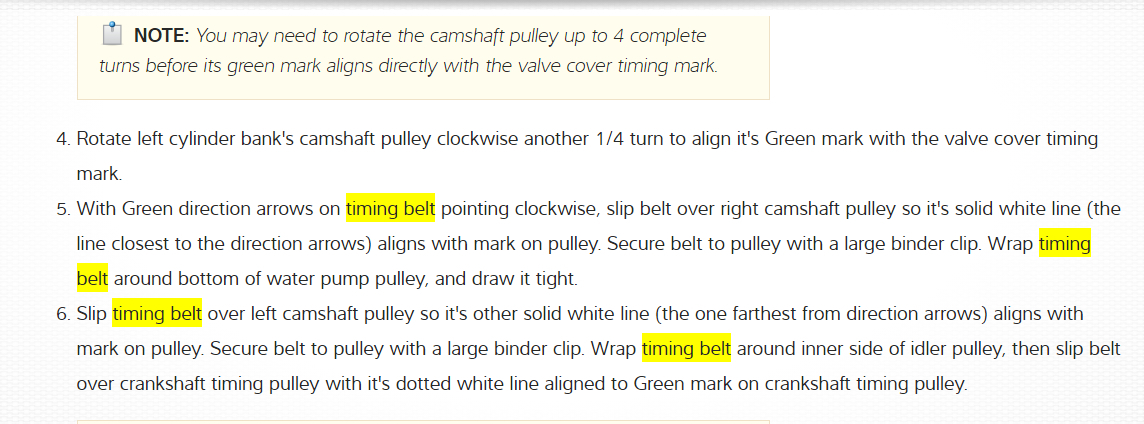

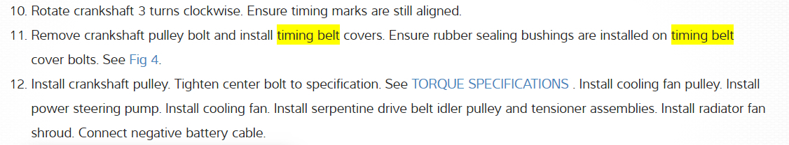

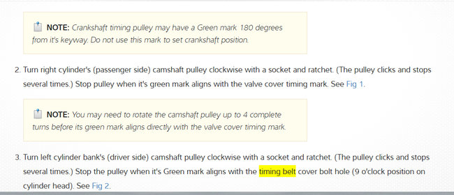

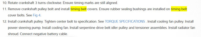

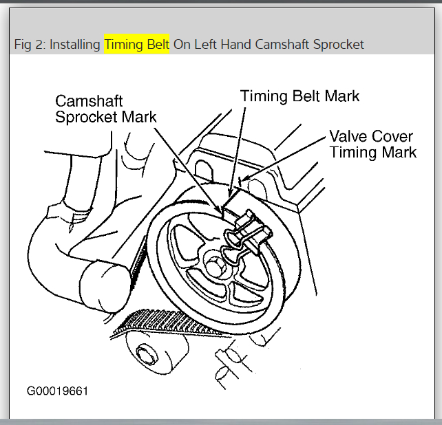

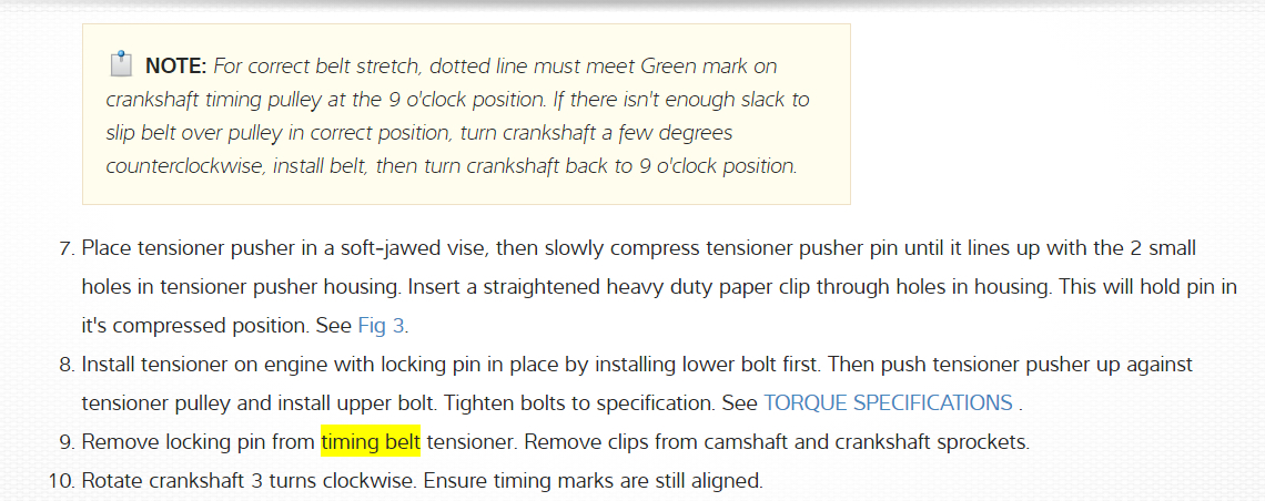

I have included all the information that you have requested in the diagrams down below. Please let us know if there anything else that we can help you with.
