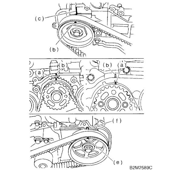

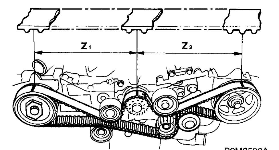

Yes, it is an interference motor.
You must be careful aligning the marks as you can do valve damage.
