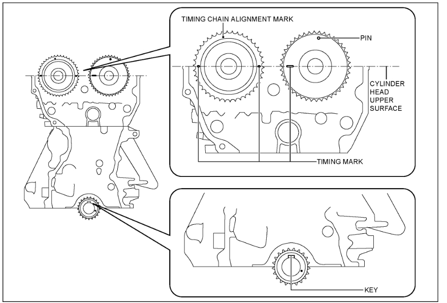

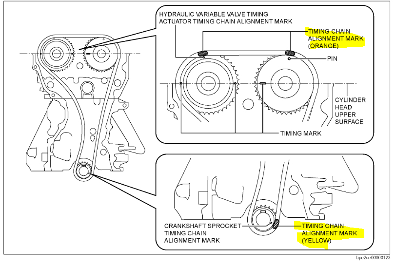

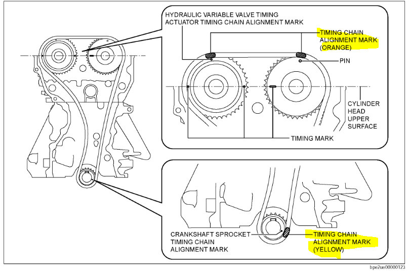

Installing the timing chain and I need to find TDC, Top dead center, secondly I’ve don’t this three time because after I install the chain I rotate the crankshaft pulley and after two full rotations the links are off by one link. I I’m thinking it’s the tensioner and the instructions are very complex as to where the tensioner lie supported by a m6 bolt. I’ve attached the instructions which I make sense of it. All the help I’ve gotten has style everyone. My chain comes with painted links so it’s easy to see where they go, but it’s just a few steps I’m not clear on. How the exhaust cam the other how they need to sit when I place the charge and then from there one it should be very simple. Installing the chain cover the rest is pretty simple. I just need a second pair of eyes to confirm what I’m doing is right.
