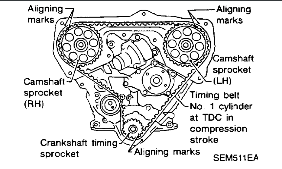

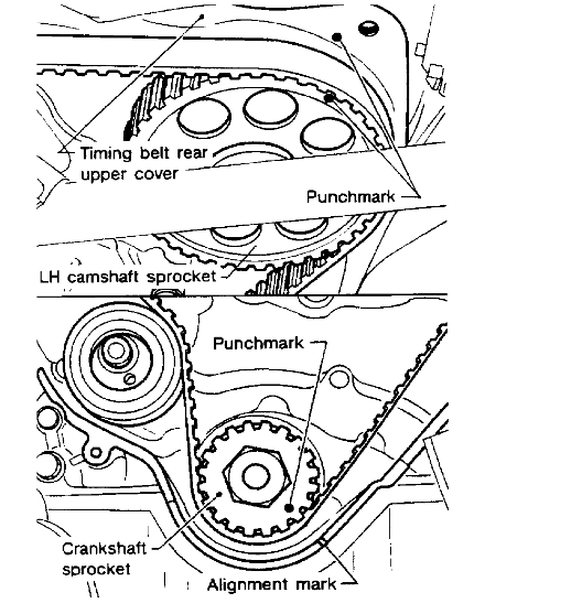

I put crankshaft at 0 degrees, but forgot to align to cylinder one, then moved the camshaft manually to the corresponding marks. Worried it is off (at exhaust phase vs compression phase). Can I correct by moving the camshafts back?
