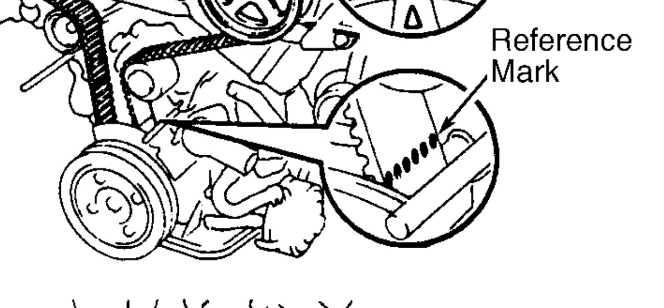

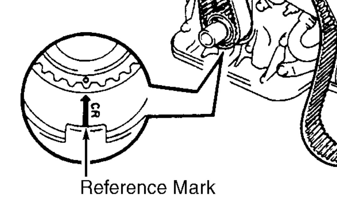

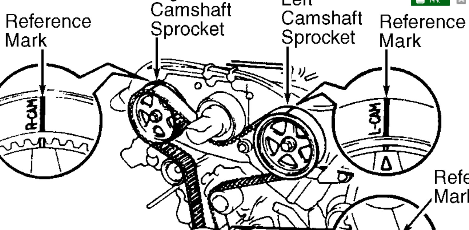

Replaced water pump timing belt came off. where do i put the marks on crank and cams?

see pictures for line up hopefully belts will still have marks on them or replace belt and tensioner it is due anyhow.
