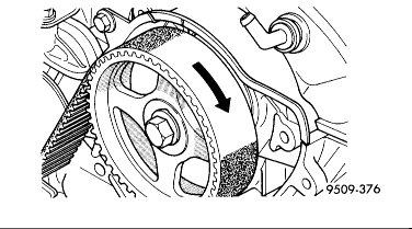

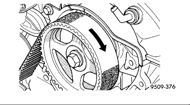

Mark Direction Of Timing Belt
Mark timing belt running direction for installation.

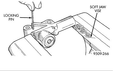

Timing Belt Tensioner
When tensioner is removed from the engine it is necessary to compress the plunger into the tensioner body.
Timing Belt Tensioner Compressing
Place the tensioner into a vise and slowly compress the plunger.
CAUTION: Index the tensioner in the vise the same way it is installed on the engine. This is to ensure proper locking pin orientation when tensioner is installed on the engine.
When plunger is compressed into the tensioner body, install a locking pin through the body and plunger.

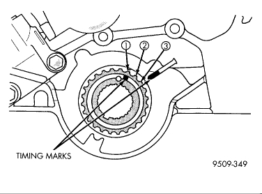

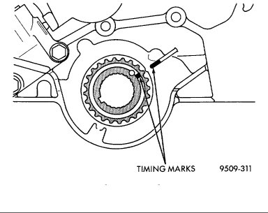

Crankshaft Sprocket Timing
Set crankshaft sprocket to TDC by aligning the sprocket mark with the mark on the oil pump housing. Then rotate crankshaft 3 notches before TDC.

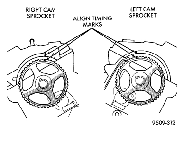

Camshaft Sprocket Timing
Set camshaft sprockets to the aligning marks on the sprockets with the marks on the rear timing belt cover.

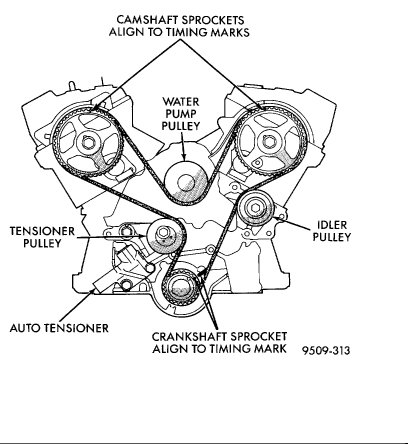

Install timing belt on right camshaft sprocket. Install a binder clip on the belt and sprocket so the belt will not slip out of position. Keeping the belt taught, install belt under the water pump pulley and then around the left camshaft sprocket. Install an additional binder clip on the left sprocket and belt.
Adjusting Crankshaft Sprocket For Timing Belt
Rotate the crankshaft to TDC. Continue routing the belt around the idler pulley, crankshaft sprocket, and tensioner pulley.

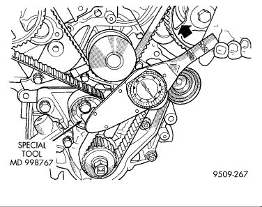

To tension belt perform the following:
Apply rotating force to the crankshaft sprocket in the clockwise direction, check that all timing marks are aligned.
Timing Belt Tension Adjustment
Using Special Tool MD 998767 and a torque wrench on the tensioner pulley. Apply 4.4 Nm (38.9 inch lbs.) of torque to tensioner. Tighten tensioner pulley bolt to 48 Nm (35 ft. lbs.) .
With torque being applied to the tensioner pulley install the tensioner to the tensioner pulley bracket and tighten fasteners to 23 Nm (205 inch lbs.) .
Pull tensioner plunger pin.
Rotate crankshaft 2 revolutions in a clockwise direction ONLY and check the alignment of the timing marks. Install tensioner pin into assembly. The pin should slide in and out without any resistance. If the pin does not slide freely, perform the procedure again.
