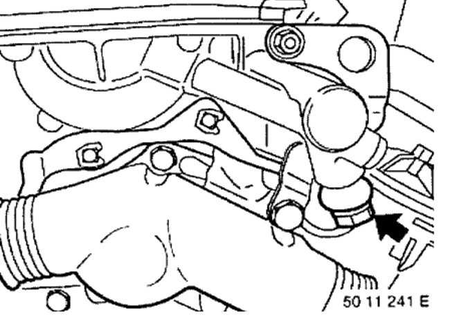

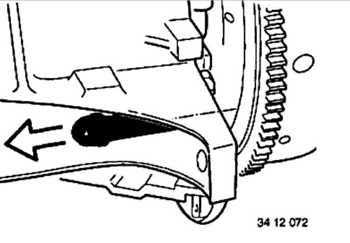

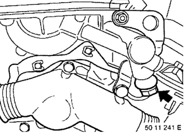

If it only moves a bit then stops check that you have the crank on TDC for compression on cylinder one. Are you using the cam holding tools?
Jun 28, 2017 at 9:15 AM

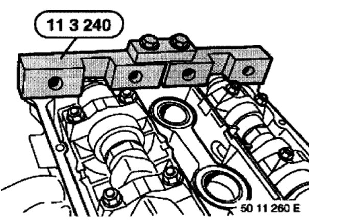

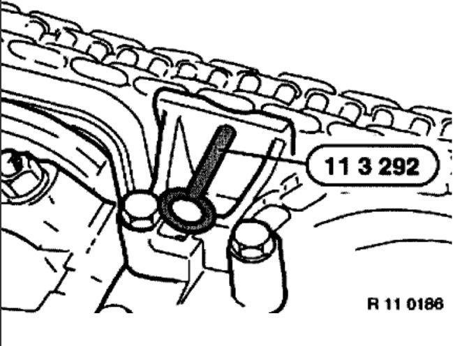

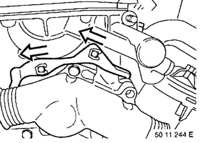

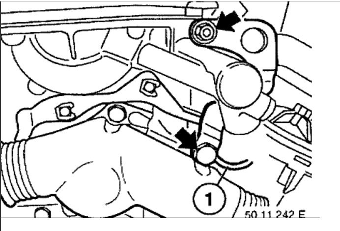

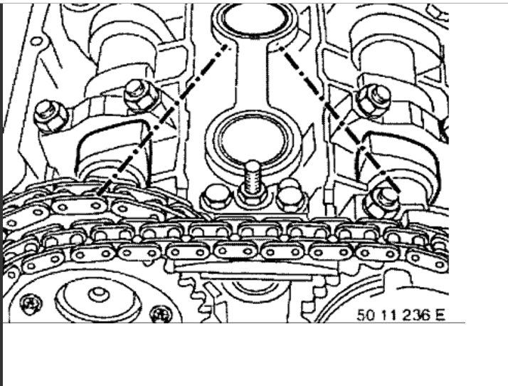

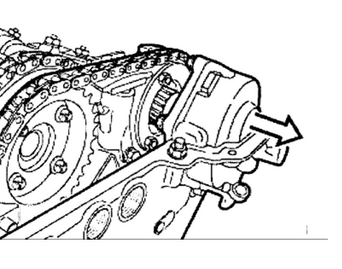

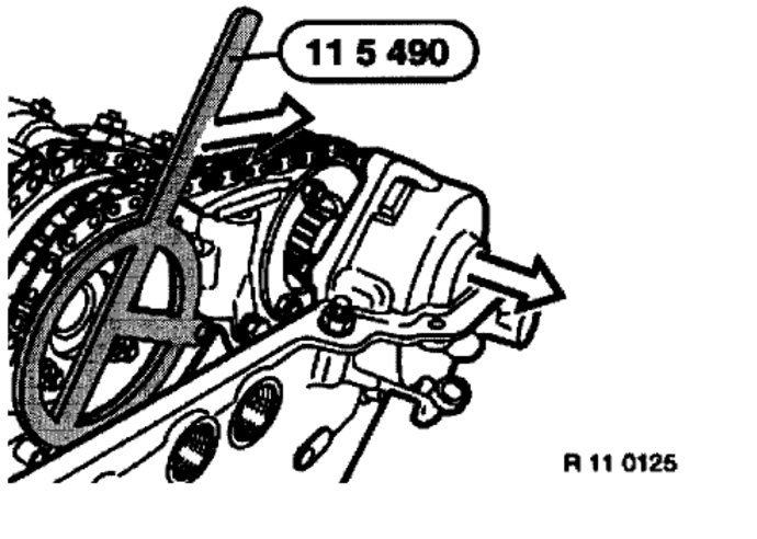

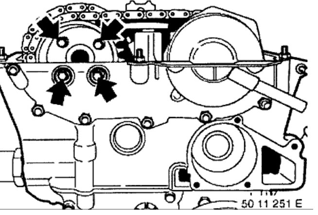

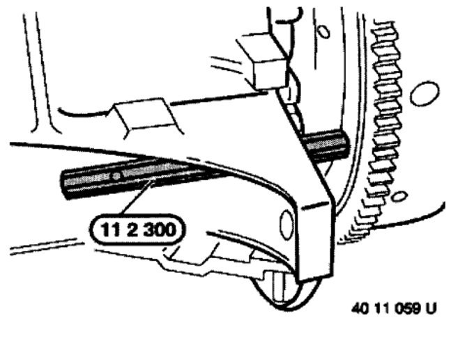

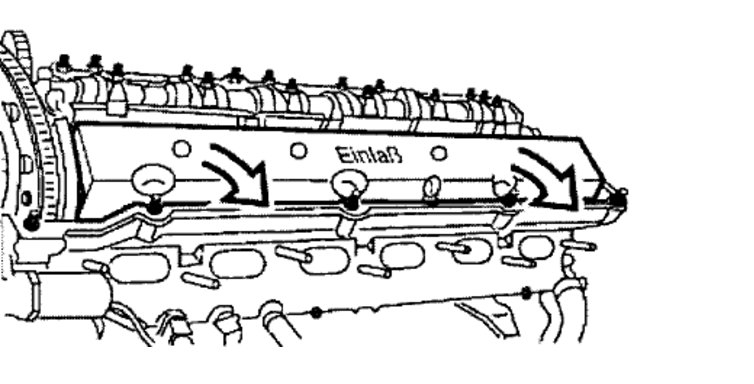

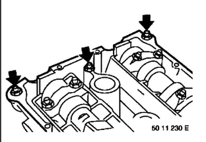

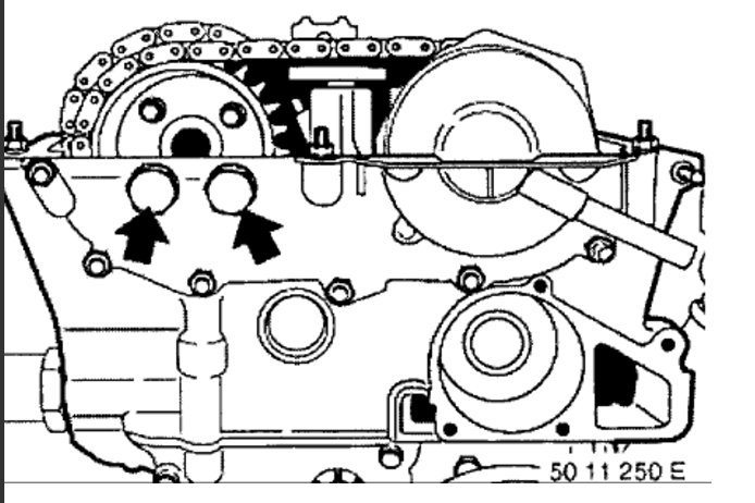

You must have the tool kit to do this job, Here are some diagrams (below) that shows you how to install the pin and rear cam blocks. Just make sure the Vanos are bottomed out all the way by loosening the main cam bolt.
