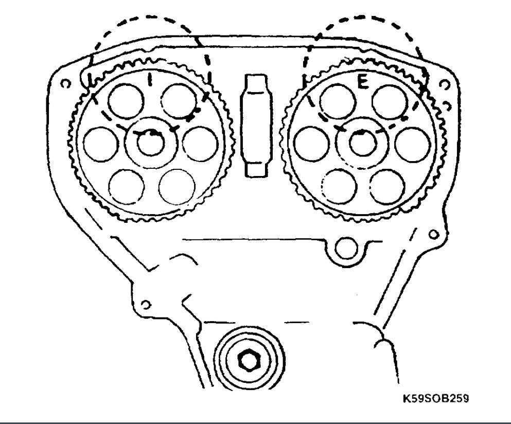

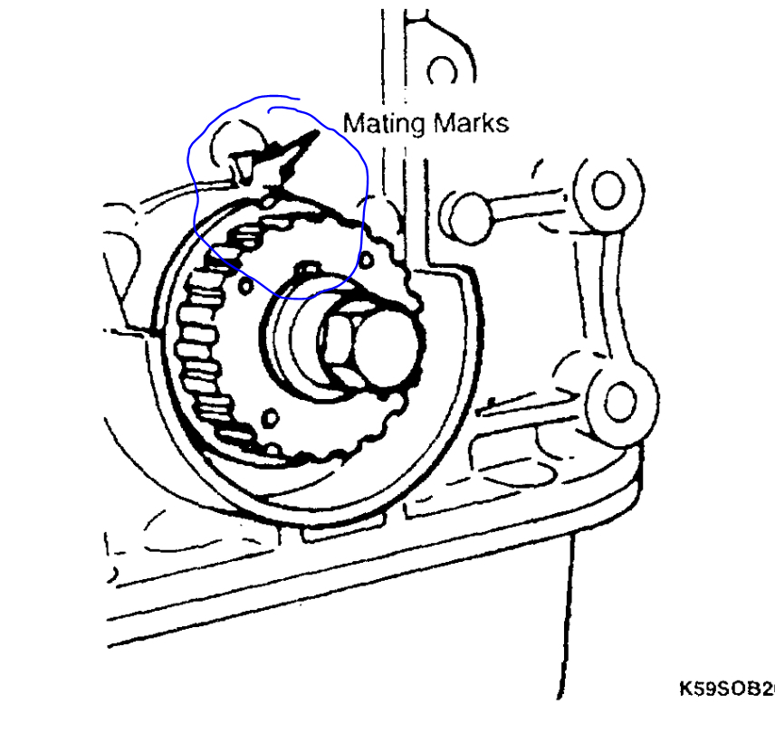

Good afternoon,
I attached the procedure for the timing belt and the marks that need to be aligned.
If your belt moved, once you install the belt, you will have to do a compression test to be sure there are no damaged valves as this is an interference motor.
https://www.2carpros.com/articles/how-a-timing-belt-works
The marks are attached below that have to match up.
