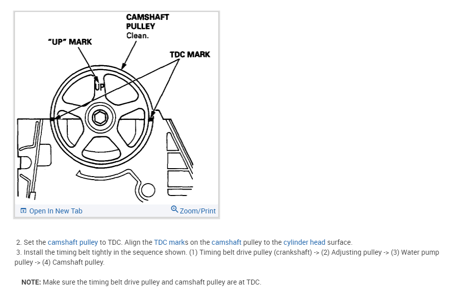

I did a head gasket repair, got a new timing belt and water pump I got the crankshaft ahead of the camshaft by two or three teeth, should I be worried ? I did crank it a bit before I caught my mistake, I'm sure its an interference engine , is two or three teeth to much and should I be looking to replacing valves.
