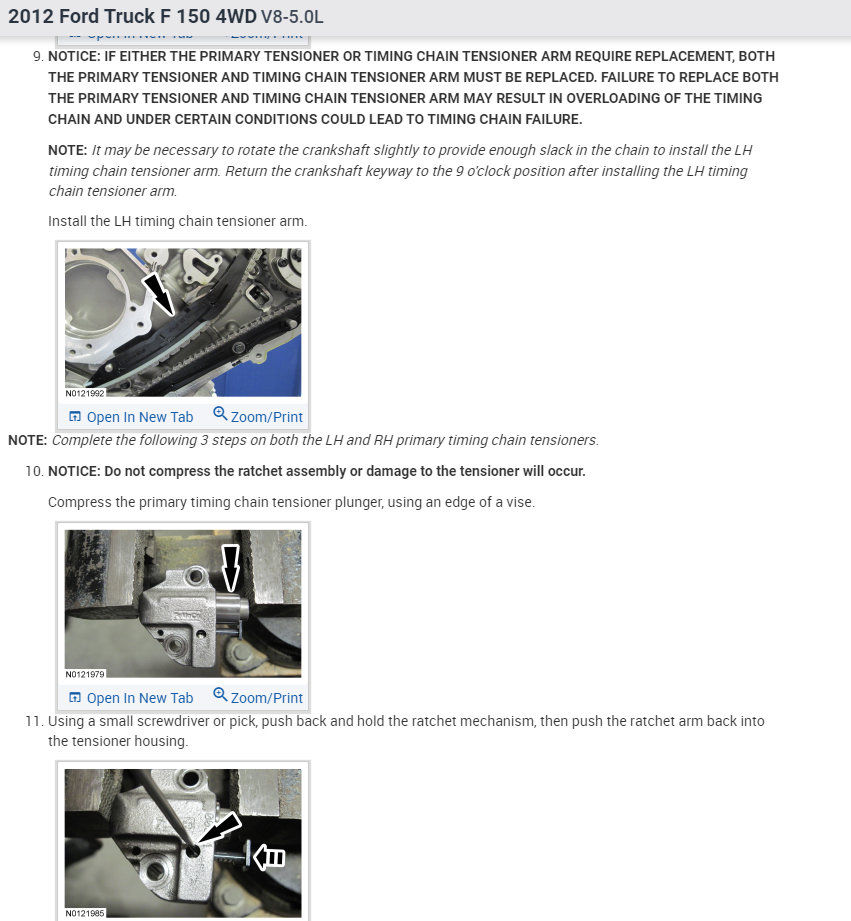

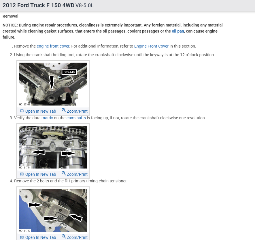

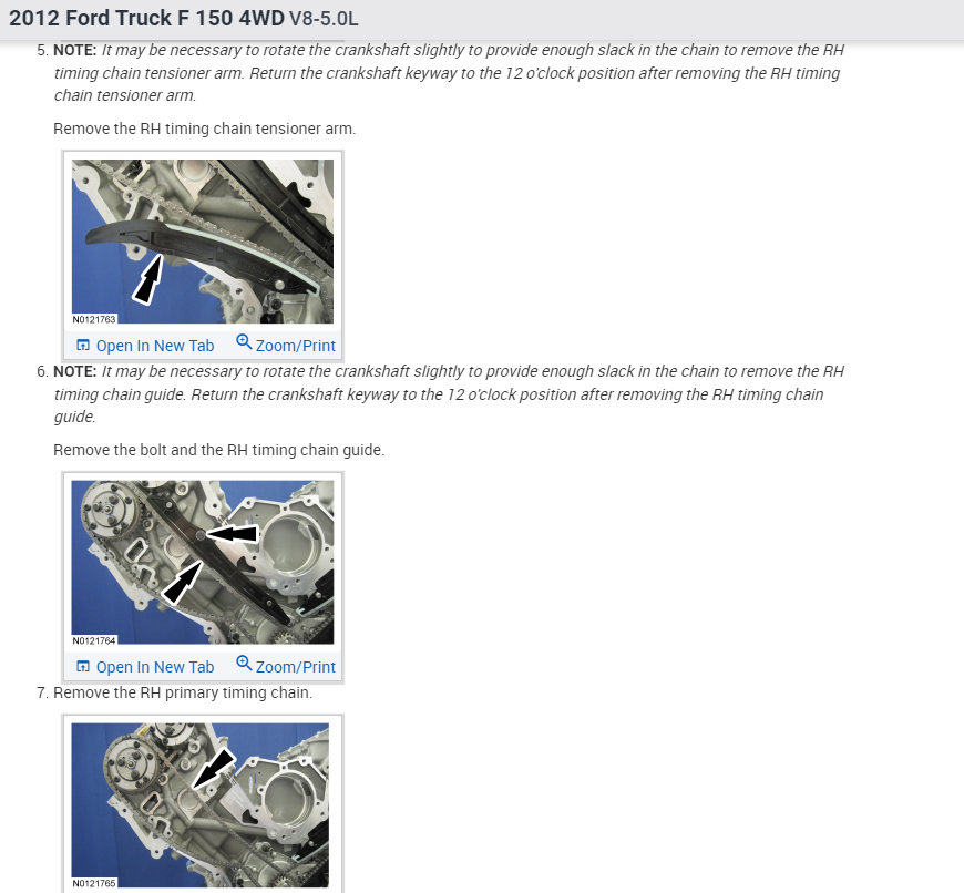

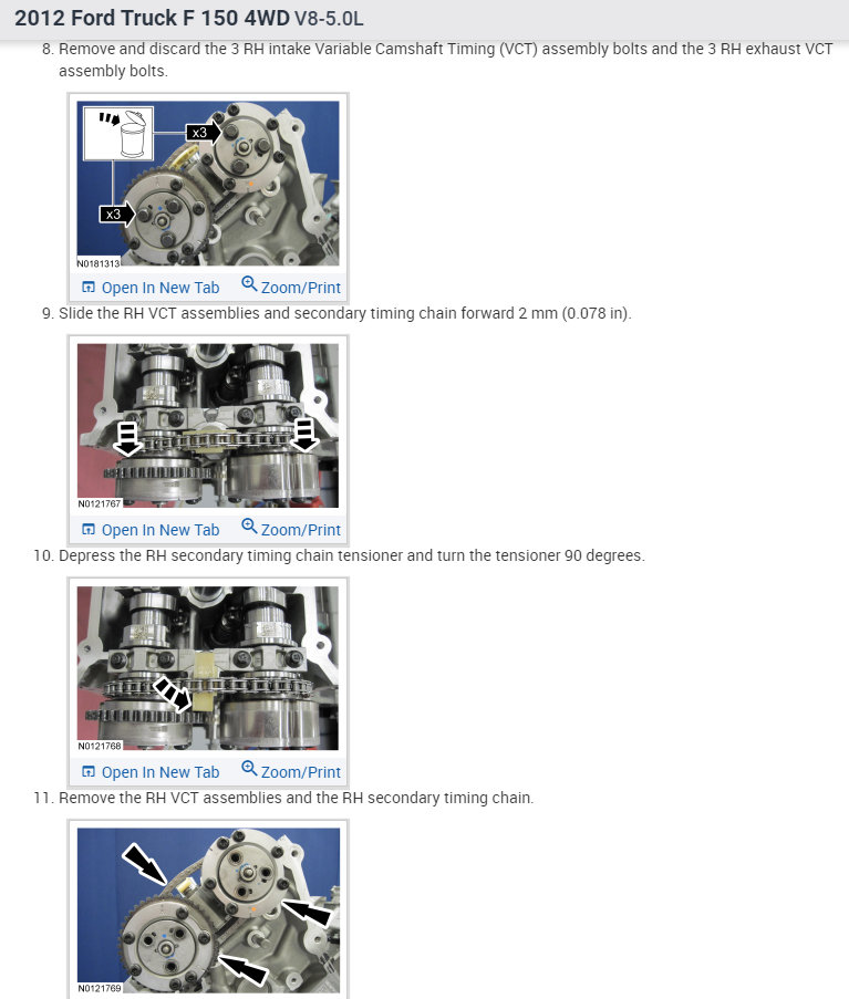

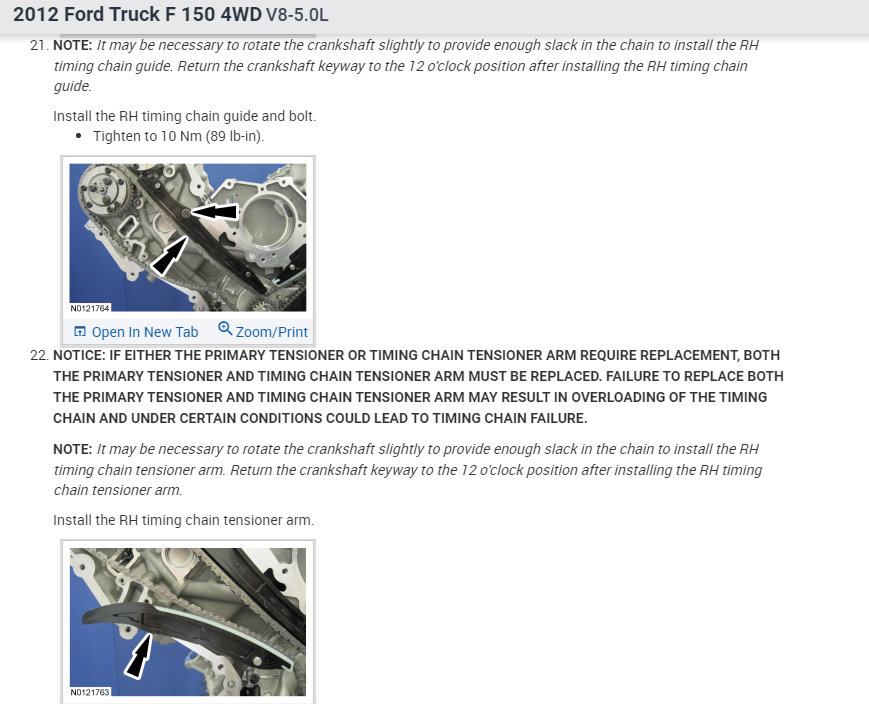

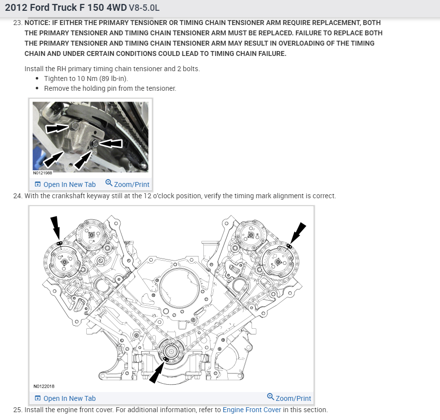

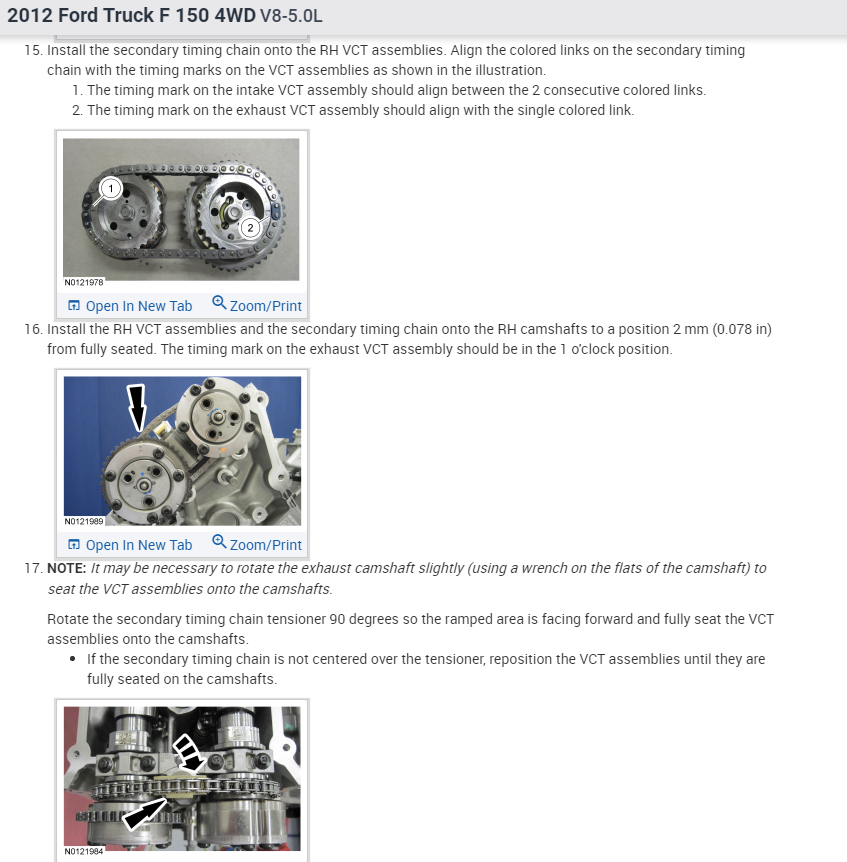

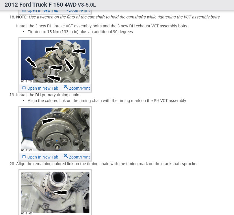

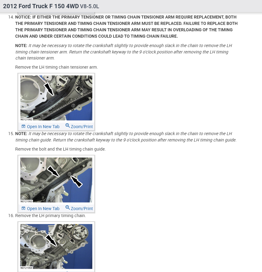

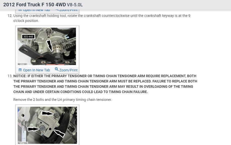

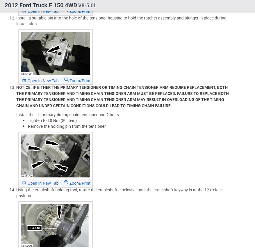

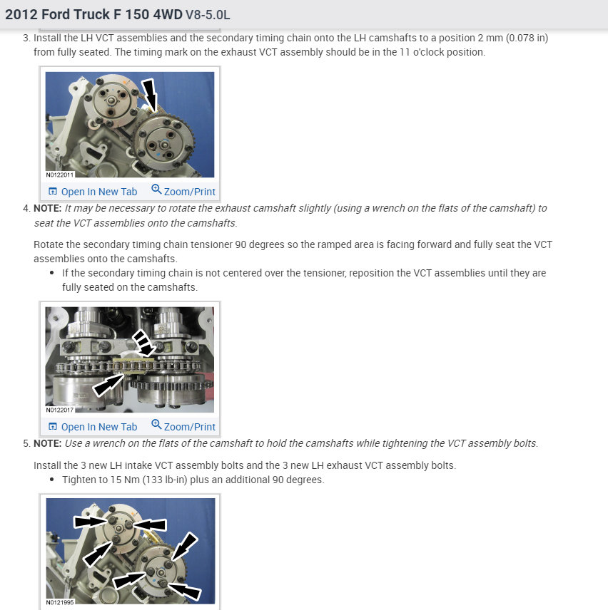

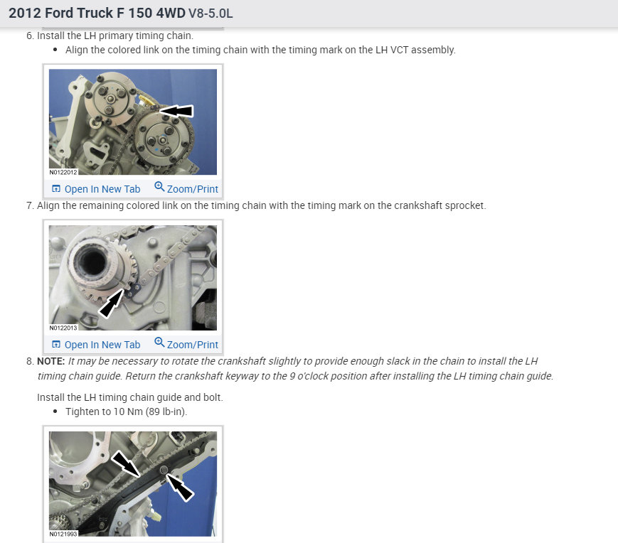

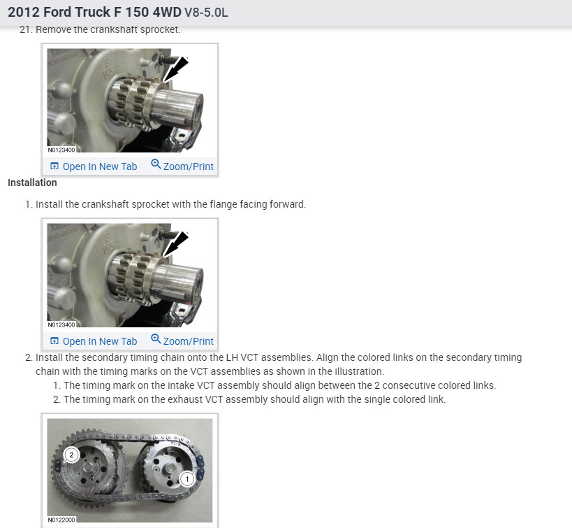

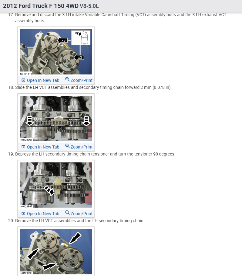

There are a few steps that need to be completed in order to get the timing mark properly.
I have attached the complete timing chain procedure including all the marks and steps below. That way you can get the information you need.
Let me know of any questions.
