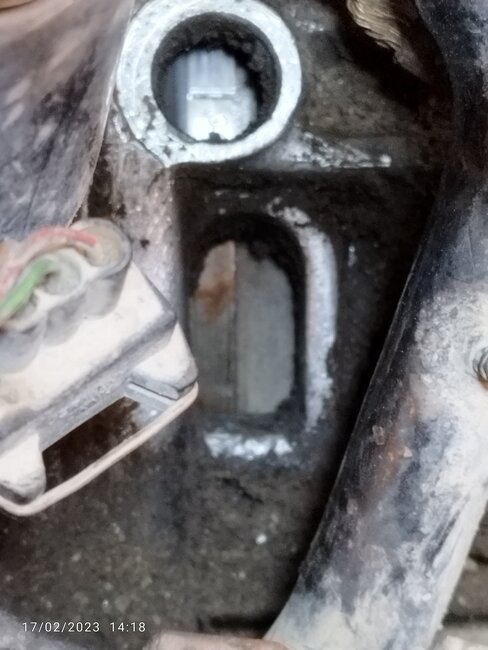

What is the shape of the flywheel TDC mark timing center?

flywheel TDC mark timing center.

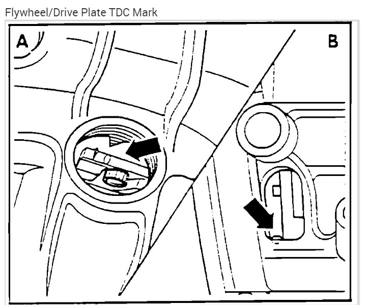

You got it. I attached a pic below that confirms what you have already found.

See pic below.

Thank you very much I had advanced engine noises. The problem has been resolved thanks to your help. The attached picture was helpful in solving the problem.
