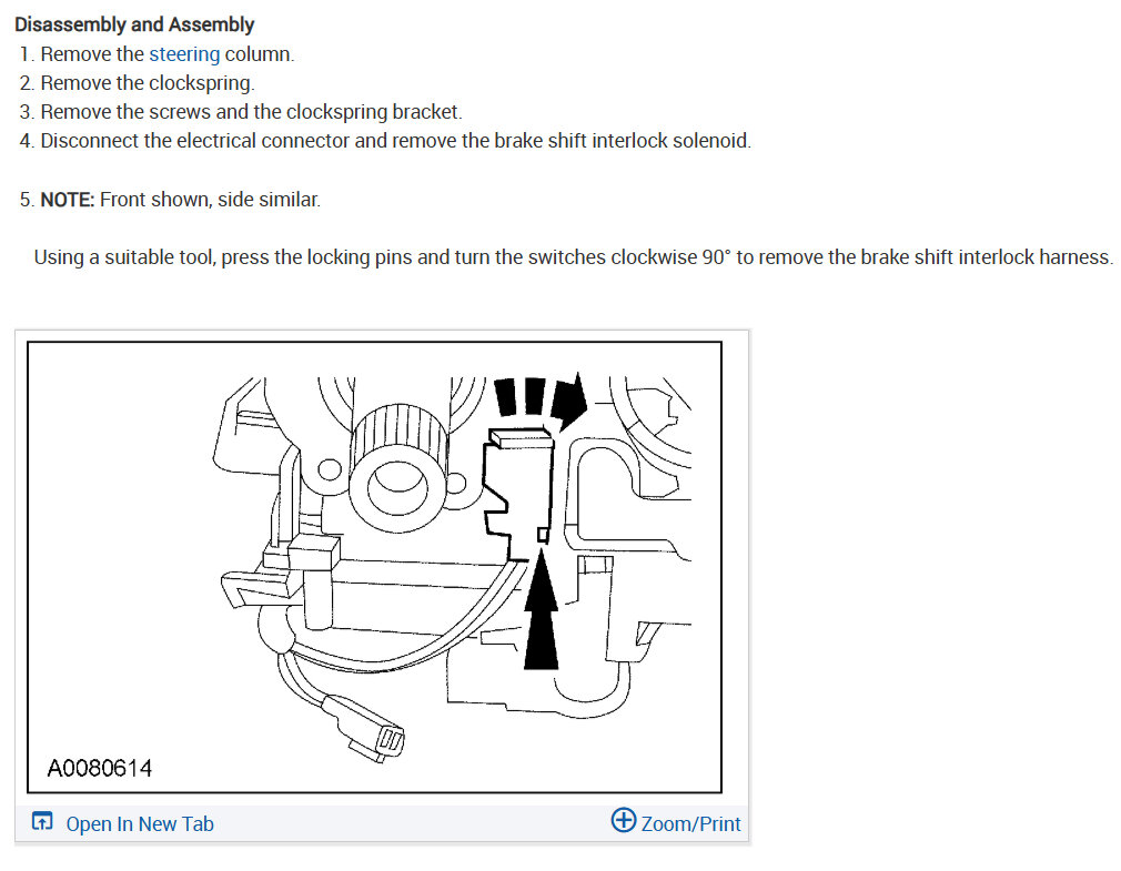

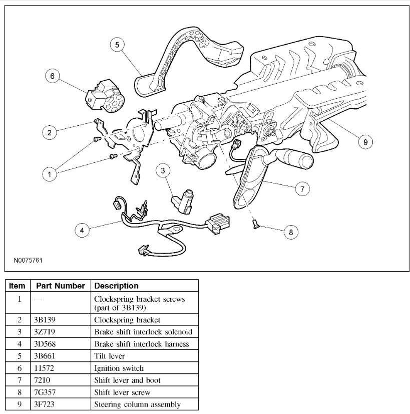

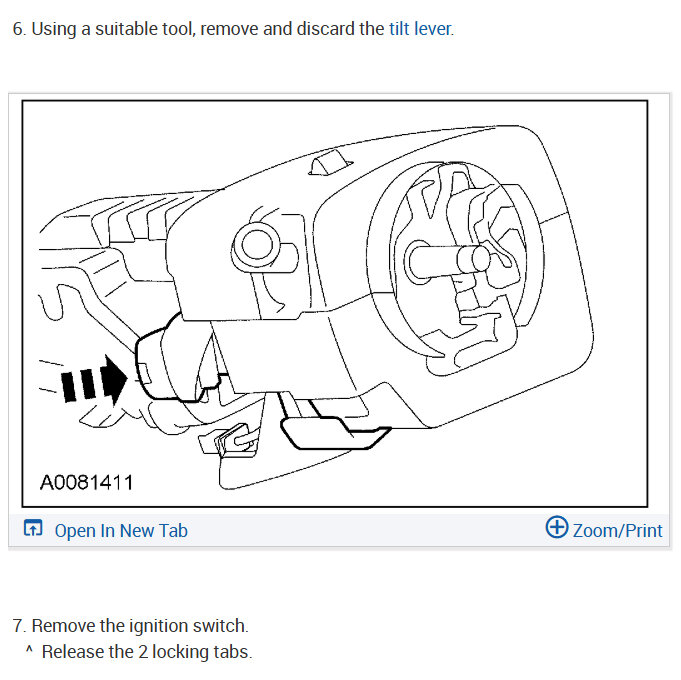

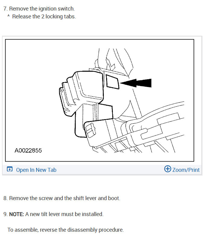

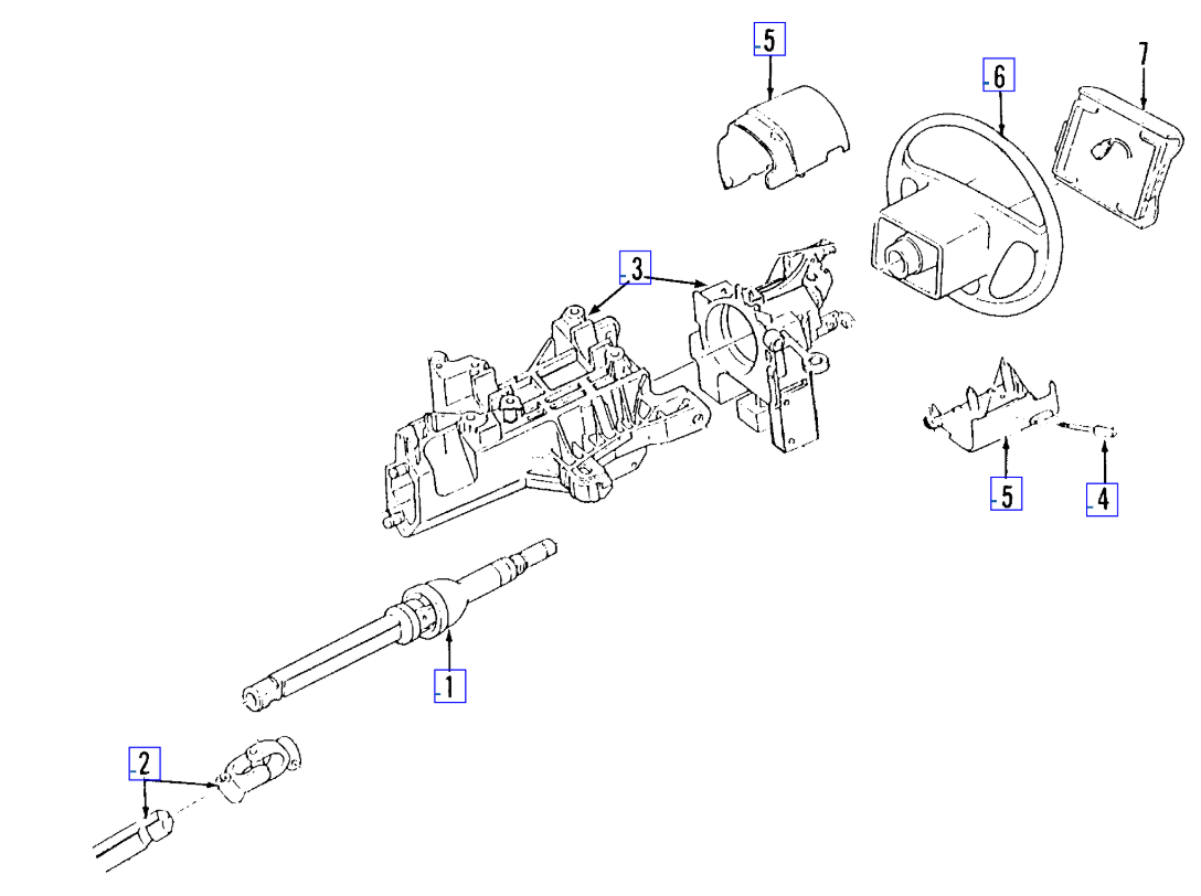

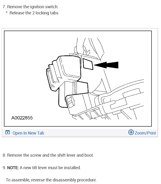

To fix this problem the column will need to be disassembled, so replacement might be an option. Here is how to disassemble the column so you can see what is damaged, you will need to go to the dealer for replacement parts. Check out the images (below). Please upload pictures or videos in your response of any problems so we can see what to help you with.
