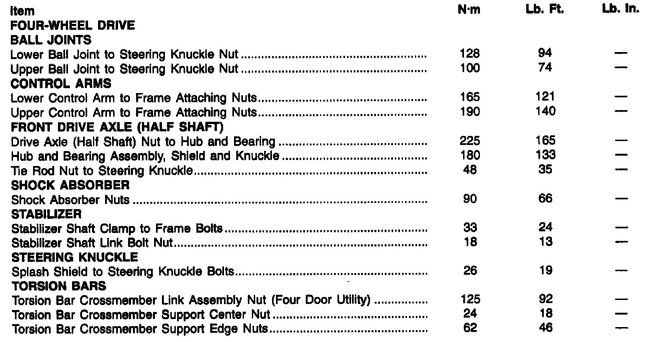

Ooh. Watch out for the large axle nut. That has to be tightened to specs before you set the truck down and put its weight on the wheel bearing. Failure to have that nut tight will make the bearing noisy. It will buzz like an airplane engine. The spec. for that nut is 165 foot-pounds which is lower than for most little front-wheel-drive cars. A lot of people mistakenly install the wheel and tire, then set it down so the tire will hold the axle from spinning while they tighten that nut. By that time it's too late. Instead, just stick a punch or screwdriver into a cooling slot of the rotor, then tighten the nut.
