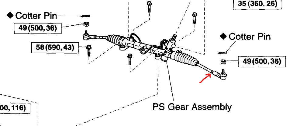

I tried to remove the tie rod jam nut with no success. I cleaned the treads with wire brush . put some lubricant on the threads no success . any suggestions?

Heat is your friend, I would use a torch to heat up the nut, this will loosen the rust and expand the nut which will help loosen it. Check out the images (below). Please upload pictures or videos in your response of any problems so we can see what to help you with.
