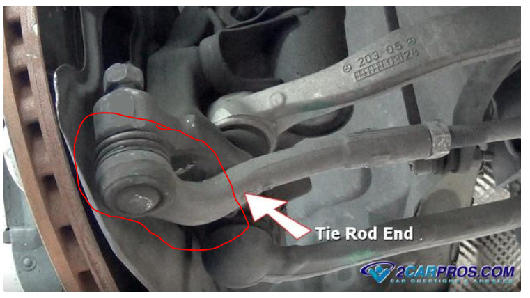

As far as the tie rod, lift one front wheel off the ground at a time. Place your hands at 3 and 9 o'clock and wiggle the wheel. Does it seem loose, or do you notice it moves before the other wheel does?
If you look at the pic below, I circled where to check for movement.
See pic below.
