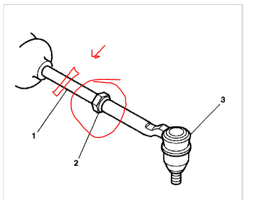

I have a pic below with an arrow pointing to what I believe is turning for you. If that is correct, you need to hold the inner tie rod (part that is turning) with a good pair of channel locks or even a pipe wrench.
Keep in mind, it is necessary to make sure the new tie rod is in the same position as the old one. In other words, it needs to be the same length when it connects to the steering knuckle. If you have turned it too far or too little, the alignment will be off and require having the tow in adjusted.
See pic below.

If you're referring to the tapered stud, use a large channel lock pliers to squeeze the socket to the steering arm. That will put pressure on the ball and socket to stop the ball / stud from spinning. It shouldn't take more pressure than you can squeeze with one hand. If that doesn't work, either there's excessive wear in the joint and it must be replaced, or the threads are damaged or rusty. For that, use a die from a tap and die set to clean up the threads.
Some tapered studs have a small hex at the end of the stud to hold it with a wrench while you tighten the nut with another wrench. That's the painfully slow way to do it. If there's no hex, you can hold the top of the stud with a vice-grip pliers.
Let me know if either of those methods works for you.

There is no hex in the stud, I looked.
I will try the method with the channel locks tomorrow. I hope this doth work.
Thank you for the tip.
I would not like to have successfully gotten the ball joint replaced just to have this stop me. Ha, ha.

I cleaned the threads out a bit and held the tie rod with a pipe wrench. I was able to get it tightened-up.
Thank you.
