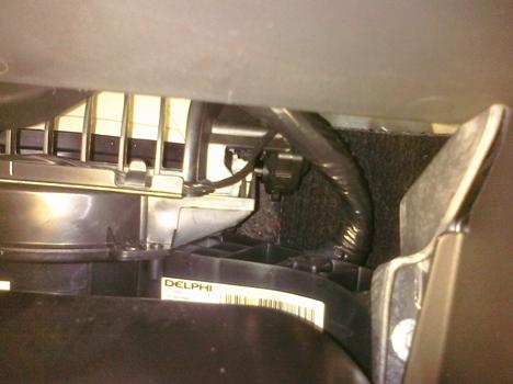

There is a actuator behind the glove compartment. This is probably what is causing the clicking. You can open the glove compartment, then pull it down and to the right where be a black box with a sticker. See if that is where the noise is coming from. If so you will have to remove the HVAC motor and then replace the actuator.
