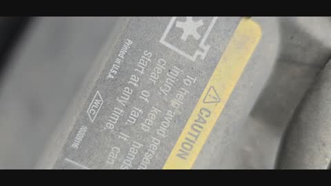

Here's the video it took a good 20 minutes or so of driving for it to start making the noise again.
Jul 30, 2025 at 3:08 PM
Yep, that is a bummer, the camshaft and lifters will need be replaced, sorry, this is such a problem they make a OBD2 port dongle to stop the cylinder deactivation to stop this issue, thanks for the video though it helps. I would stop driving the car, you are putting metal throughout the engine.
Jul 30, 2025 at 5:10 PM
