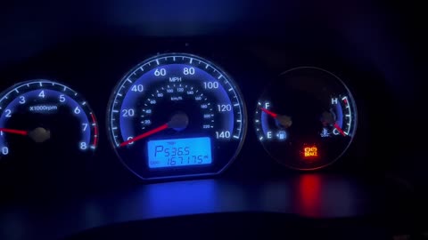

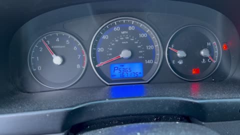

I was driving up a small interstate incline, passing another vehicle at about 75 MPH when I lost acceleration. Pressing the gas, the car just revved but wouldn't go faster. Moved to far right and still couldn't accelerate; the car started make the noise in the attached video. I let the car coast along the shoulder until it just sputtered out (didn't make it to the exit). The steering wheel locked, and the car would not restart. Towed it home and slow charged the battery. It turns on again, with noise, but I haven't tried to move it. Someone suggested adding Seafoam treatment to the gas tank. What do you think the noise is and what should I do next? thanks
Video: https://share.icloud.com/photos/07eLaCkBsaM0LdT-1KroMZ1Mw
Nov 27, 2022 at 4:49 PM

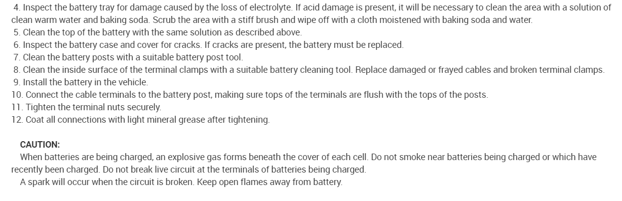

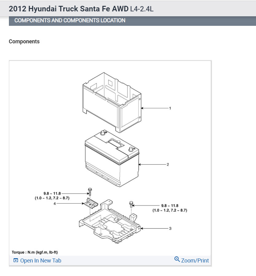

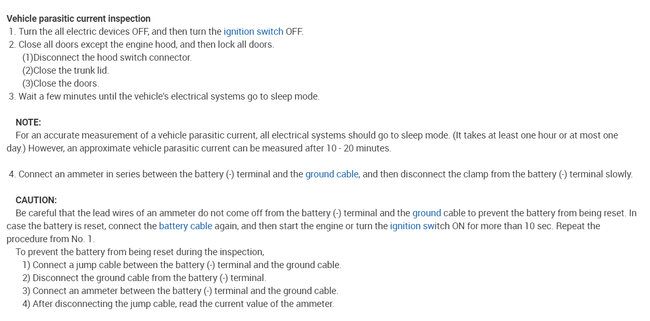

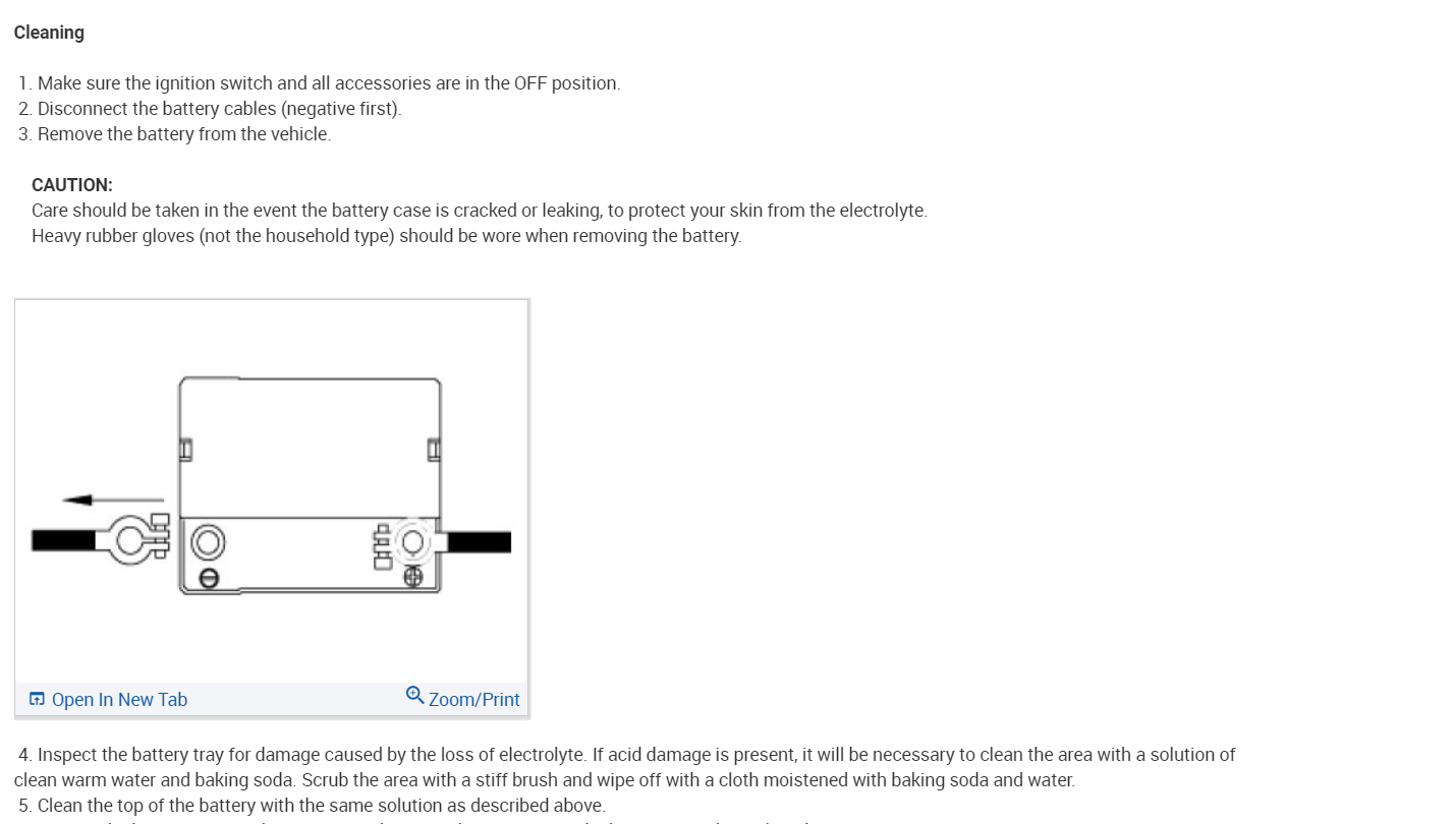

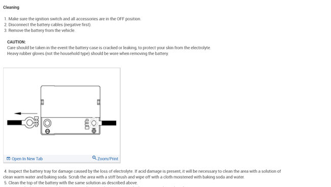

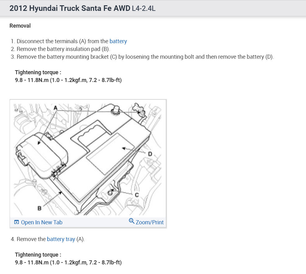

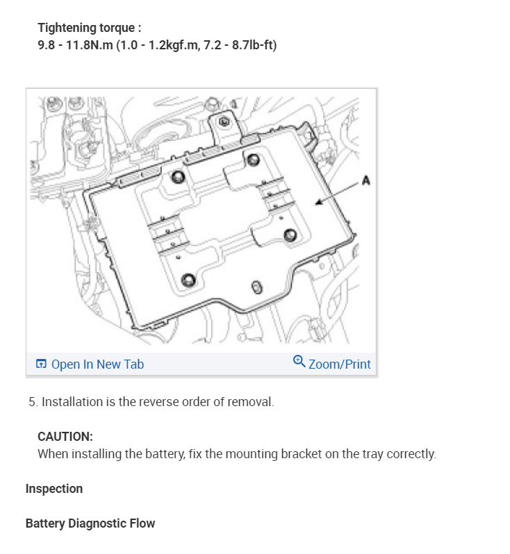

It sounds like the battery has shorted out, even though you have charged it up there could still be the problem. Also, can you please upload the video with your response? I can't download anything to this computer. I would turn the headlights on for 10 minutes and then try to crank the engine over. If the engine doesn't crank, I would replace the battery. Here is a guide to help us and I have included how to change the battery out in the images below:
Did you have any warning lights on before the problem? If the battery is okay let's run the codes to see what comes up.
Check out the images (below). Let us know what happens and please upload pictures or videos of the problem.

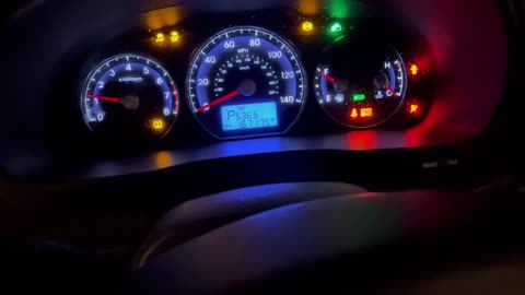

I was able to get the videos to upload directly from my phone. The 12 sec one was taken four days after the initial failure. It sounds quieter than it did on day two in the 29 sec video.

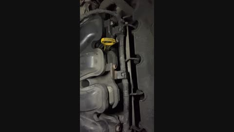

Attached is a minute and a half video of under the hood while the car is running.
The car sat for three days under a mound of snow. I turned it on and about a minute or two later it shut off. Tried it again and it turned on but died right away.
So, I connected the slow charger and without waiting, turned it on again and it started right away. I then took this video.
I let the car continue to run another 15 minutes or so and the noise continued.
I seem to hear the noise mostly on my left while looking at the engine. You can tell that a little from the video as I move around.
Could this all be an alternator issue?
To recap from earlier, I had an oil change about three days before this noise started. The oil is still full (actually a little over the full line). After the oil change, I had only driven it less than 10 miles before the day it failed. The day it failed I drove it for about 60 miles on the highway when the noise started, and the car stalled out and wouldn’t restart.
So, I can’t help but wonder if the rapid oil change outlet made some mistake. Did they not reconnect the filter properly or something? Is oil maybe not getting to the engine? The oil change was right before Thanksgiving, and they were really crowded, and they had me in and out in less time than usual. I remember commenting on that at the time (I was out in about 15 minutes, including paying, vs about 20-25 usual time).
I wiped the oil on a cloth, and I thought maybe it didn’t look as clean as it should have for a recent change. But it wasn’t that dirty either.
As the earlier video I uploaded the other day shows, there are no concerning lights that are on while the engine is running.
Also, I did not try stepping on the gas this last time. But earlier in the week, the car did move when I drove it up and down my driveway.

Thanks for the video. That does not sound good, I hear the valve trains noise then it stops and is replaced by a deep engine noise, even though it is running smoothly. I am going to ask other experts if they have heard this noise before. Also, I would try replacing the oil with quality engine oil that is the correct weight for the engine and also change the filter.

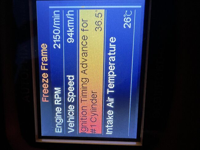

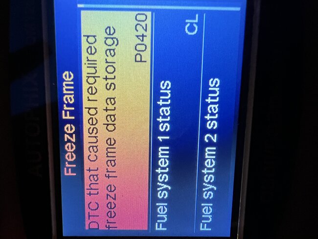

I couldn’t get anyone to come out today to change my oil at home. Is it safe to drive 2 to 3 miles to my nearest service place that can do it?

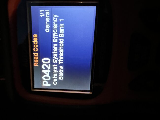

I did get a delivery from Amazon for a diagnostic code reader. Three images attached. P0420 is the only error code about the catalytic converter. But I would doubt the cat is causing the issue.

I listened to the video, and it certainly is different. At first, the noise is valve train related. The deep sound is odd. It seems almost too slow to be anything in the engine, but at this point, anything is possible. Does the deep sound (sounds like a heartbeat) speed up with engine speed?

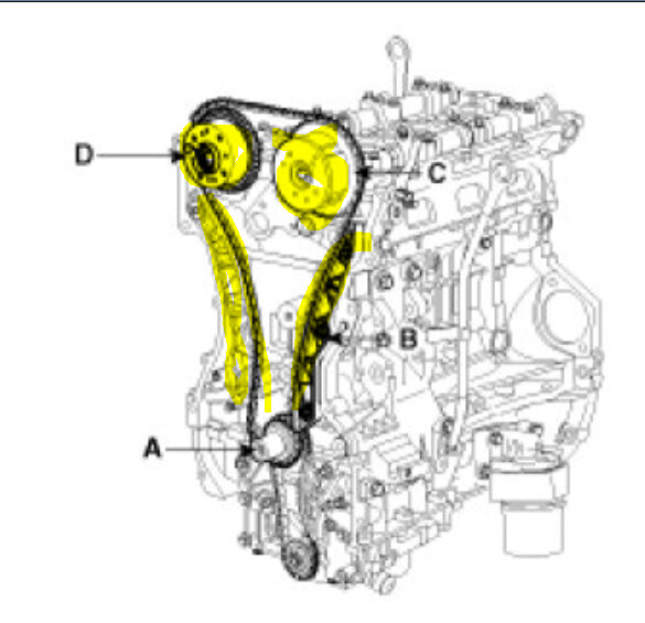

Also, I want you to remove the serpentine belt and see if that changes the sound. Only run it for a short time with the belt disconnected to see if the sound has gone. For some reason, it is sounding like a belt. Not one that is slipping, but rather like it is being plucked like a guitar string. LOL Also, if you have an automotive stethoscope, see if you can pinpoint where it seems to come from.
If there is no change with the belt, we need to remove the valve cover and timing chain covers to see if we have an issue with a chain tensioner, the chain, or one of the variable valve control sprockets or actuators. If this is the case, using a stethoscope, the noise will be loudest at the timing chain cover and the front of the engine valve cover. See pic below.
Let us know
See pic below.

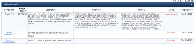

Good news Joe! I used the url below to Hyundai's recall site and contacted Hyundai. They are going to give me all three open recalls, which includes the rod bearing/ engine issue. I have attached the recall campaigns that populated at this url per my VIN:
https://autoservice.hyundaiusa.com/campaignHome
They scheduled my appointment with a local dealer for Dec. 16. I asked twice if I am completely covered given, I am beyond my warranty and given the number of miles on the car and she confirmed, no charge because it's not my fault. I never went into any detail about any issues I have seen.

As an update, I just heard today from the services department at the Hyundai dealer that they received final approval from the manufacturer and will begin the repair work on the engine. No charge to me (though they told me it is about $7,000 worth of work). Presumably OEM parts, which I hope would mean my engine would be like new vs like one that has 167,000 miles on it. Thanks again for this idea. I'll check back in once I receive the car back from them. They said it could still take a couple weeks.
Jan 4, 2023 at 6:08 PM
Thank you for the update. That is great news. Also, if you look at the section under remedy in the pic you attached above, you are getting a new engine plus several other things.

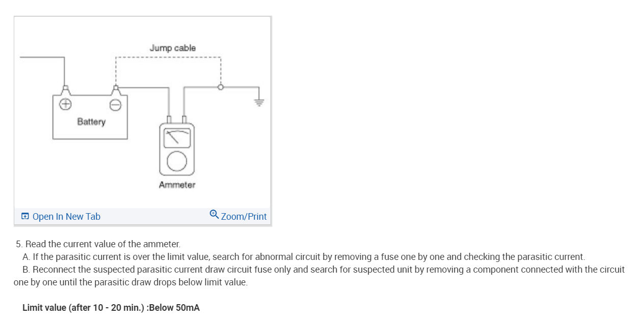

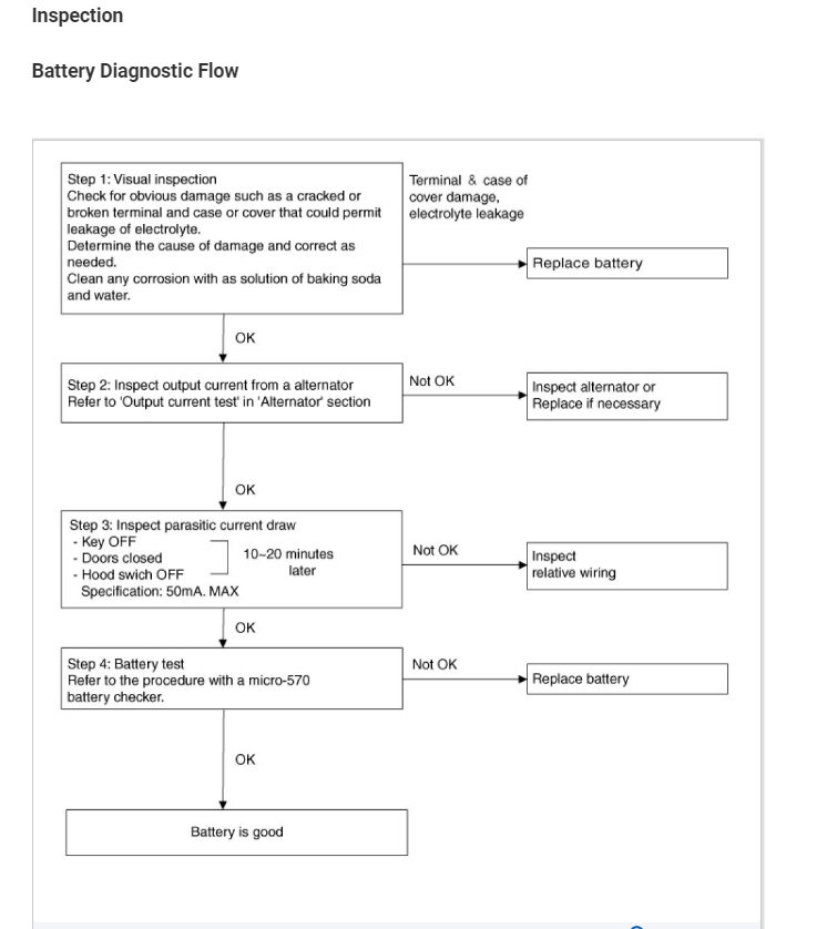

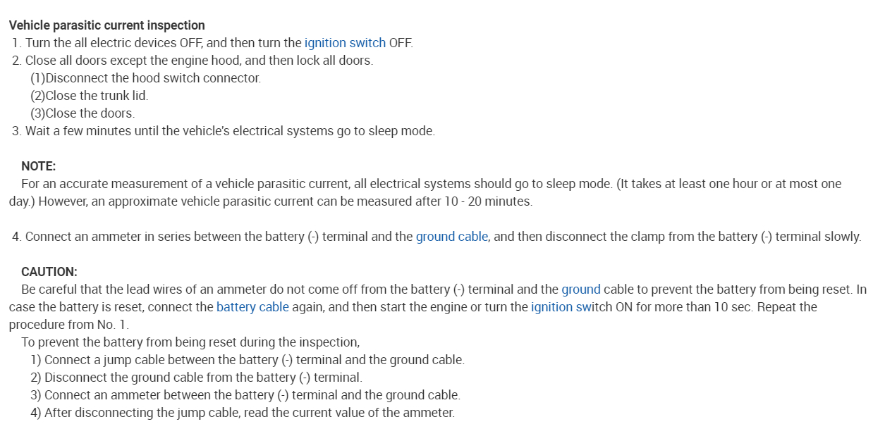

I spoke too soon. I got the car back on Saturday. It would not start on Sunday. I got it jumped and was told to let it run. So, I didn't turn it off as I ran errands. Went back home. Monday morning it wouldn't start. So, Monday evening I got AAA out to jump it (I have a 13-month-old AAA battery). They said maybe it is the starter, but let it run. I let it run for two hours. Tuesday morning it would not start. When I picked it up from the dealer repair shop on Saturday, they already had it on and running before I got there. My email to you is first. Next is my phone call to them. Sigh.
Jan 31, 2023 at 10:14 AM
When the work was done, they could have pinched a wire causing a draw on the battery at all times. Also, the battery itself may be bad, but I doubt that would have happened after the work was done, but anything is possible.
You indicated they had it running at the dealership when you got there. Did they provide any results or ideas?
Also, did you attach an email and other dealer info above? I ask because it didn't come through.
Jan 31, 2023 at 6:38 PM
