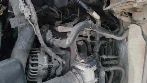

This is a video right after I started it about an hour after coming in from work.
Aug 6, 2024 at 6:38 PM

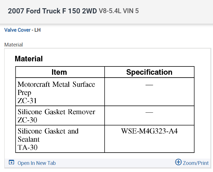

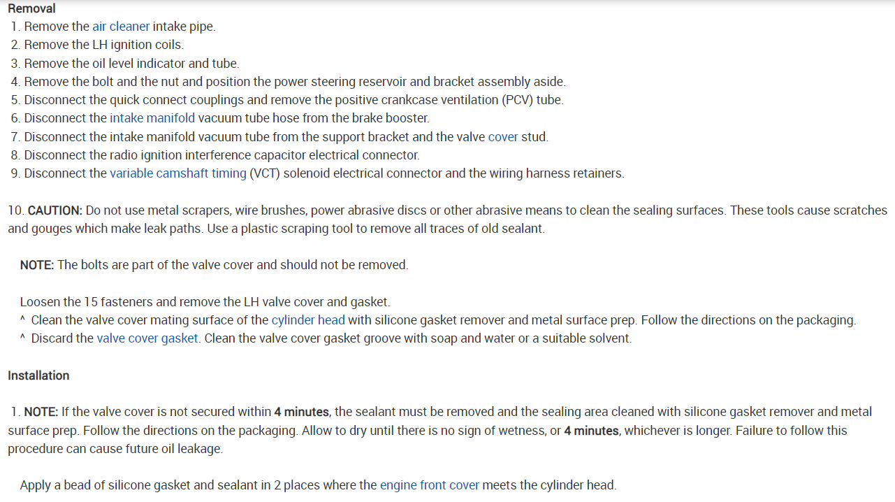

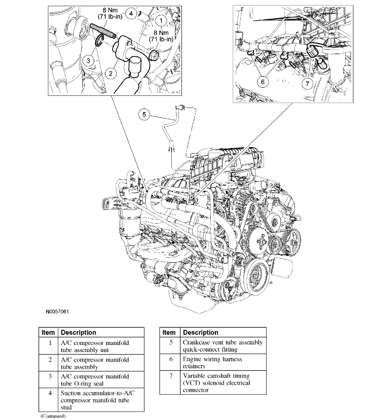

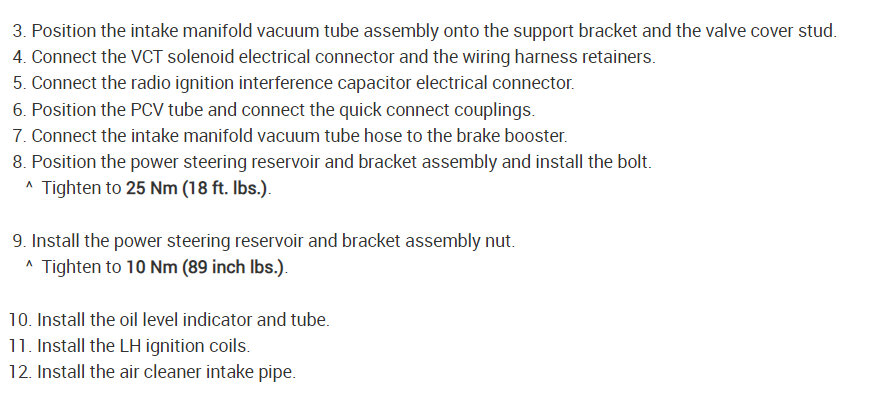

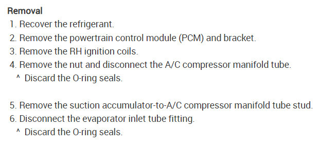

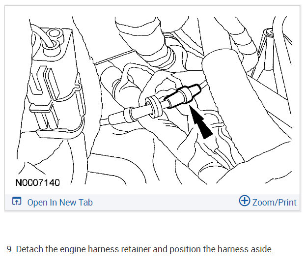

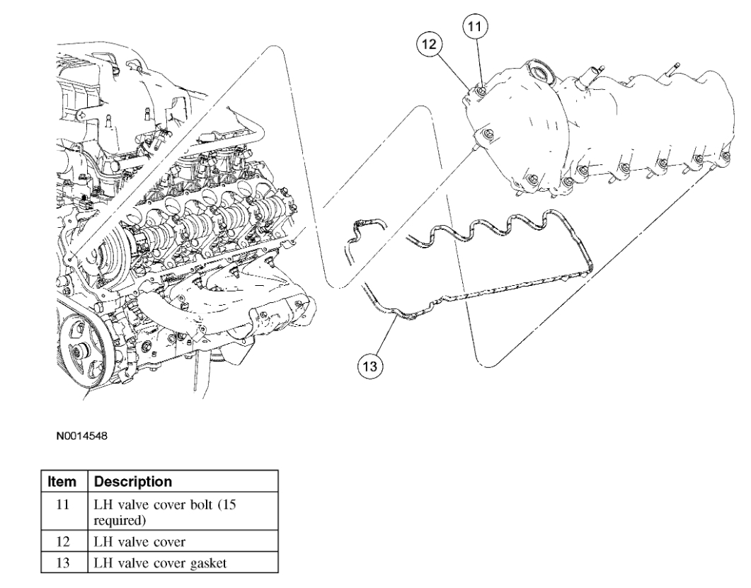

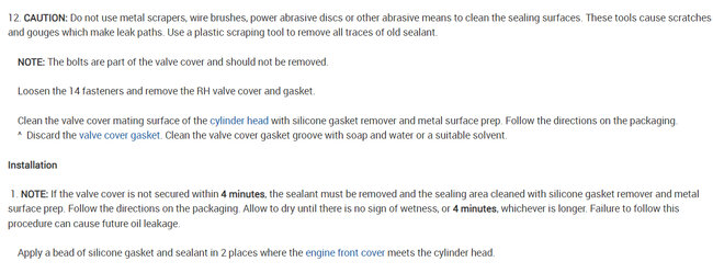

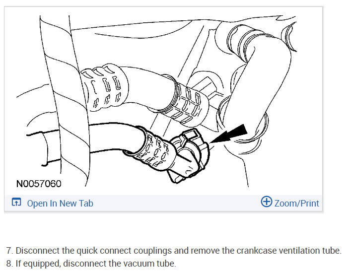

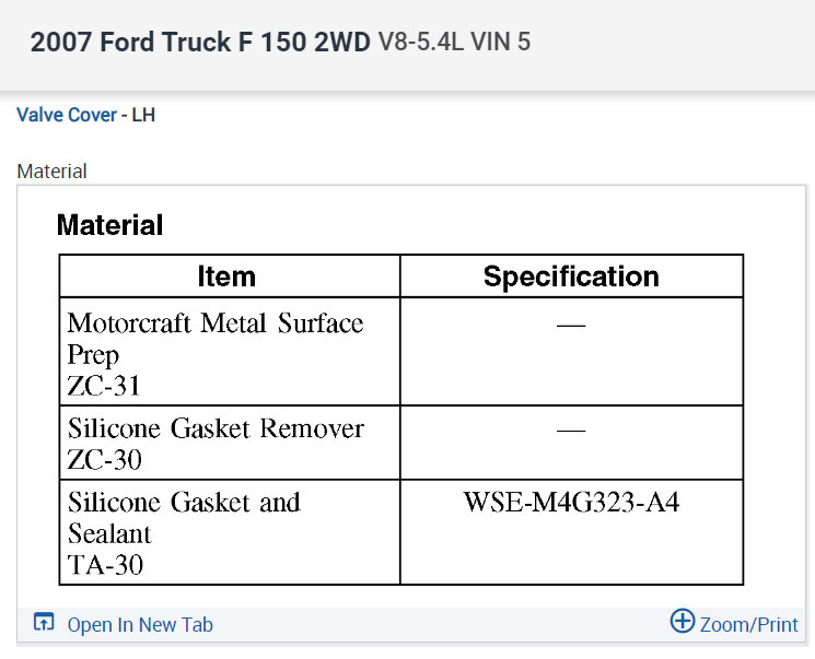

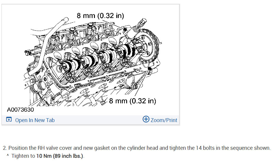

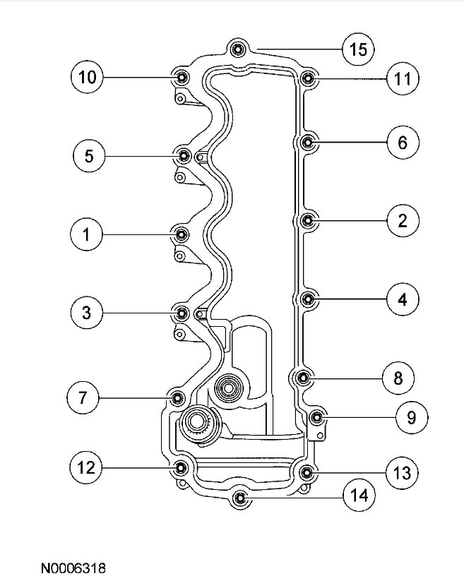

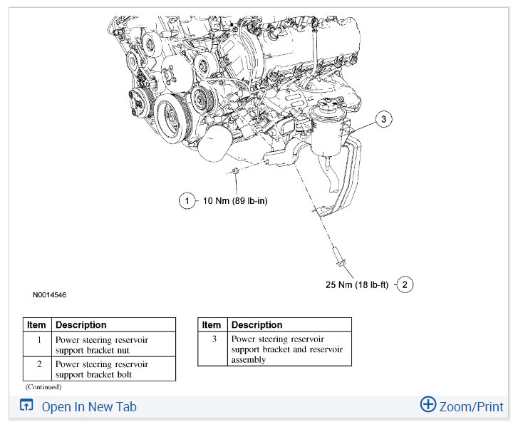

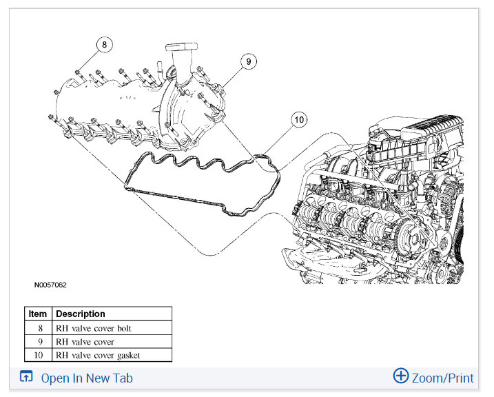

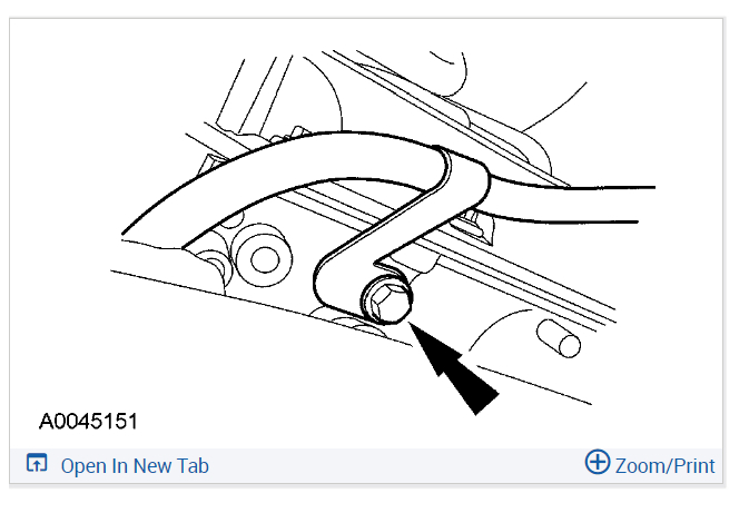

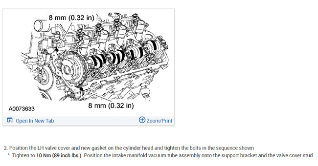

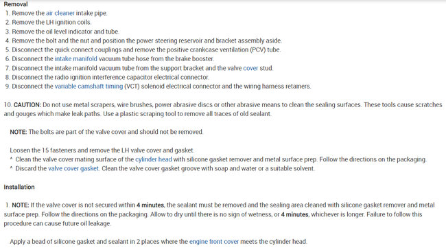

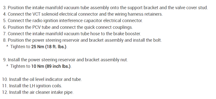

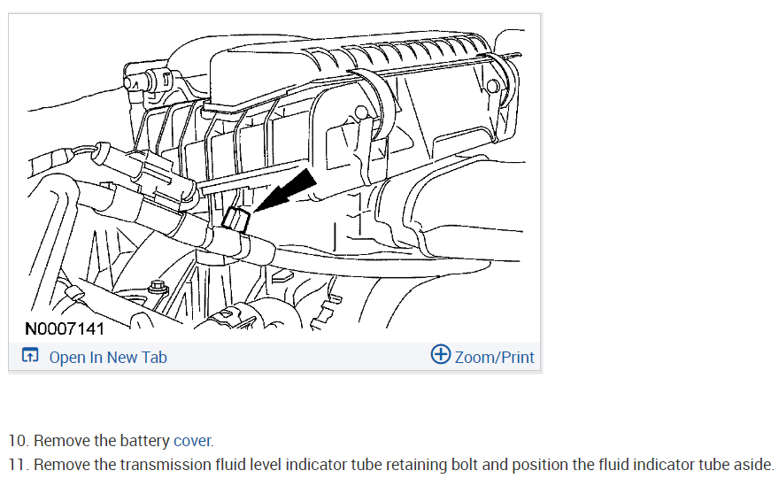

Thanks for the video. yep, that is a roller follower, I would remove the valve cover that is making the most noise for inspection. Use the video to help remove and replace the loose roller follower, also check the camshaft for damage which does not happen very often on these engines. Here is how the valve covers are removed. Check out the images (below). Please upload pictures or videos in your response of any problems so we can see what to help you with.
Aug 7, 2024 at 12:29 PM

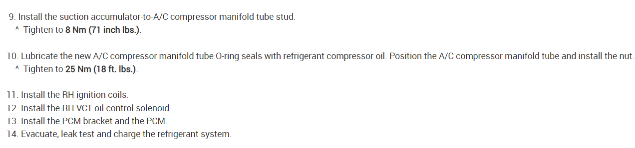

Do you have this same information for the passenger side valve cover?
Aug 10, 2024 at 2:20 AM

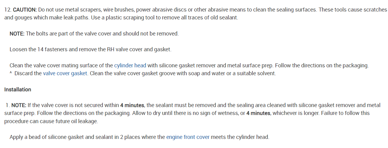

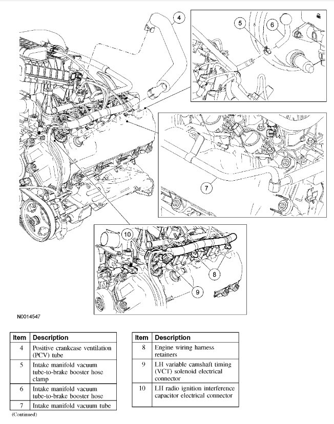

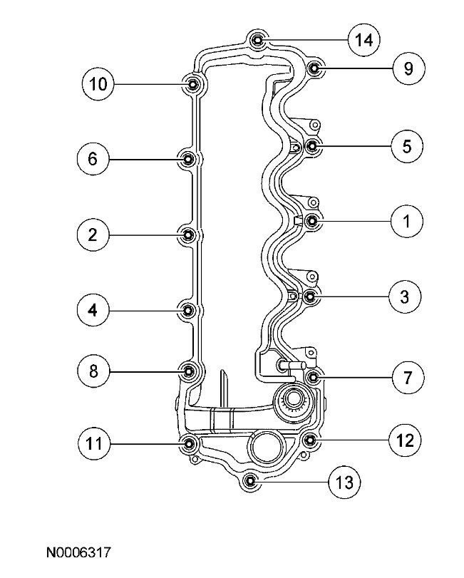

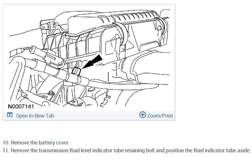

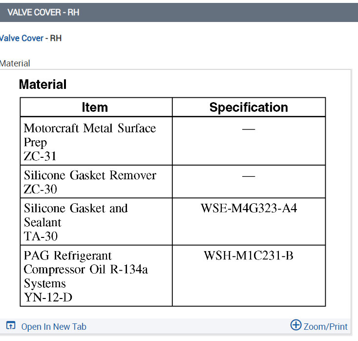

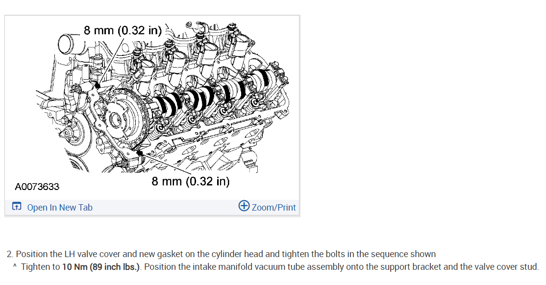

Sure, here you go the right side valve cover removal instructions. Check out the images (below). Please let us know what happens.
Aug 10, 2024 at 9:41 AM

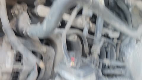

So my truck which until yesterday I thought was a Triton 5.4 liter v8. Is actually a Triton 4.6 liter v8. I didn't even know they made a 4.6 triton. Anyways so I had asked this question before and may have gotten bad advice due to me giving the wrong spec. So it tics louder at times but almost constantly. Sometimes it sounds Ike it's coming from the oil pan but only occasionally.ill add a video. This is first time I've started it today
Aug 15, 2024 at 10:12 AM (Merged)
Sorry if we headed in the wrong direction, it happens. Thanks for the video, it sounds like a roller follower has gone bad, the needle bearing fall out of the follower which makes this noise. Also, if you have a loose spark plug it can cause this noise as well so check those. Please watch the video in the above post to see what I am talking about.
