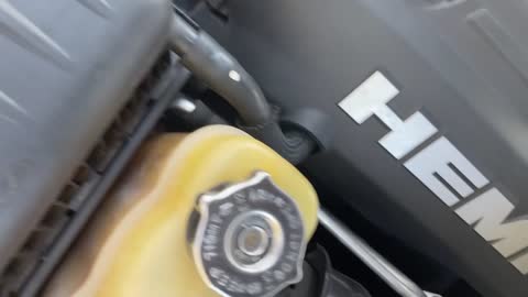

Can you please upload a video of the noise?
Oct 10, 2022 at 4:42 PM
BHAMDOC1973
  • 2,008 POSTS
I'll get you one tomorrow.
Oct 10, 2022 at 5:09 PM
BHAMDOC1973
  • 2,008 POSTS
These two when cold. I'll add another once she is warm. Thanks

Warm.
Oct 11, 2022 at 10:28 AM
Thanks for the videos. That is definitely valve train noise, I would remove the driver's side valve cover and look for loose valve train, remember to rotate the engine over so you can check all valve train components. Upload videos of the problem when you find it. It sounds like a roller rocker arm has fallen apart.

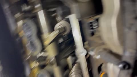

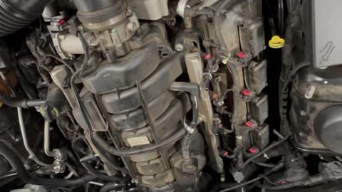

I removed the driver's side. There is play as you see in the video. Can you give instructions on replacing those? I did it before on a 2.7l motor, which comes as a whole set and it wasn't too bad.

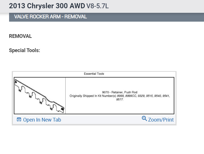

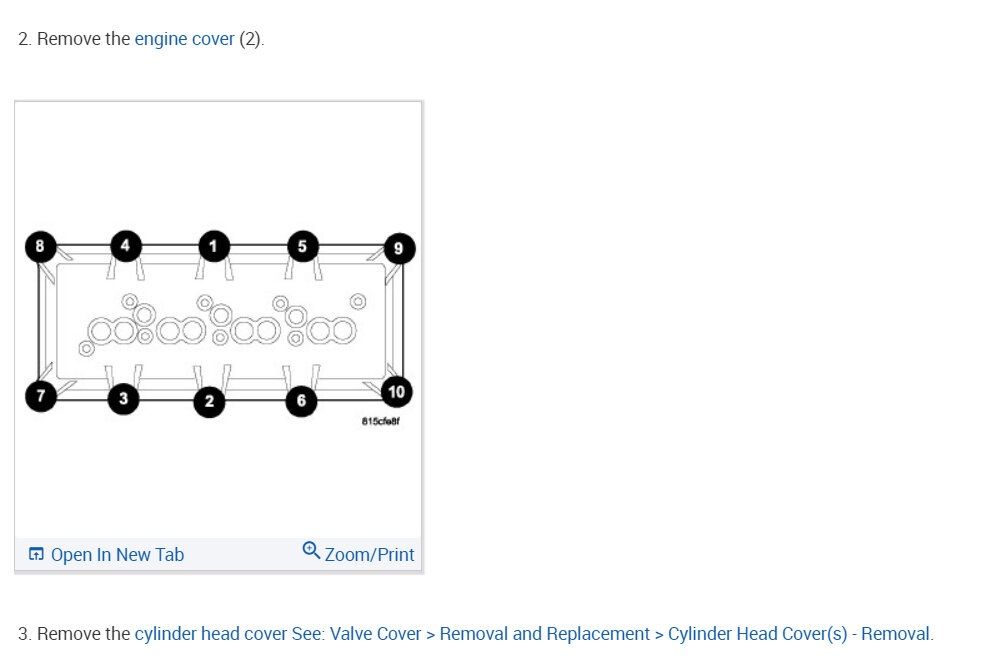

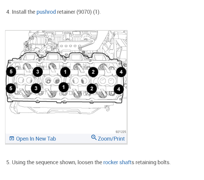

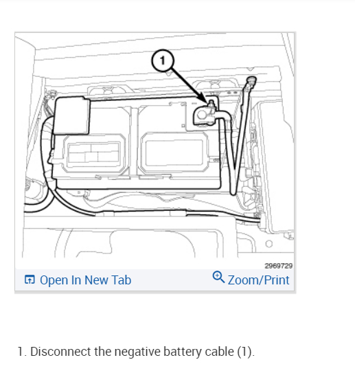

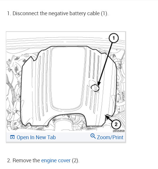

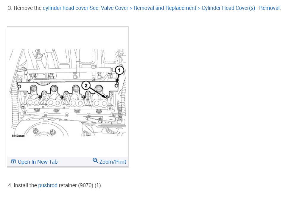

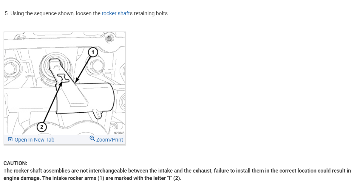

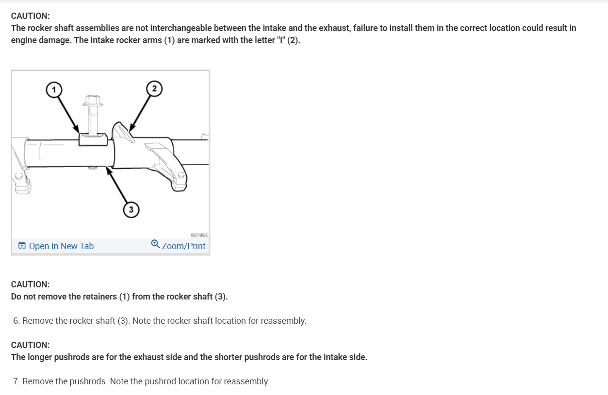

Yes, that are the same for both sides, here is how the rocker shafts and arms are replaced. Check out the images (below). Let us know what happens and please upload pictures or videos of the problem.
Oct 15, 2022 at 12:49 PM
BHAMDOC1973
  • 2,008 POSTS
what is the torque on the bolts?
Oct 15, 2022 at 1:49 PM
3. Install the rocker shaft assemblies in the same order as removed.
4. Using the sequence shown, tighten the rocker shaft bolts to 22 Nm (16 ft. lbs.).
Oct 16, 2022 at 2:02 PM

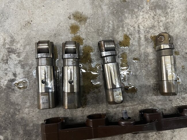

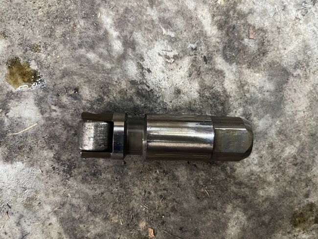

Removed driver side. Found one collapsed. Can you help me with the part number?
It's on the front mds section.
It's the 3rd one in the picture in order from front to back.
I assume other than the difference between the two types for being mds with a hole and non mds, nothing else is different and the rear ones are same as front?
Nov 9, 2022 at 12:26 PM
Good find It looks like the camshaft will be bad as well, here is the part number for the lifters.

I am just going to change the one lifter and see, don't want to fool with cam.
Nov 10, 2022 at 9:41 AM
It will work for a little while.
