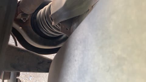

The ticking sound seems to slow down with time. Like it is trying to cool down. I have the phone under the back tire. I drove it about 2 minutes, around the corner. The car is not on.
