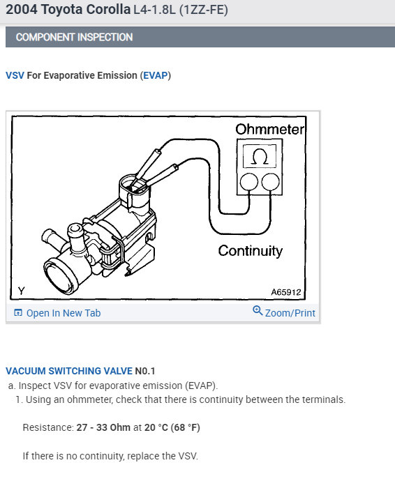

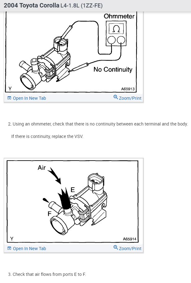

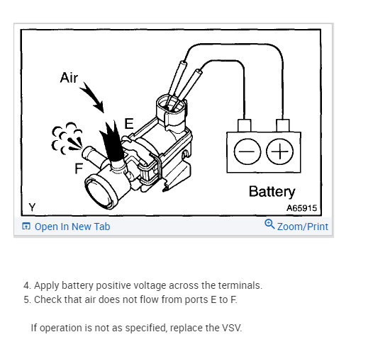

I have attached the solenoid test procedure below for your reference.
