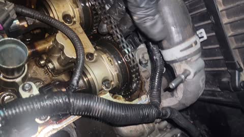

I think you're right look at the different, does that mean i need to replace valves as well? Check out the video.
Oct 1, 2023 at 10:38 AM

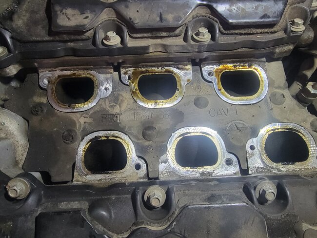

Also oil spitting up from exhaust side.
Oct 1, 2023 at 10:39 AM

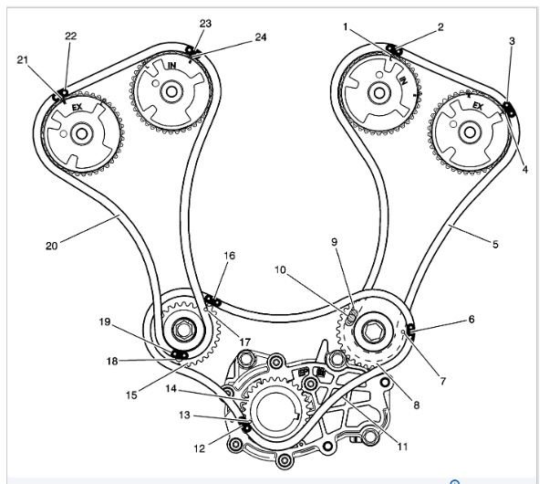

Is the one timing chain a lot looser than the other? It's hard to see your hand on the first one you check. Is that the same side that you are seeing oil from the exhaust side?
Also, take a look at the guides. Is anything damaged? If not, we need to confirm the timing is correct. I attached a pic below showing the timing mark locations.
See pic below.
Oct 1, 2023 at 7:36 PM

The head closer to the engine bay has a tighter chain the one closer to the front of the bumper is way looser it is almost possible to pull it off, the valves where i see the oil has the tighter chain the looser chain has no oil leakage if the timing slipped do i need to check the valves from being bent, if so how can i check that compression test?
Oct 1, 2023 at 7:45 PM
Based on how it was running, I don't think there is internal damage, but anything is possible.
If you had a bent valve, for sure there would be a cylinder misfire. You would have felt it.
As far as testing, you have two things to try. First, a compression test will certainly tell you if there is a damaged valve because the compression will be much lower in the affected cylinder.
Here is a link that explains how it's done:
You will need a compression gauge to test. If you don't have one, most parts stores will lend one to you.
On the other hand, if you can get a borescope, you can check down inside of the cylinders for evidence of damage.
