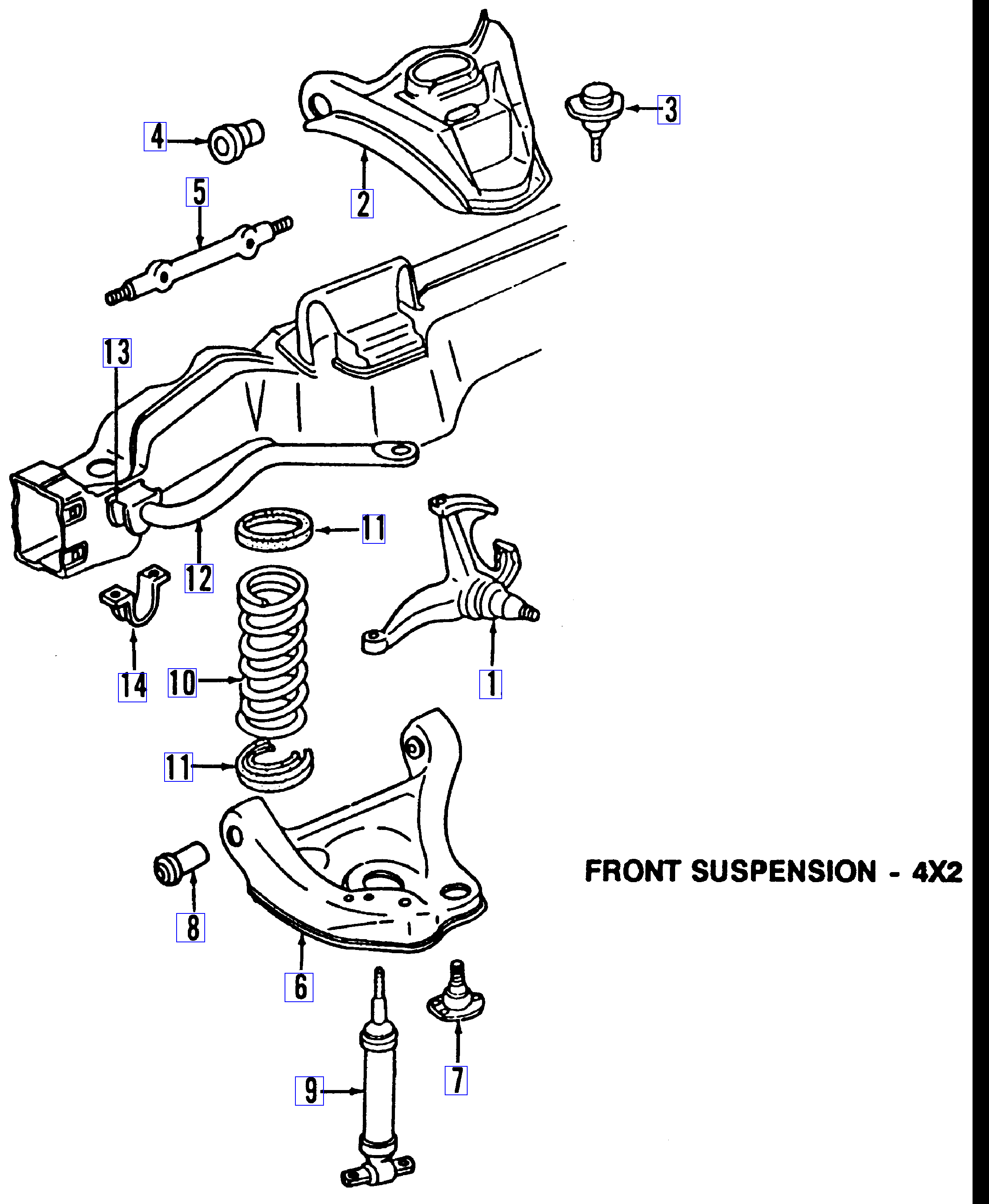

Now, if you are hearing a clunking noise, it is important to have the steering and suspension components checked. If you have a good jack and safety stands, lift one side of the front end off the ground at a time and grab the wheel at both 3 and 9 o-clock as well as 6 and 12 and wiggle the wheel to see if there is excessive play in any of the components.
I attached an exploded view of the steering and suspension components.
Check for bushings that are bad, excessive play in any of the components, and confirm the steering stabilizer bushings and bar are in good condition.
