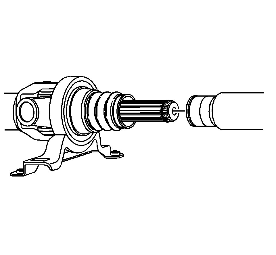

If you find the prop shaft center support bearing is the problem, here are the directions for replacement. The attached pics correlate with the directions.

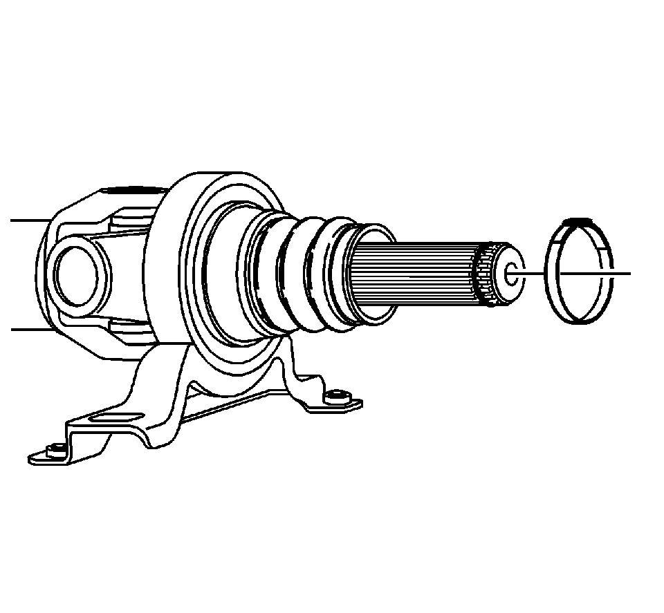

pic 1
1. Using a paint stick, mark the shaft on both sides. The splines are not keyed, therefore, alignment marks are necessary for assembly.
Notice: Never clamp propeller shaft tubing in a vise. Clamping propeller shaft tubing in a vise could dent or deform the tube causing an imbalance or unsafe condition.
Always clamp on one of the yokes and support the shaft horizontally.
Important: Proper alignment on assembly is critical in order to maintain correct balance.

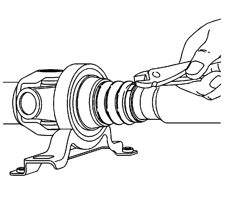

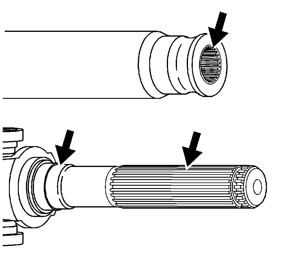

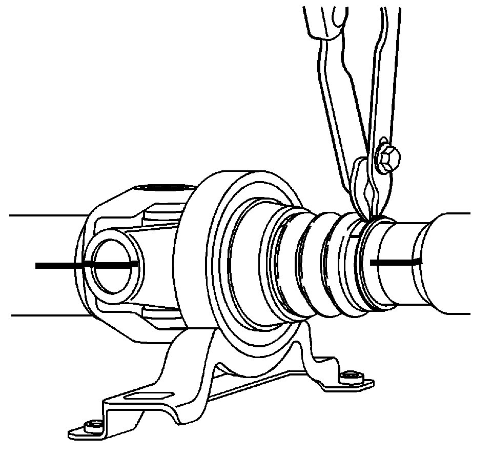

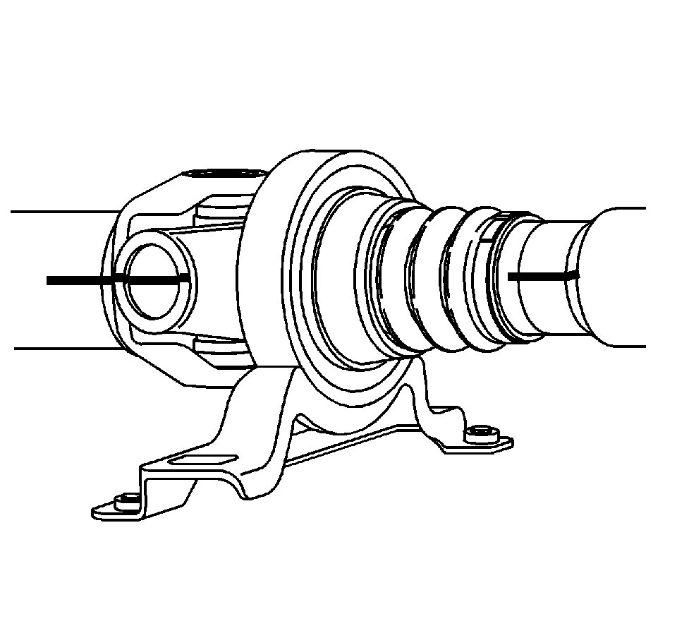

pic 2
2. Remove the clamp holding the dust boot to the shaft. Discard the clamp.
Important: The clamp is not reusable.

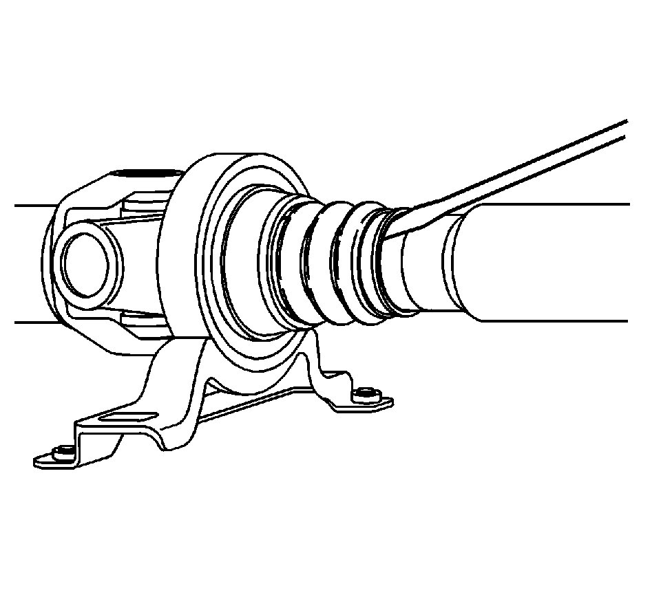

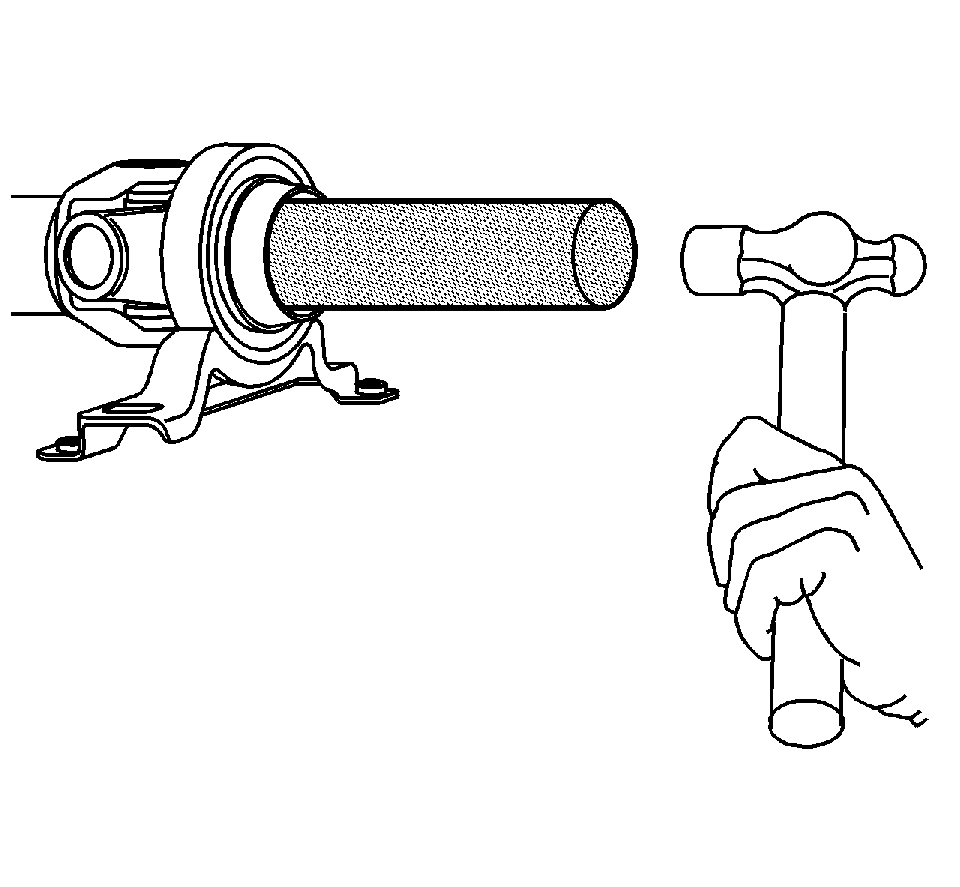

pic 3
3. Pry the dust boot off the shaft tube.

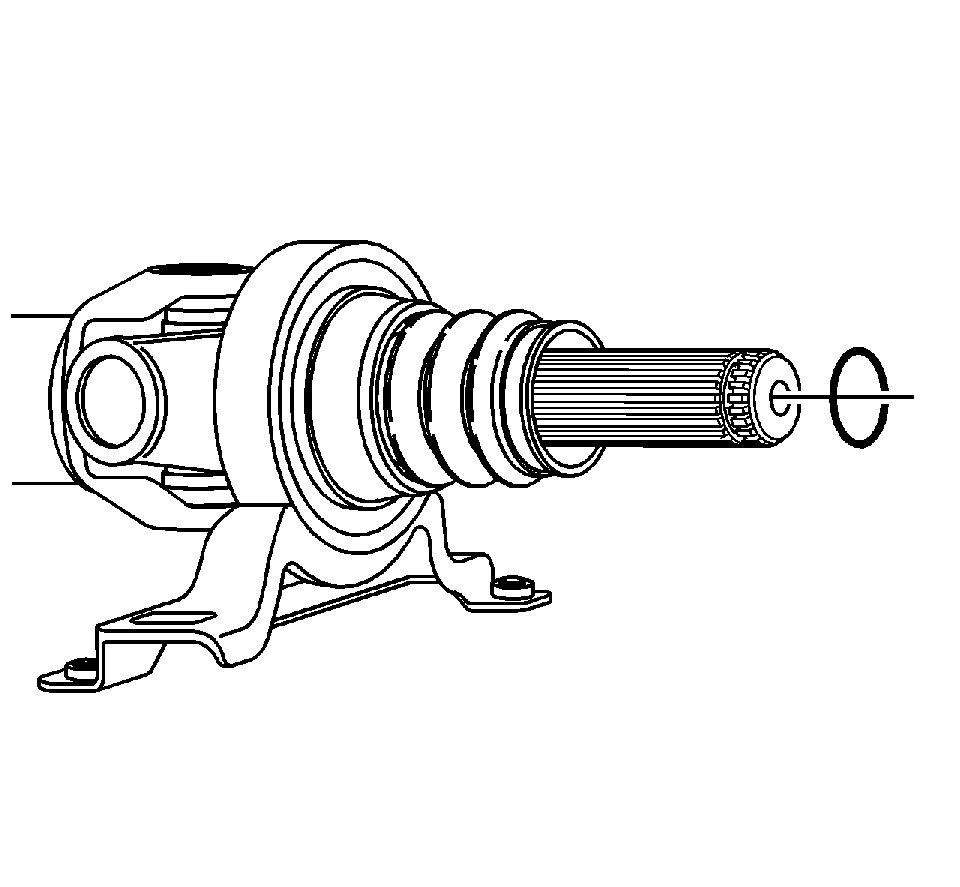

pic 5

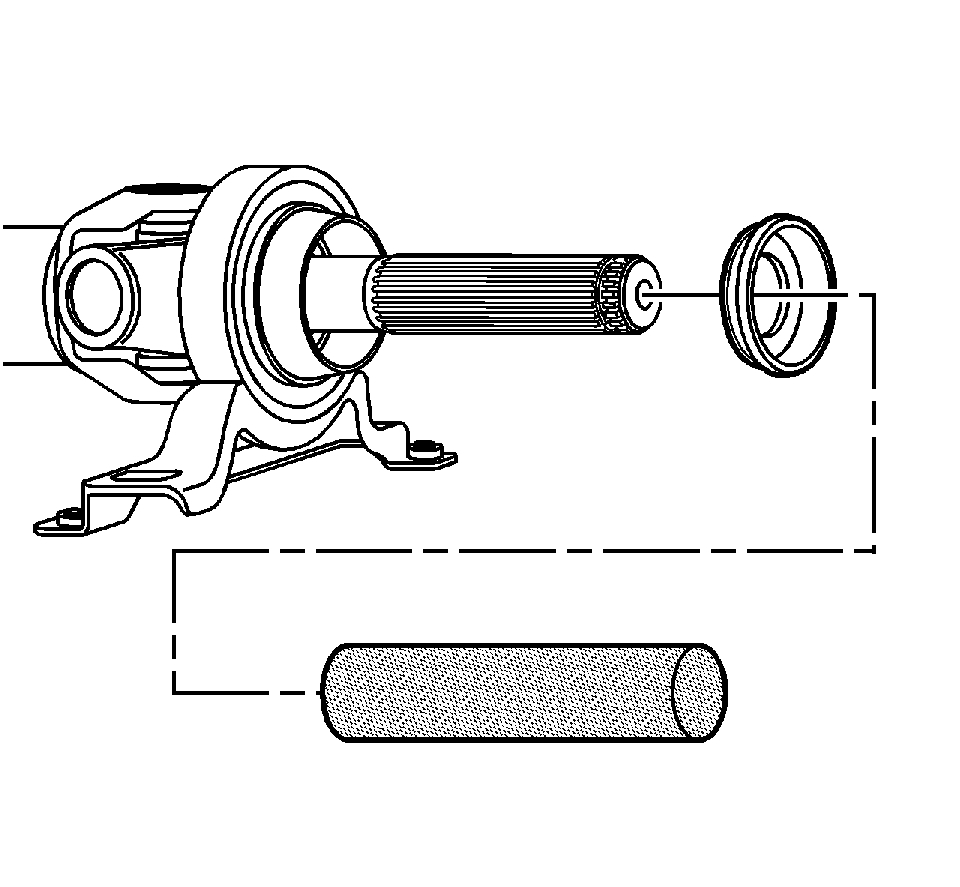

5. Remove the O-ring from the end of the spline shaft.

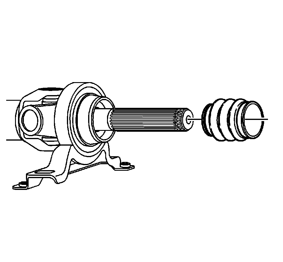

pic 6
6. Remove the dust boot.

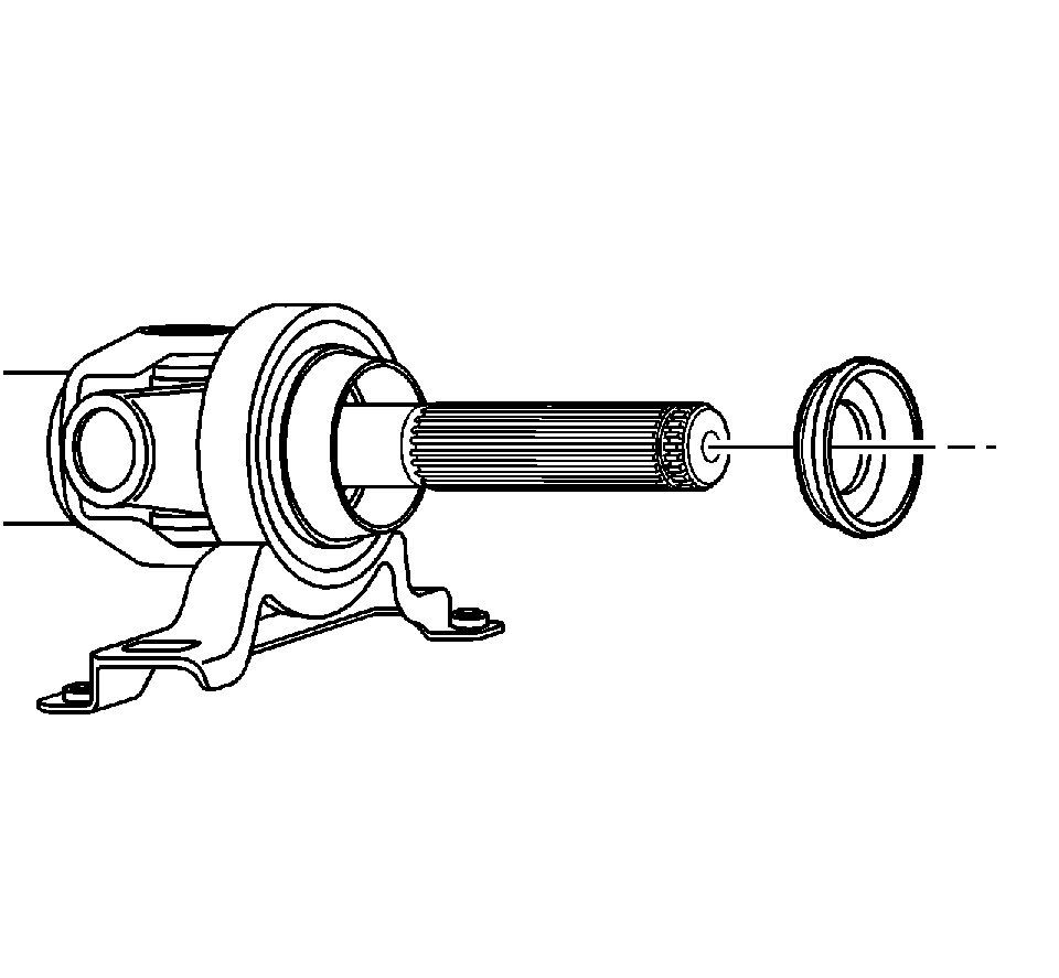

pic 7
7. Pry off the bearing slinger from the spline shaft. Discard the slinger.
Important: Do not reuse the slinger.

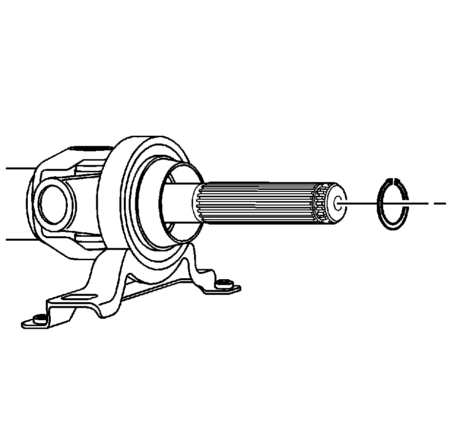

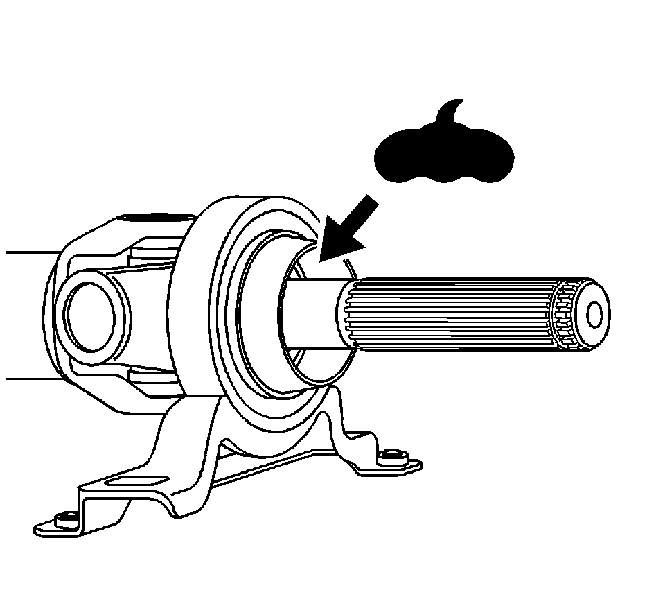

pic 8
8. Remove the snap ring from the groove.
Important: Grease may have to be removed to see the snap ring.

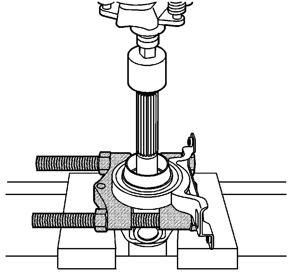

pic 9
9. Install the J22912-01 around the shaft behind the bearing. Place shaft in a press and remove the bearing.
