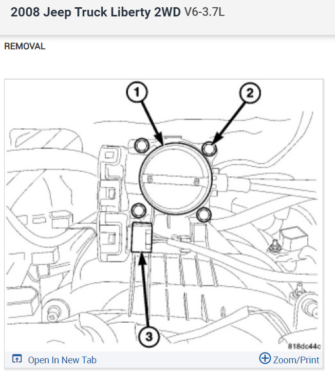

To me it sounds like you have a throttle body that needs to be serviced. But we should get the code numbers, so we head off in the right direction to fix the car, here are two guides to help us see what's going on and how to service the throttle bore for your car in the images below.
https://www.2carpros.com/articles/can-scan-controller-area-network-easy
and
