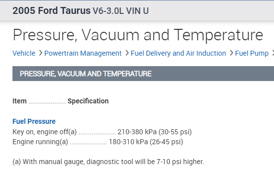

Is the noise you hear loud enough for you to record and upload for me to hear? If so, could you possibly do that?
As far as the codes are concerned, two of them are lean codes which indicate either a vacuum leak as you mentioned, or it could be a low fuel pressure issue.
Now, if there is an exhaust leak before the catalytic converter, which can cause a lean code, I need to confirm what you are hearing isn't a leak.
To get you started, take a look through this link. It explains how to locate and repair an engine vacuum leak.
If you are unable to find a leak, we will need to check the fuel pressure. Here is a link that explains in general how that is done.
I attached a pic below providing the manufacturer's fuel pressure specifications.
