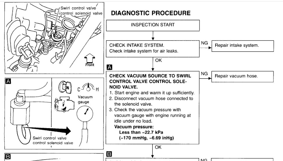

Also, the code is specific to a faulty swirl valve which certainly affects the idle. This system has a swirl control valve in the intake passage of each cylinder. While idling and during low engine speed operation, the swirl control valve closes. Thus, the velocity of the air in the intake passage increases, promoting the vaporization of the fuel and producing a swirl in the combustion chamber.
I attached diagnostics below. However, before starting, check to see if there is a vacuum leak to the control valve (see pic 1 showing it being tested with a vacuum gauge).
See pics below.

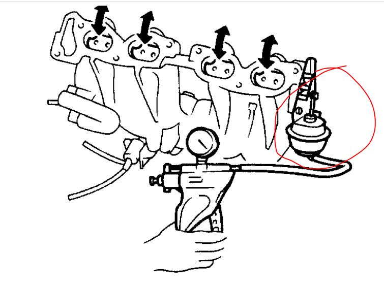

No problem whatsoever as to how long it takes. I'll be here. LOL Also, the idle control valve and swirl valve should be two different things. Take a look at what I circled above.
Keep in mind, something may be blocking a vacuum hose, so you may not see a leak, but vacuum may not be present.

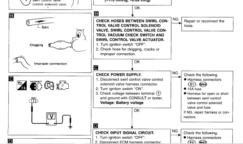

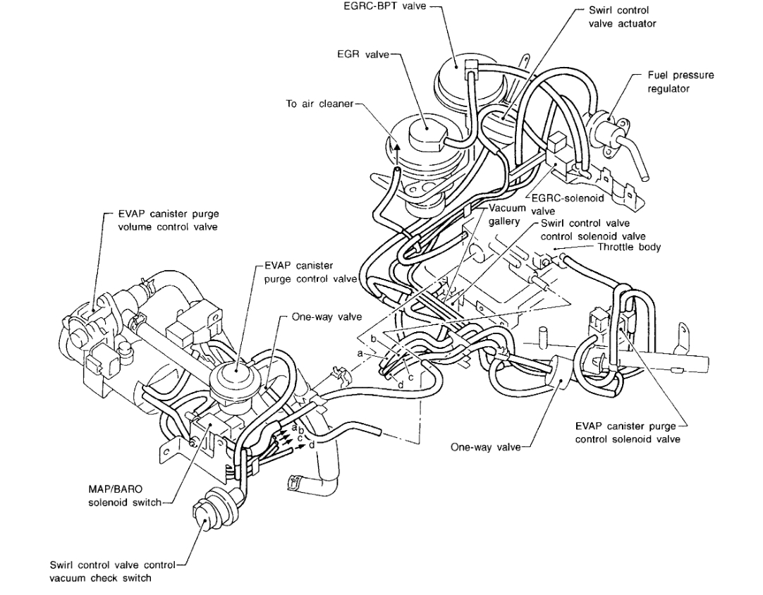

P1130 - Swirl Control Valve Control Solenoid Valve: This code suggests that there is an issue with the control solenoid valve for the swirl control system. So, I would do what Joe's says and use vacuum on the valves to make sure they work correctly, then I would check the vacuum line routing, here is a guide to help you. Check out the images (below). Please let us know what happens.
Aug 9, 2024 at 8:25 AM

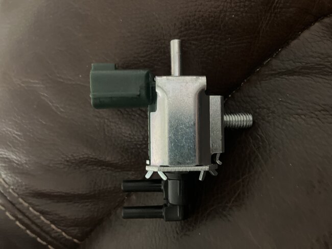

Okay Men. I believe i have been miss leading. I sent a picture of what i thought was the swirl valve. Now i am a Little confused. The valve in the picture is identical to the one that’s still in the truck. This one connects to this swirl valve actuator. No vacuum from actuator. Kind of lost now on what to check. Thanks again

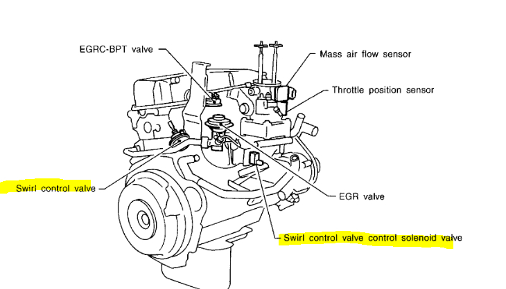

The pic you attached is the control solenoid valve. That should have a vacuum supply to it from the engine at one port and the other connector port vacuum hose goes to the control valve. Anytime the engine speed is below 3200 RPMs, the control valve should supply vacuum to the swirl valve.
If you have a vacuum leak at the control valve (your pic above), it needs replaced or you have a damaged or disconnected vacuum hose.
Let me know if this helps. Also, the swirl control valve should hold vacuum. If it doesn't, it needs to be replaced as well.
See pic below.
