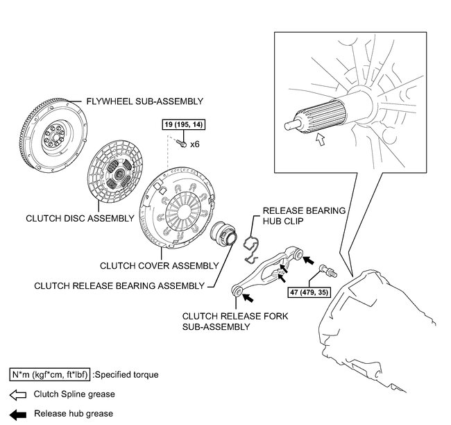

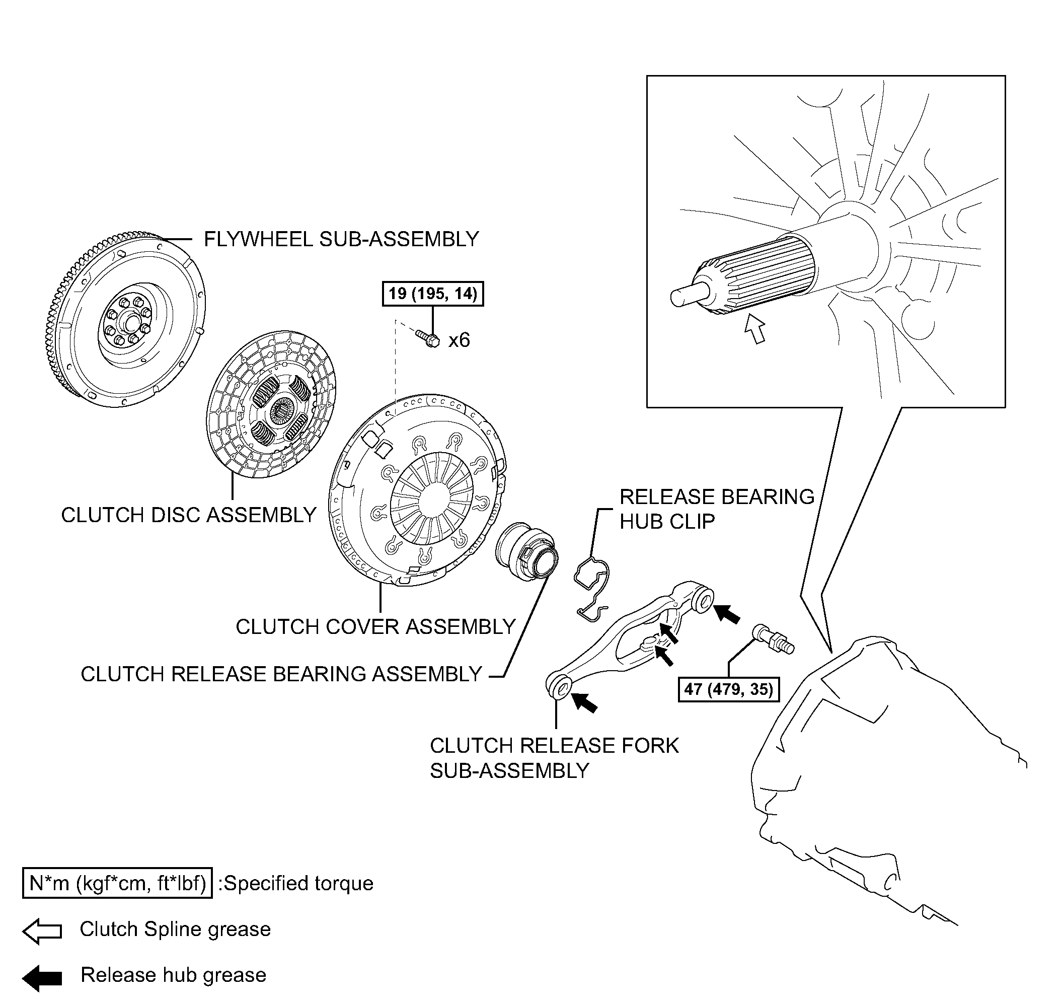

CLUTCH UNIT
Components
picture 1
REMOVAL

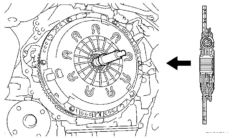

1. REMOVE MANUAL TRANSMISSION UNIT ASSEMBLY

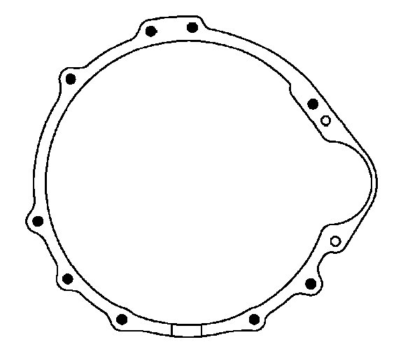

pic 2

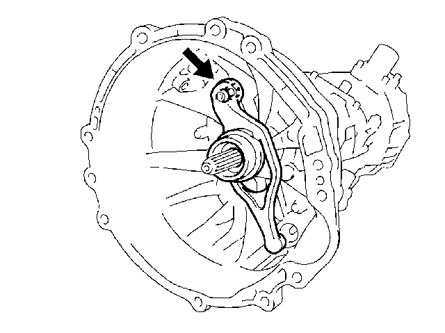

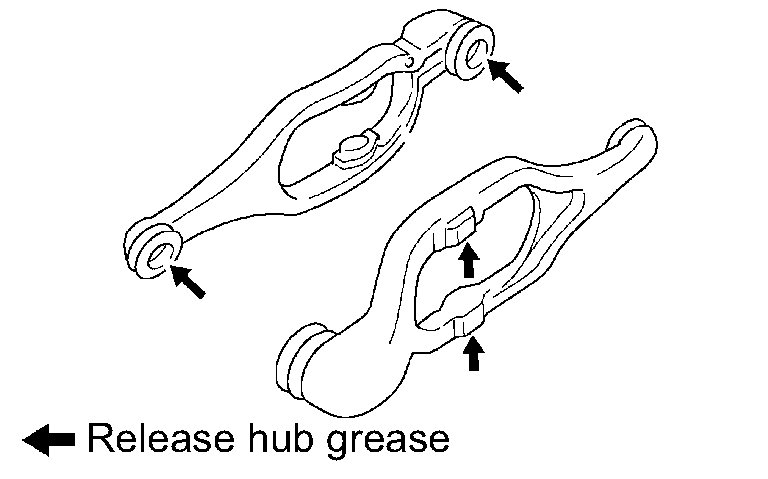

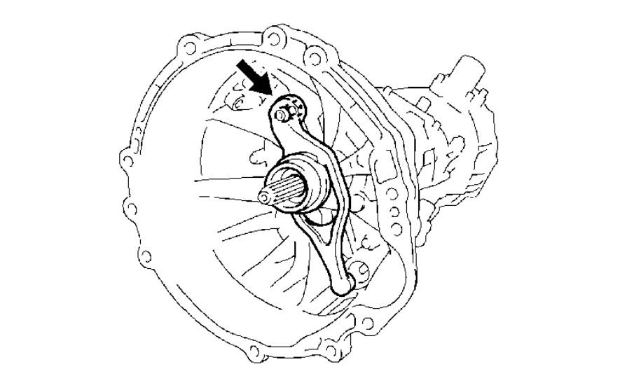

2. REMOVE CLUTCH RELEASE FORK SUB-ASSEMBLY
a. Remove the clutch release fork together with the clutch release bearing from the transmission assembly.
3. REMOVE CLUTCH RELEASE BEARING ASSEMBLY
a. Remove the clutch release bearing assembly from the clutch release fork.

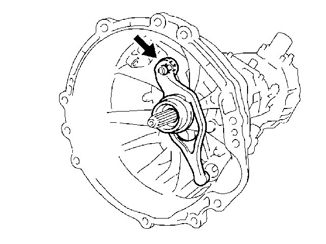

4. REMOVE RELEASE FORK SUPPORT
a. Remove the release fork support from the transaxle assembly.

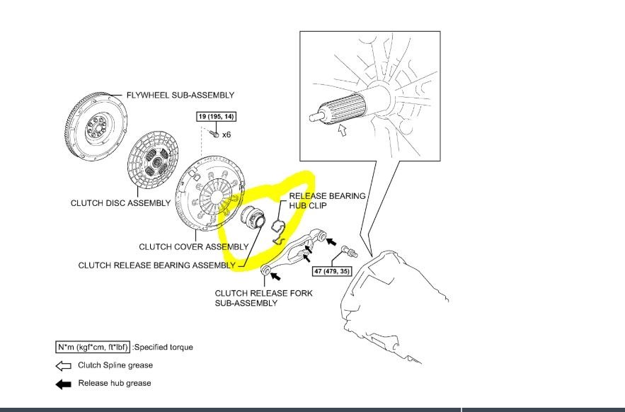

5. REMOVE RELEASE BEARING HUB CLIP

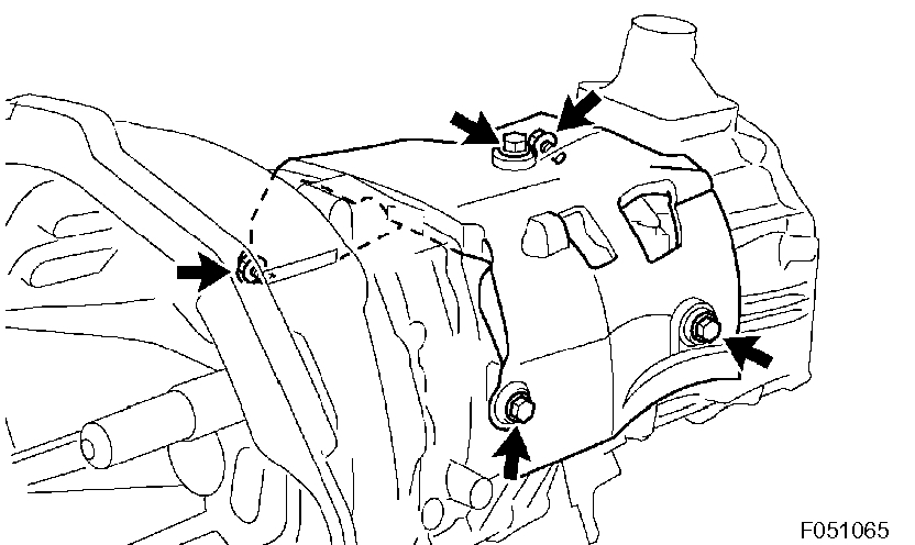

pic 3

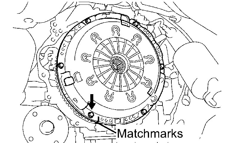

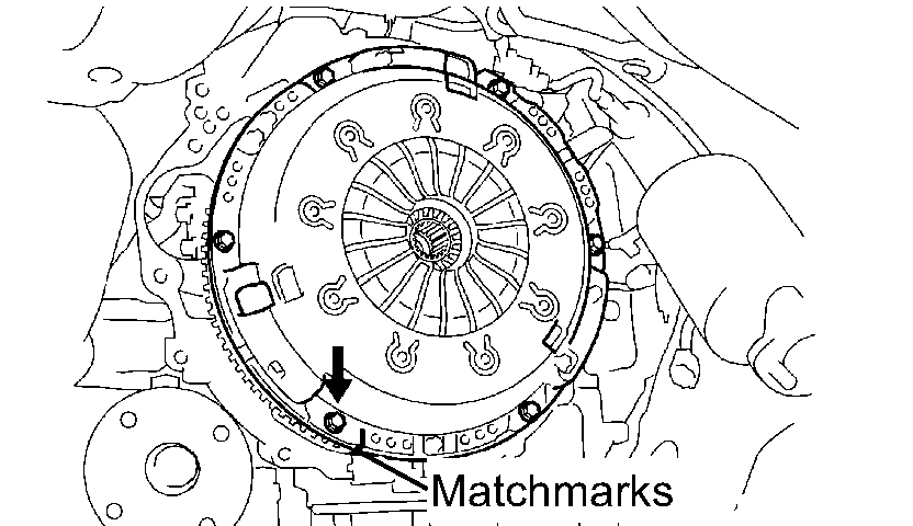

6. REMOVE CLUTCH COVER ASSEMBLY
a. Align the matchmark on the clutch cover assembly with the one on the flywheel sub-assembly
b. Loosen each set bolt one turn at a time until the spring tension is released.
c. Remove the 6 bolts and clutch cover assembly
NOTICE: Do not drop the clutch disc assembly.

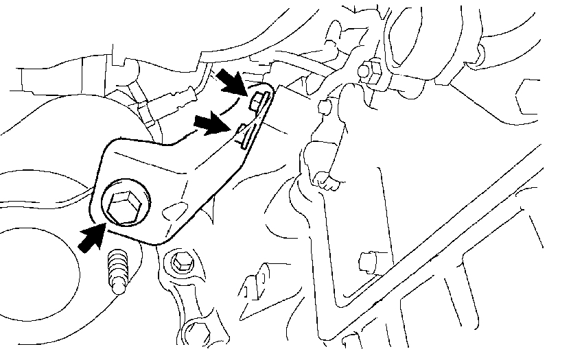

pic 4

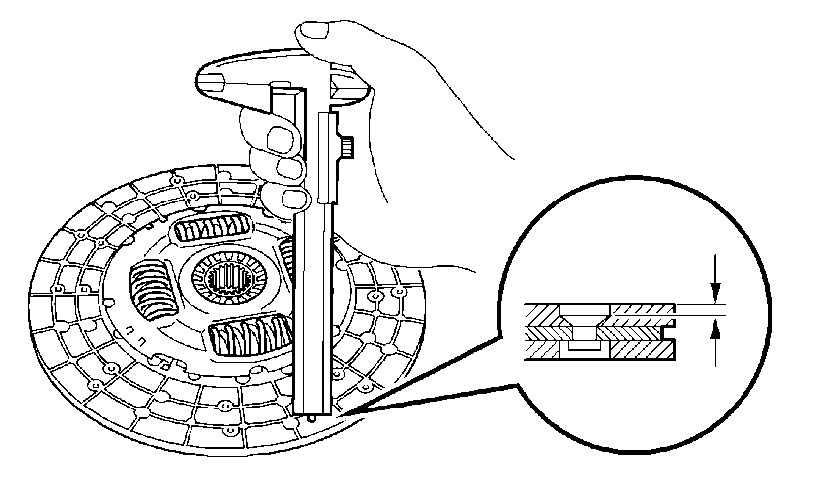

1. INSPECT CLUTCH DISC ASSEMBLY
a. Using vernier calipers, measure the rivet head depth.
Maximum rivet depth: 0.3 mm (0.012 inch)
If necessary, replace the clutch disc assembly
b. Install the clutch disc assembly onto the transaxle assembly.
NOTICE: Take care not to insert the clutch disc assembly in the wrong orientation.

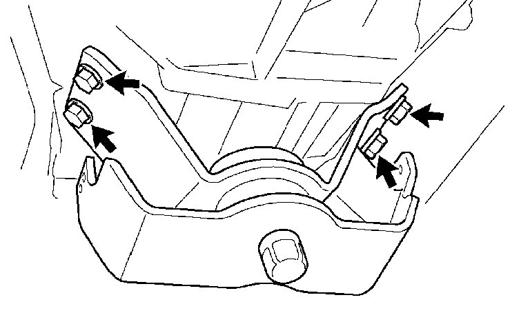

pic 5

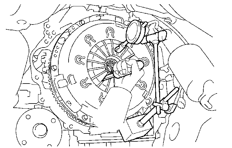

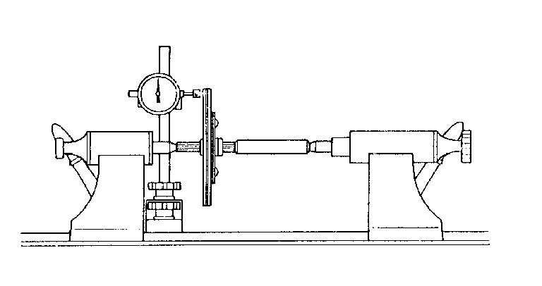

c. Using a dial indicator, check the clutch disc assembly runout.
Minimum runout: 1.0 mm (0.039 inch)

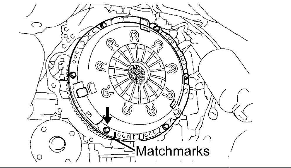

pic 6

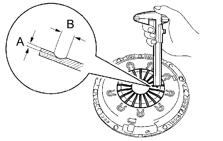

2. INSPECT CLUTCH COVER ASSEMBLY
a. Using vernier calipers, inspect the depth and width of wear of the diaphragm spring.
Minimum:
A (Depth): 0.5 mm (0.020 inch)
B (Width): 6.0 mm (0.236 inch)
If necessary, replace the clutch cover assembly.

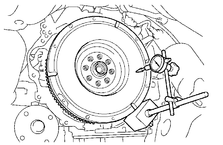

3. INSPECT FLYWHEEL SUB-ASSEMBLY
a. Using a dial indicator, inspect the flywheel sub assembly runout.
Maximum runout: 0.1 mm (0.004 inch)
If necessary, replace the flywheel sub-assembly.

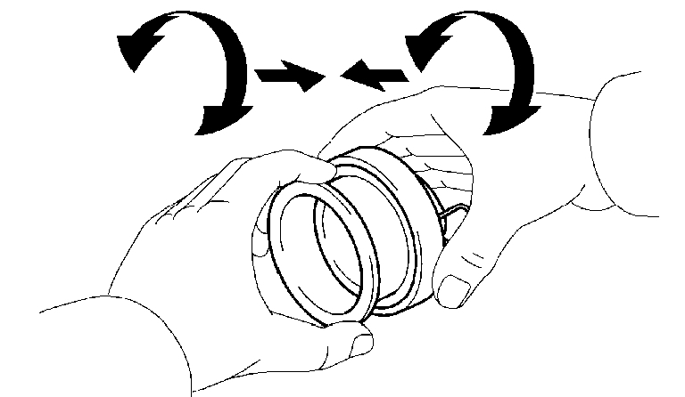

4. INSPECT CLUTCH RELEASE BEARING ASSEMBLY
a. Turn the release bearing by hand while applying force in the axial direction.
HINT: The bearing is permanently lubricated and requires no cleaning or lubrication.
If necessary, replace the release bearing assembly.

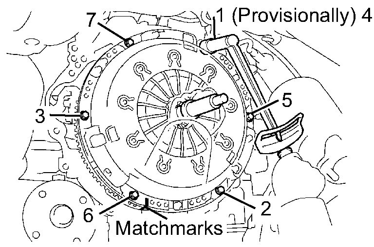

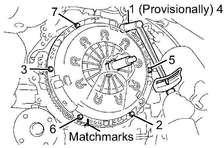

2. INSTALL CLUTCH COVER ASSEMBLY
a. Align the matchmarks on the clutch cover assembly and flywheel sub-assembly.
b. Following the procedures shown in the illustration, tighten the 6 bolts, in the order starting with the bolt located near the knock pin on the top.
Torque: 19 Nm (195 kgf-cm, 14 ft. lbs.)
HINT: Following the order in the illustration, uniformly tighten the bolts.
c. Move SST up and down, right and left lightly, after checking that the disc is in the center, and tighten the bolts.

6. INSTALL CLUTCH RELEASE FORK SUB-ASSEMBLY
a. Apply release hub grease to the release fork and release the bearing assembly contact surfaces, release fork and push rod contact surface and release fork pivot point.
Sealant: Part No. 08887-01806, RELEASE HUB GREASE or equivalent
b. Install the release fork onto the release bearing assembly.

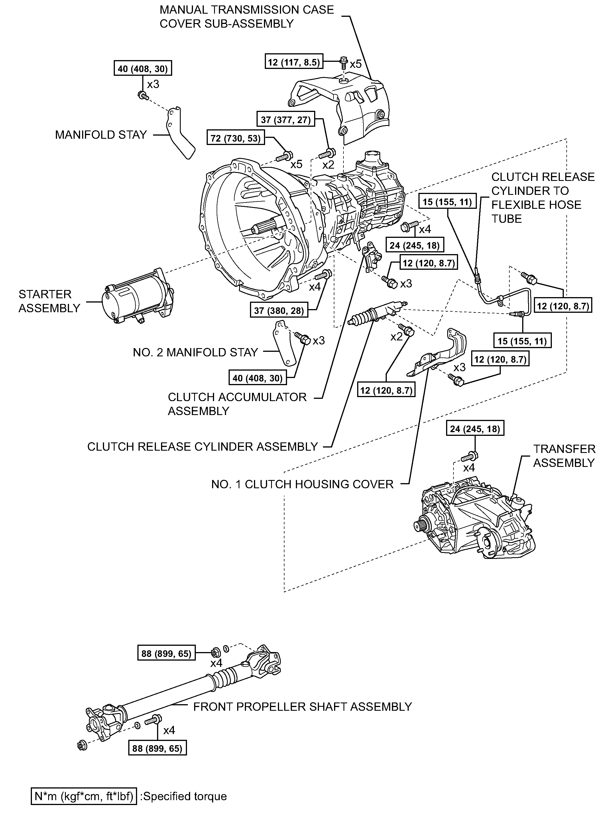

Components

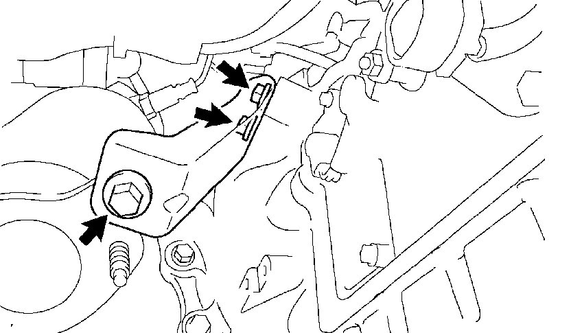

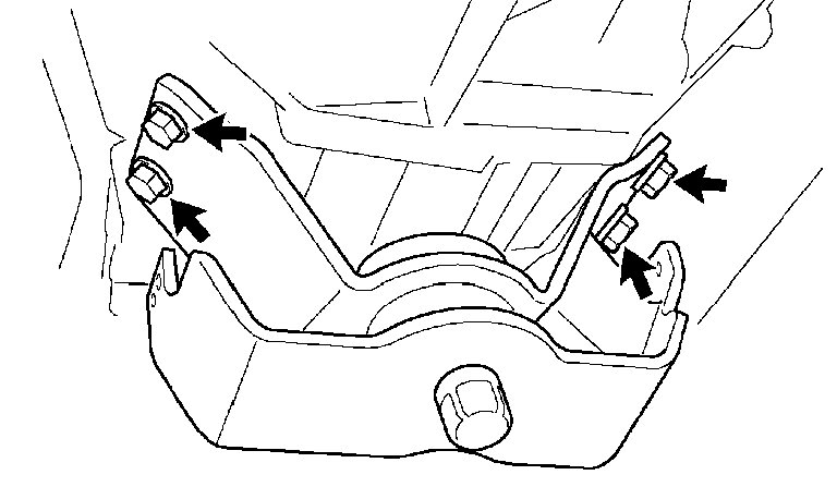

pic 13
Components
pic 14
Components
pic 15
REMOVAL
1. DISCONNECT CABLE FROM NEGATIVE BATTERY TERMINAL

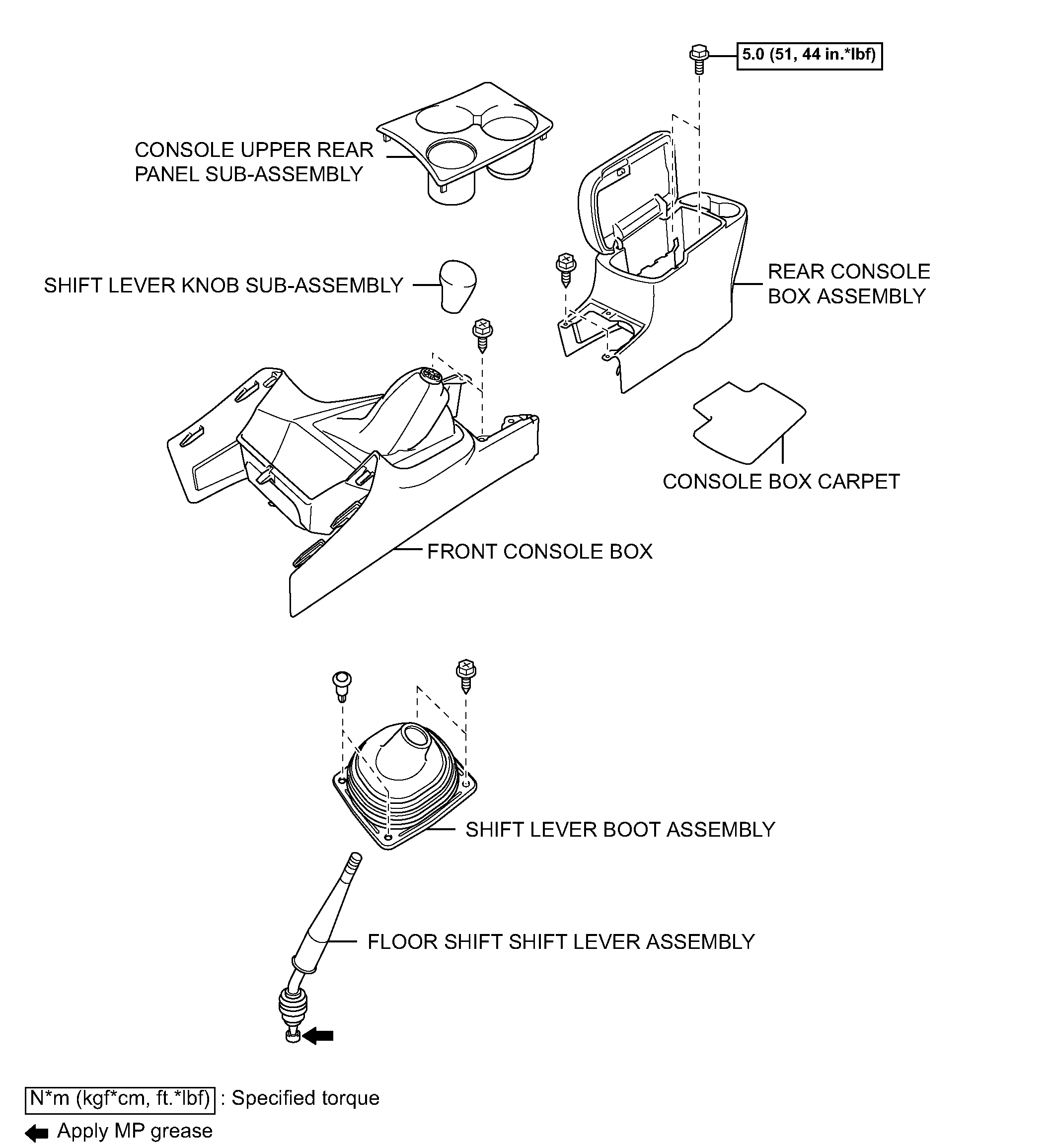

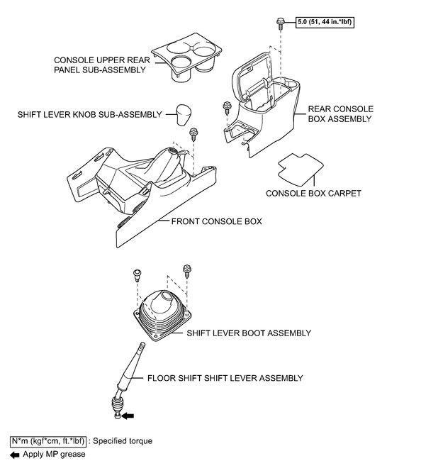

2. REMOVE CONSOLE UPPER REAR PANEL SUB-ASSEMBLY
3. REMOVE REAR CONSOLE BOX ASSEMBLY
4. REMOVE SHIFT LEVER KNOB SUB-ASSEMBLY
5. REMOVE FRONT CONSOLE BOX
pic 16

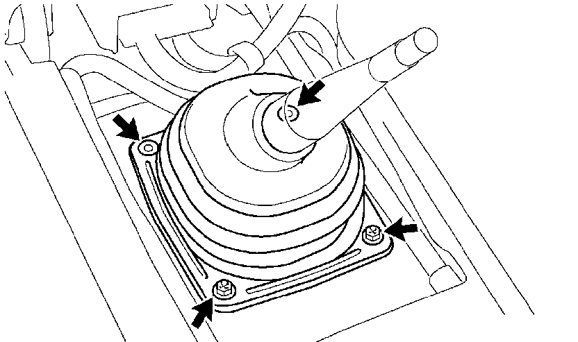

6. REMOVE SHIFT LEVER BOOT ASSEMBLY
a. Remove the 2 screws and 2 clips, then remove the shift lever boot.
pic 17

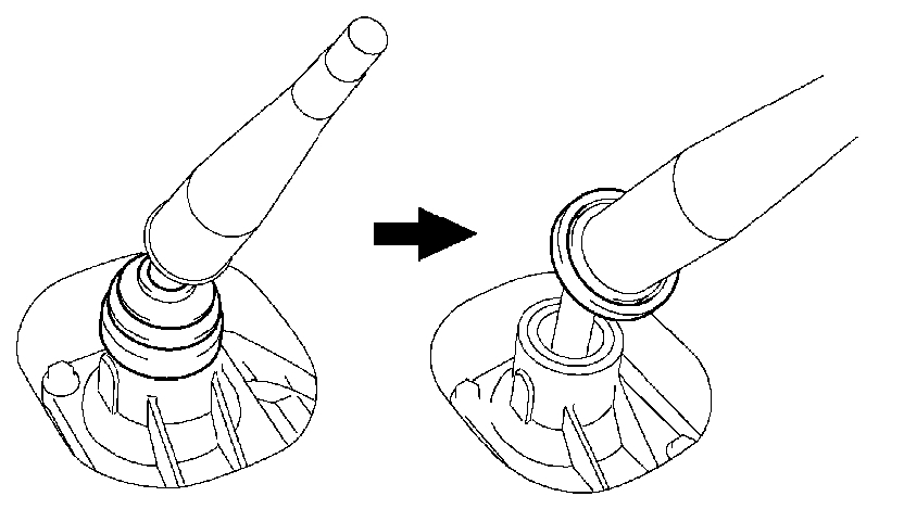

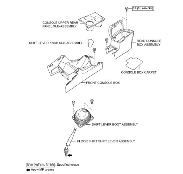

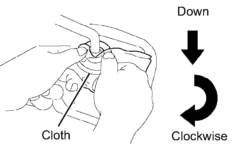

7. REMOVE FLOOR SHIFT SHIFT LEVER ASSEMBLY
a. Separate the shift lever cap boot from the manual transmission.

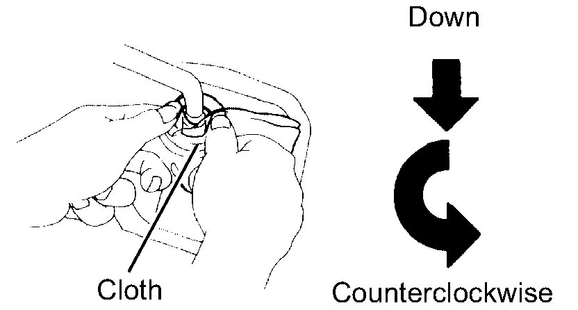

pic 18
b. Cover the shift lever cap with a cloth.
c. Pressing down on the shift lever cap, turn it counterclockwise to remove the shift lever.
d. Pull out the shift lever.

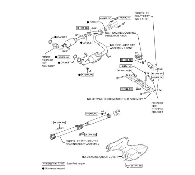

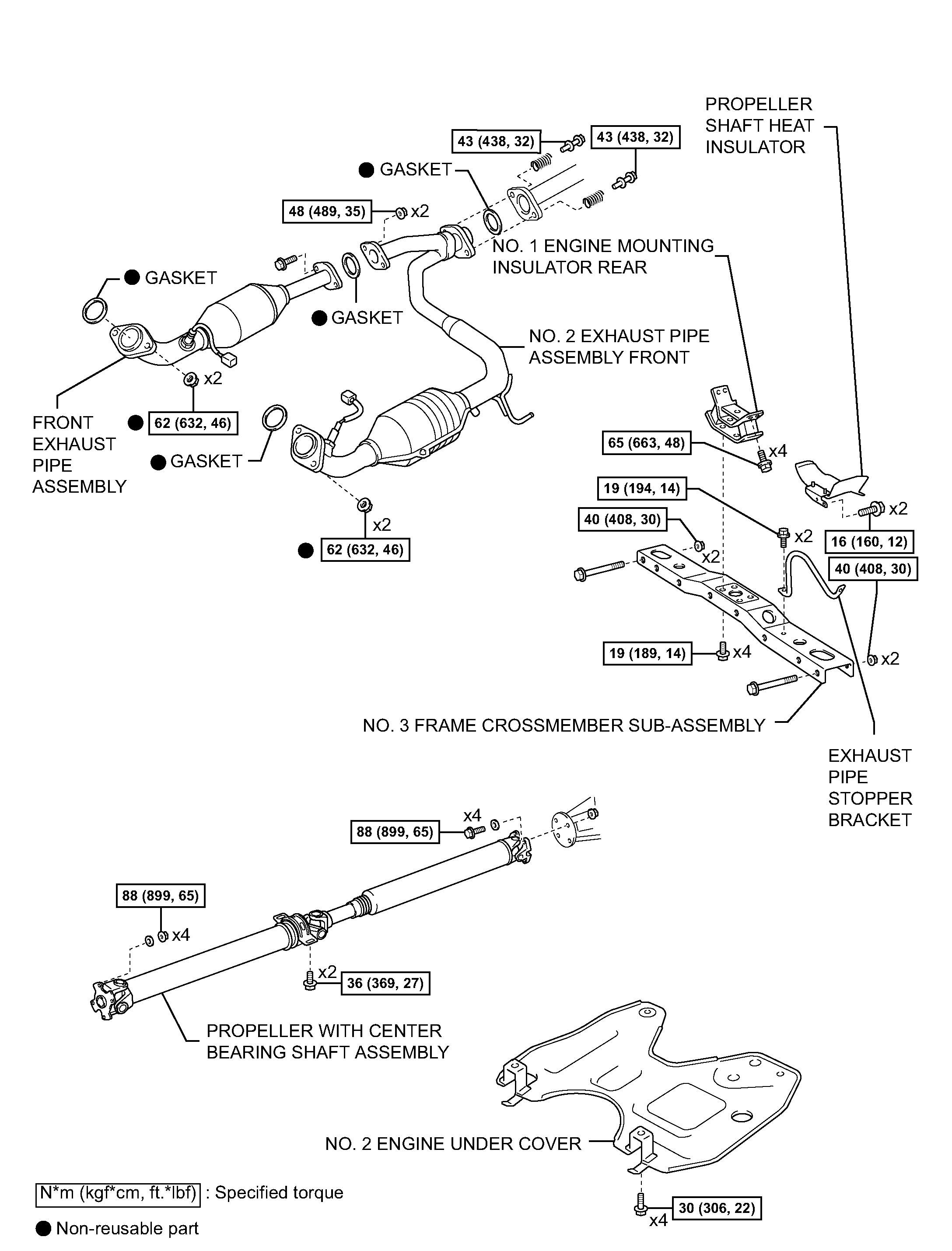

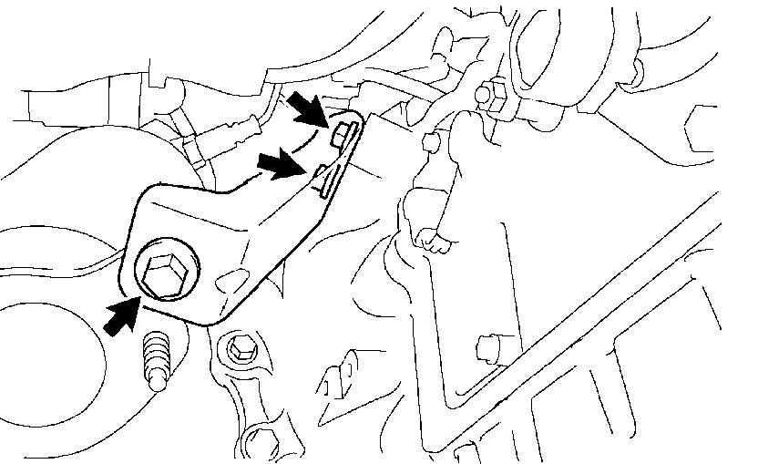

10. REMOVE EXHAUST PIPE ASSEMBLY
11. REMOVE FRONT PROPELLER SHAFT ASSEMBLY
12. REMOVE PROPELLER WITH CENTER BEARING SHAFT ASSEMBLY
pic 19

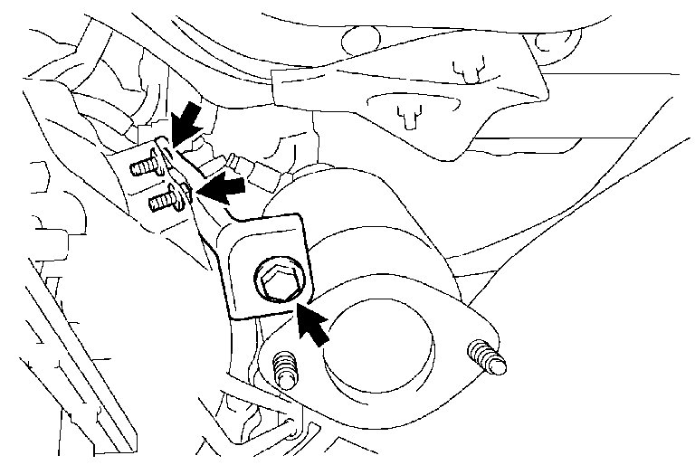

13. REMOVE NO. 2 MANIFOLD STAY
a. Remove the 3 bolts and manifold stay No. 2.
pic 20
14. REMOVE MANIFOLD STAY

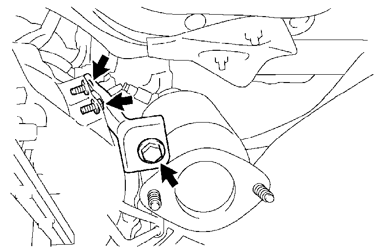

15. REMOVE STARTER ASSEMBLY

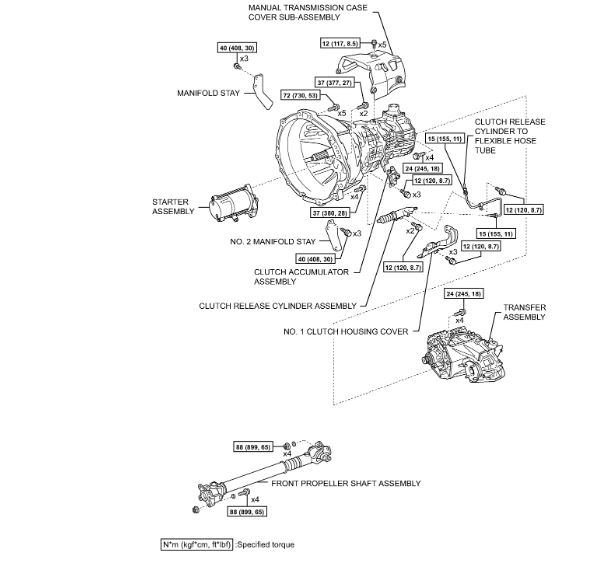

17. REMOVE CLUTCH RELEASE CYLINDER ASSEMBLY
18. REMOVE CLUTCH ACCUMULATOR ASSEMBLY
19. SUPPORT MANUAL TRANSMISSION WITH TRANSFER
a. Support the manual transmission with a transmission jack.
pic 21

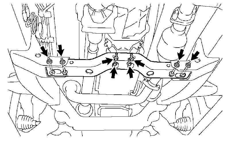

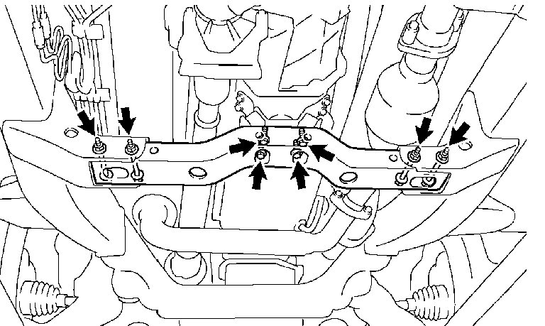

20. REMOVE NO. 3 FRAME CROSSMEMBER SUB-ASSEMBLY
a. Remove the 4 bolts on the frame crossmember subassembly No. 3.
b. Remove the 4 nuts, 4 bolts and frame crossmember sub-assembly No. 3.
pic 22
21. REMOVE NO. 1 ENGINE MOUNTING INSULATOR REAR
a. Remove the 4 bolts and engine mounting insulator rear from the manual transmission.

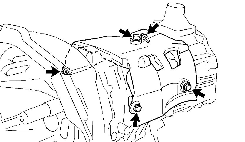

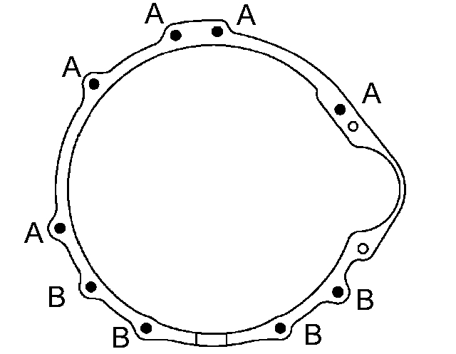

24. REMOVE MANUAL TRANSMISSION WITH TRANSFER
a. Remove the 9 bolts.
b. Separate and remove the manual transmission.
pic 24
25. REMOVE MANUAL TRANSMISSION CASE COVER SUB-ASSEMBLY
a. Remove the 5 bolts and manual transmission case cover.
26. REMOVE TRANSFER ASSEMBLY

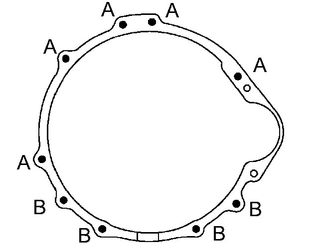

3. INSTALL MANUAL TRANSMISSION WITH TRANSFER
a. Install the manual transmission with transfer with the 9 bolts.
Torque:
72 Nm (730 kgf-cm, 53 ft. lbs.) for bolt A
37 Nm (380 kgf-cm, 28 ft. lbs.) for bolt B

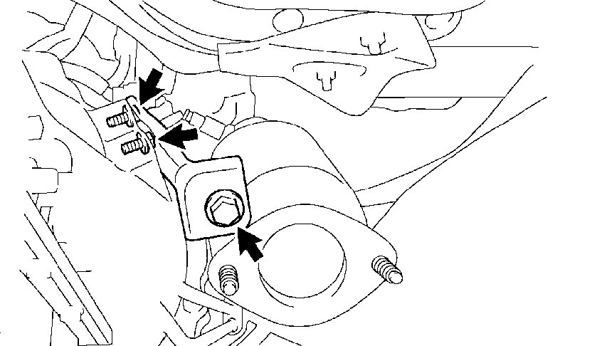

12. INSTALL NO. 2 MANIFOLD STAY
a. Install the manifold stay No. 2 with the 3 bolts.
Torque: 40 Nm (408 kgf-cm, 30 ft. lbs.)

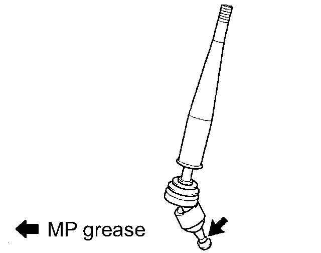

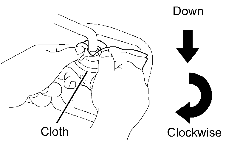

19. INSTALL FLOOR SHIFT SHIFT LEVER ASSEMBLY
a. Apply MP grease to the tip of the shift lever.
pic 32
c. Pressing down on the shift lever cap, turn it clockwise to install the shift lever.
