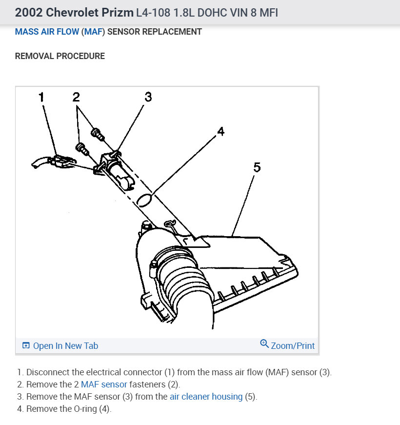

There are four things that come to mind about low power, clogged air filter or catalytic converter, weak fuel pump or a bad MAF sensor. Unfortunately, there are no trouble codes relating to these issues so will need to test or inspect these items ourselves.
Here are guides to help us get started:
https://www.2carpros.com/articles/engine-has-low-power-output
and

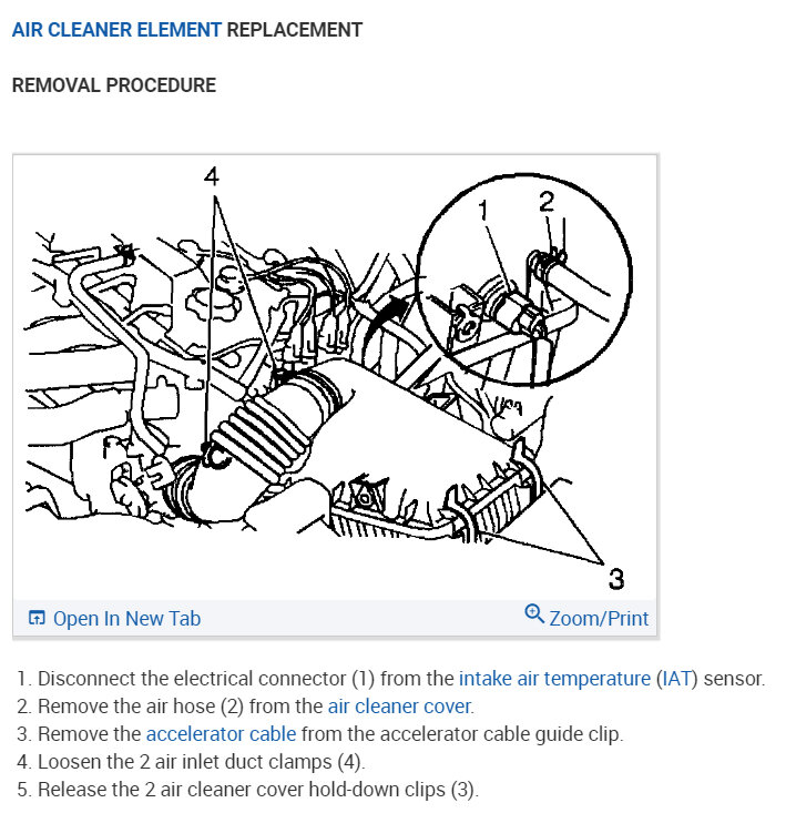

https://www.2carpros.com/articles/how-to-replace-a-car-air-filter
and
and this one you can rent a fuel pressure gauge from the auto parts store for free or close to it.
Fuel Pressure .................... 44-50 PSI
(KOEO) Key On Engine Off

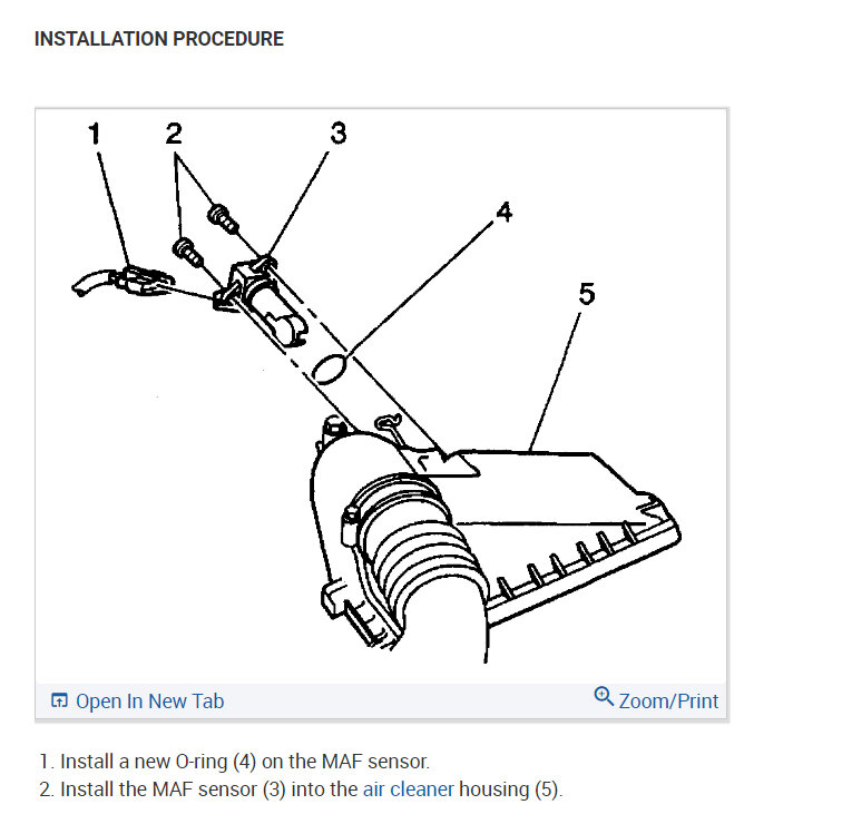

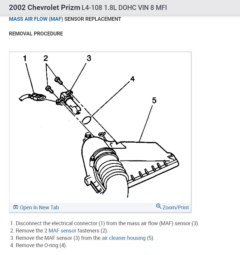

The mass air flow sensor you will need to replace because there is no good test for this sensor without comparing it to a new sensor. The location of the sensor is in the images below. Let us know what happens and please upload pictures or videos of the problem.

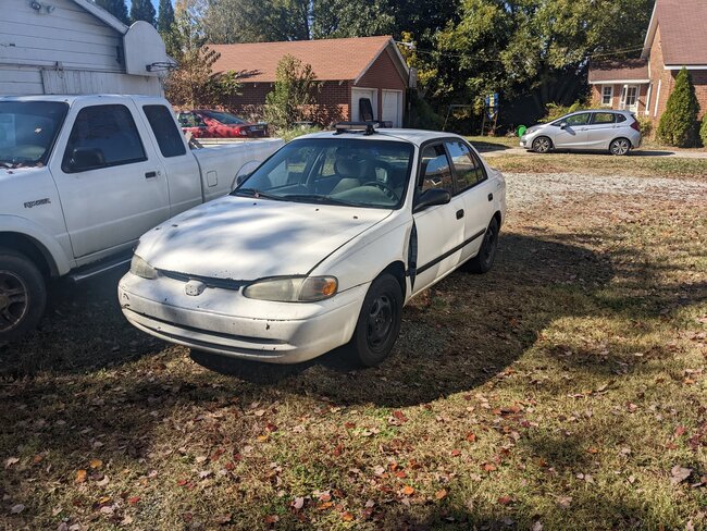

Again, I don't want to dump money into mods. I want to milk this little $300.00 piece of junk for every penny I can. I attached a pic of this fine chariot for you to laugh at. That's the good side.
Dec 30, 2022 at 4:10 PM
I love it! the perfect go getter! I don't know about shaving the throttle plate or what it can do. I would do the air filter and then check the fuel pressure. Also, if the engine has low compression, then there is nothing you can do about the power. We can check a few cylinders by following this guide:
