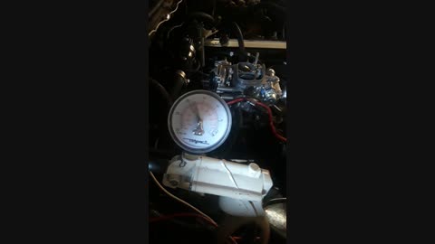

After getting it all put together and in the truck I got it running, set timing to 1 BTC (that's where it performs the best) it's got 72 psi oil pressure cold, 35 warm, all cylinders have exactly 182 psi of compression, its pulling 21 inches of vacuum, no vacuum leaks of any kind, and the choke functions properly.
