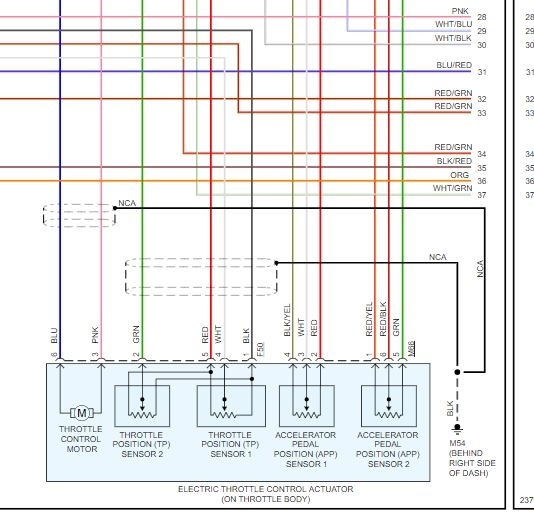

Okay, the common denominator is is wiring. You have a harness issue. The wiring needs to be checked.
I would find another mechanic. He should have seen this on his own. If he did not then he is not familiar with these systems.
I attached a wire diagram for you to view. All this needs to checked and verified.
