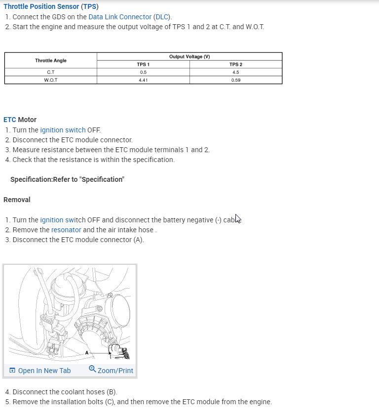

can I just replace the sensor or do I have to change the whole throttle body?

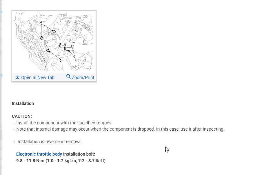

Unfortunately it comes as a complete assembly because it is a calibrated item. I attached the process to replace in case you need that.
Please let me know if you have any other questions.
