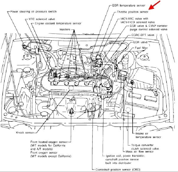

Wondering if you could tell me where the throttle position sensor is and/or show me a diagram of its location?

When you have an engine-related problem, please specify which engine you have. Wiring diagrams, parts, and systems can be very different. I found this drawing for the 1.6L. The drawing for the 2.0L is considerably different, but the TPS is in the same place on the throttle body.

I am sorry, it is a 1.6 L I think.
