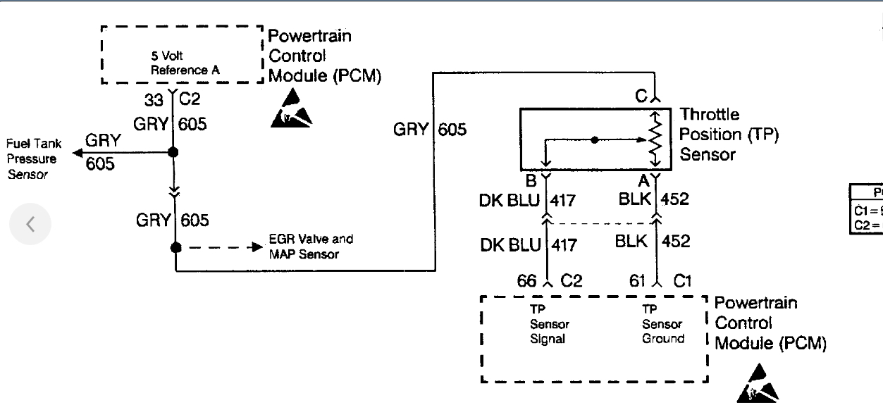

CIRCUIT DESCRIPTION
The Throttle Position (TP) sensor circuit provides a voltage signal that changes relative to throttle blade angle. The signal voltage will vary from less than 1 volt at closed throttle to about 4 volts at Wide Open Throttle (WOT). The TP signal is one of the most important inputs used by the PCM for fuel control and most of the PCM-controlled outputs. The PCM monitors throttle position and compares actual throttle position from the TP sensor to a predicted TP value calculated from engine speed. If the PCM detects an out of range condition, DTC P0121 will be set.

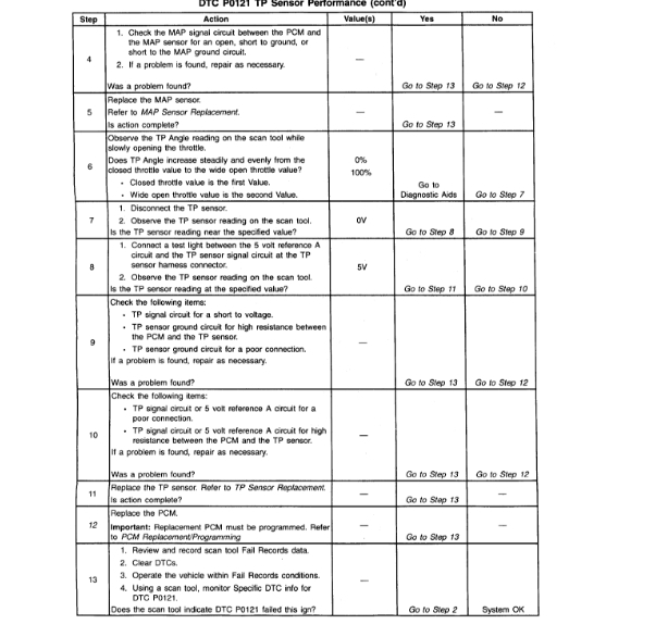

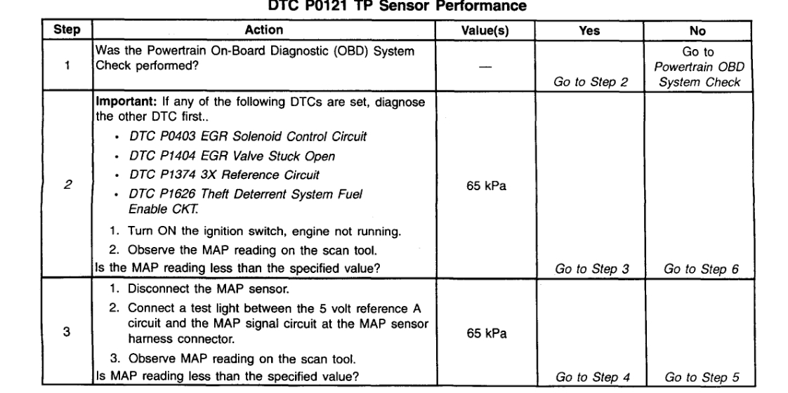

TEST DESCRIPTION
Number(s) below refer to the Step number(s) on the Diagnostic Table:
2. An incorrect MAP signal may cause the PCM to incorrectly calculate the predicted TP sensor value during high engine load situations. Check for an unusually low MAP reading. This condition can cause DTC P0121 to be set.
12. This vehicle is equipped with a PCM which utilizes an Electrically Erasable Programmable Read Only Memory (EEPROM). When the PCM is being replaced, the new PCM must be programmed. Refer to PCM Replacement and Programming Procedures in Powertrain Control Module (PCM) and Sensors.
