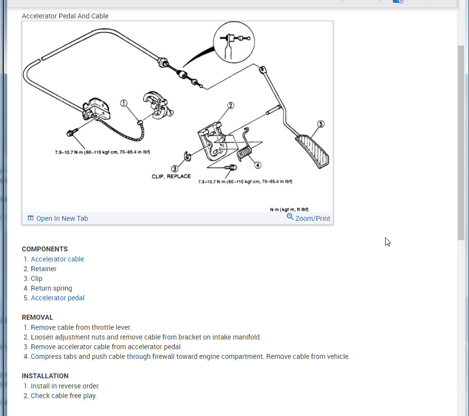

I haven't been able to solve this issue. Every morning and every time i go home i get in the car and the Throttle is stuck closed. I can push the gas pedal and it will pop out no problem, but what's going on? I thought it might be a dirty Throttle body but that thing was clean. I hardly removed any build-up. Any ideas would be much appreciated.
