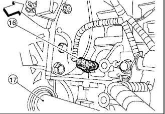

We need more information to help you fix the problem. You can unplug the MAF sensor to see if the problem goes away, also here is the location of the crankshaft sensor. Check out the images (below). Please let us know what happens.
