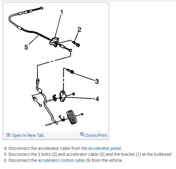

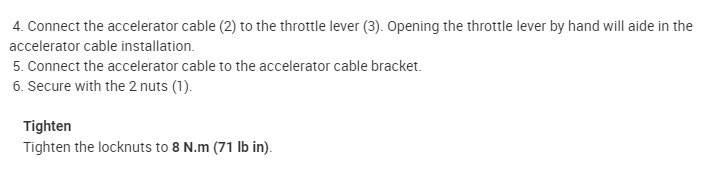

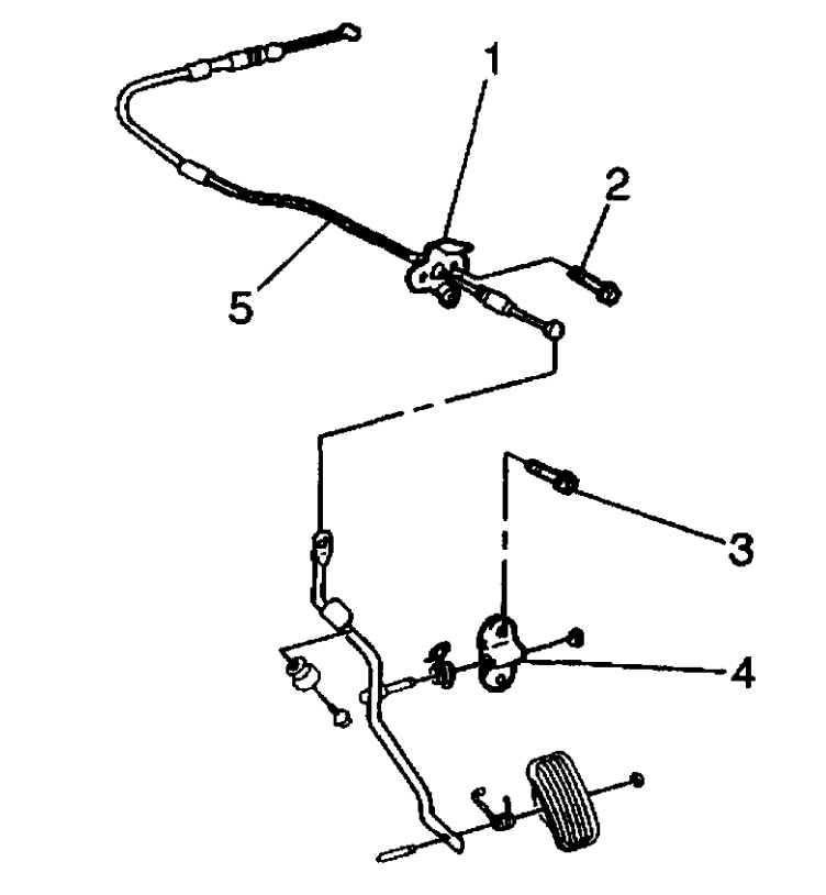

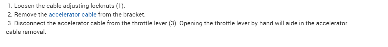

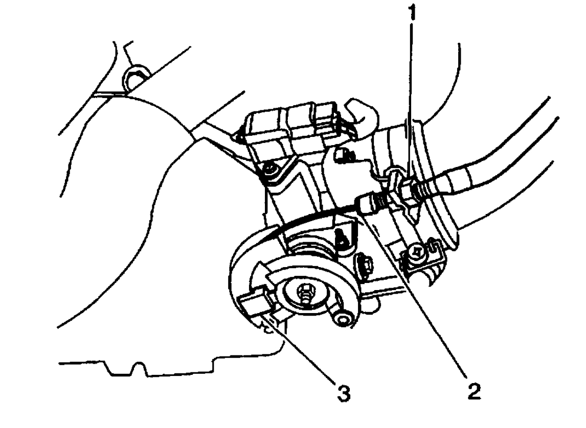

The throttle cable snapped and I need to know how to replace it.

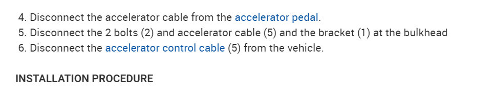

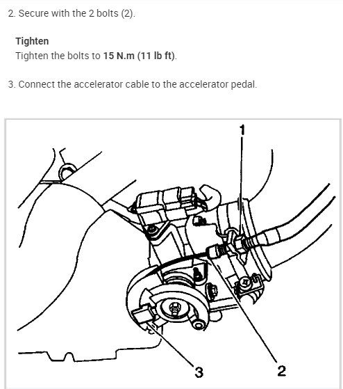

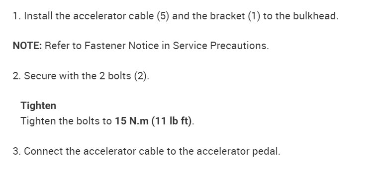

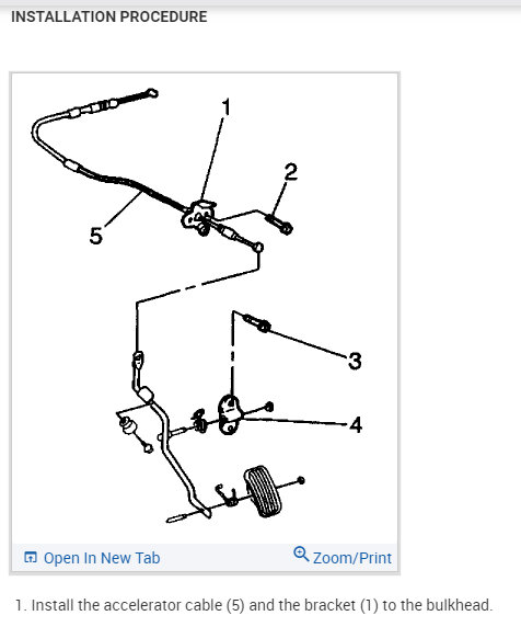

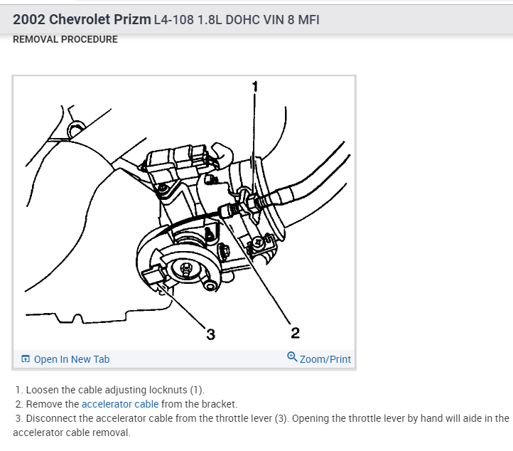

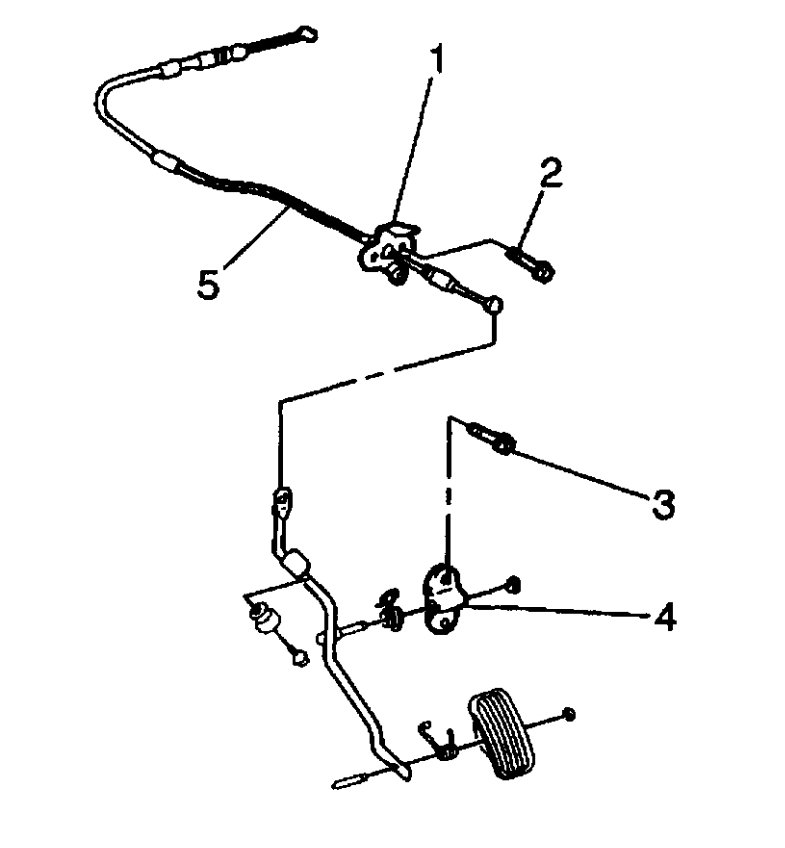

I've attached step-by-step pictures below that will guide you. Hope this helps and thanks for using 2CarPros. Check out the diagrams (Below). Please let us know if you need anything else to get the problem fixed.

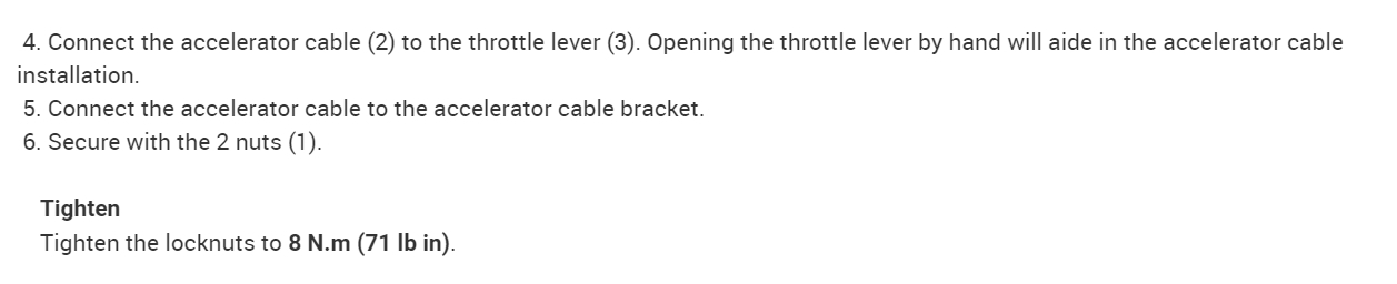

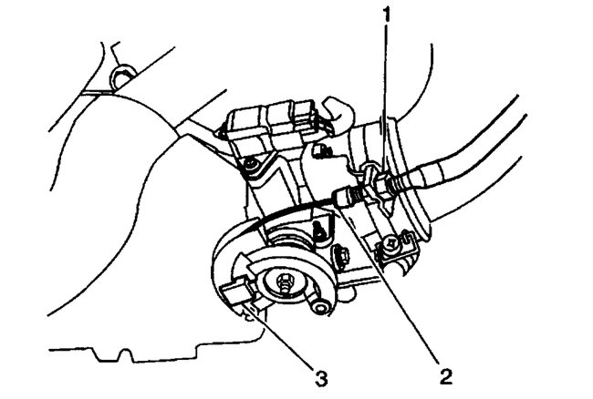

I was changing the throttle cable and had to remove the throttle control lever. Now that I'm ready to put it back on I can't remember how to get the spring on right. I would really appreciate some instruction on how to put the throttle control lever back on.

In the diagrams down below I have included instructions for the removal and installation of your vehicle's throttle cable. There should be what you looking for in there. Please get back to us with how everything turns out.

I got it and everything is working fine! Thanks for your help.
