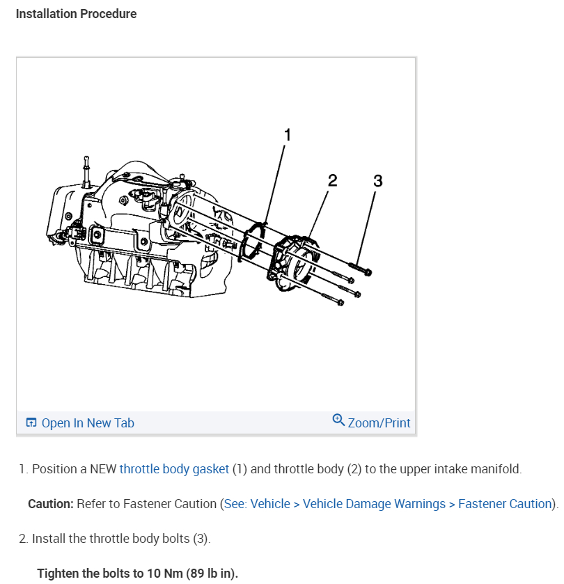

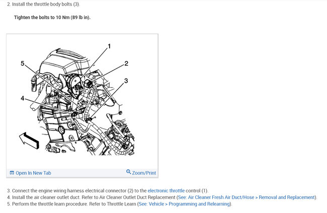

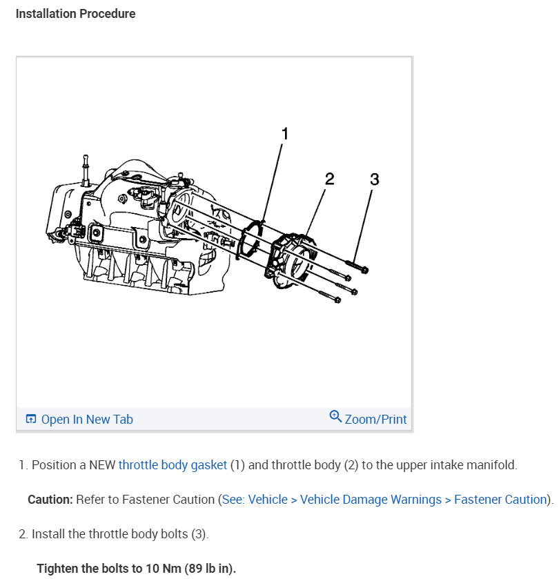

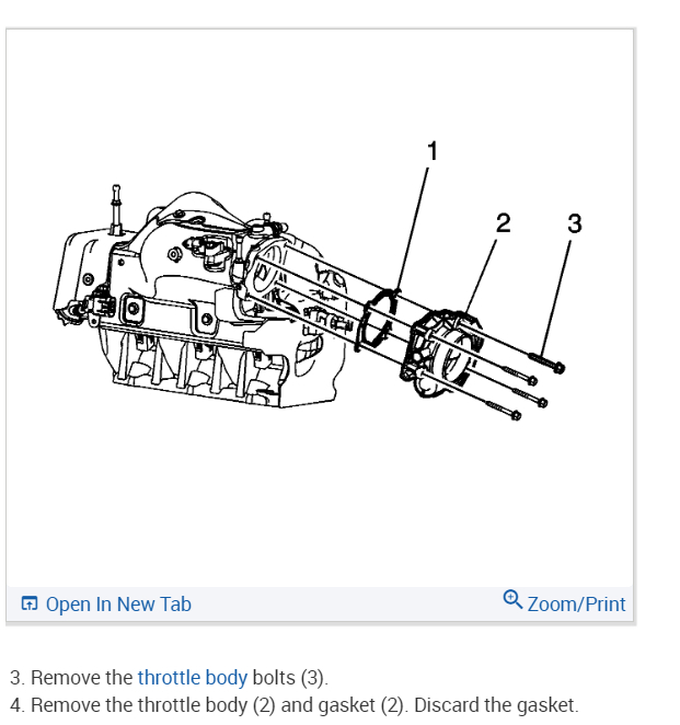

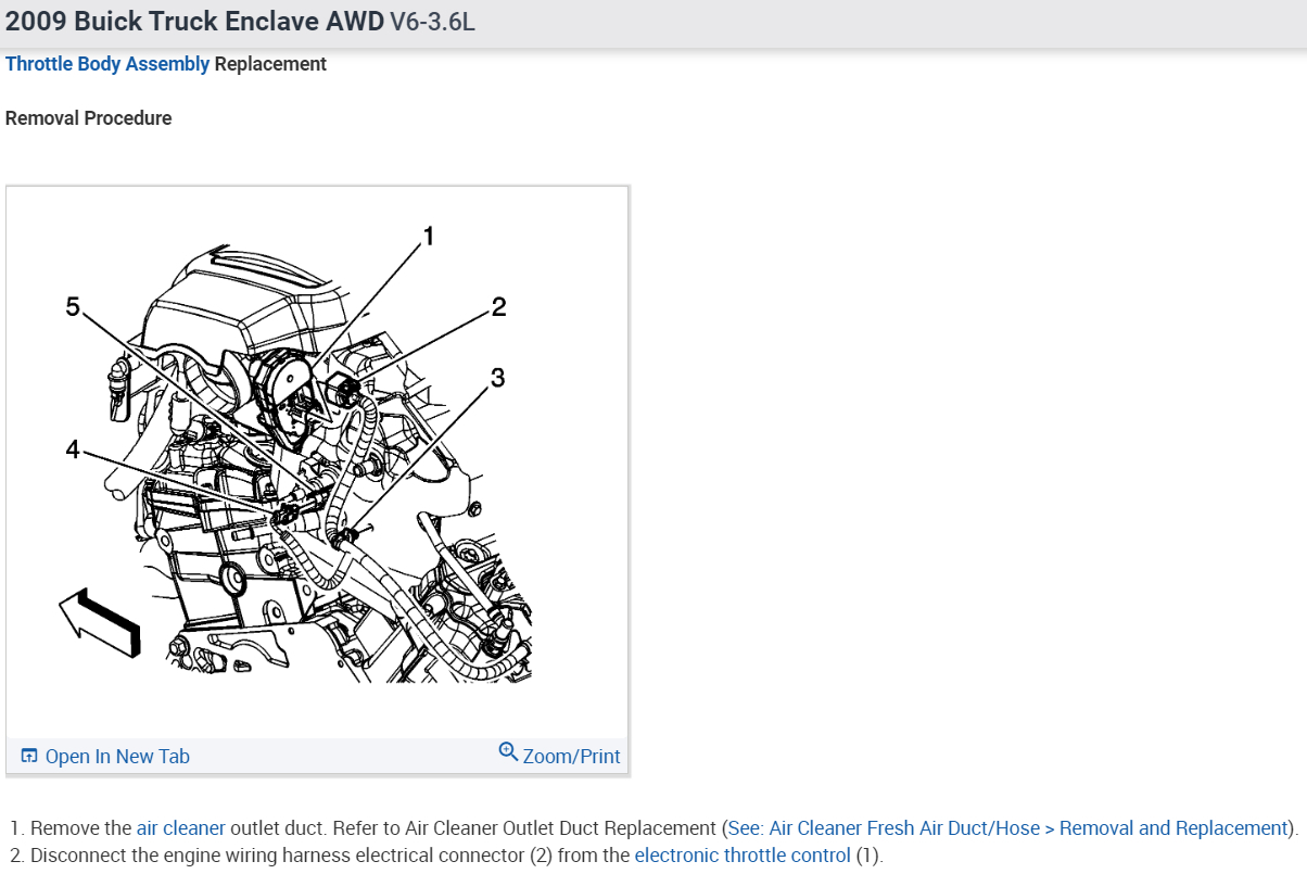

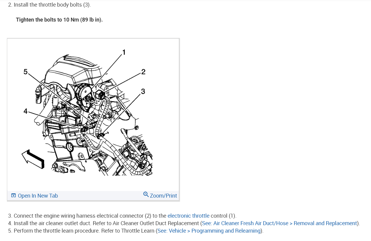

Here are the throttle body relearn instructions and the correct way to replace the throttle body in the images below.
Description

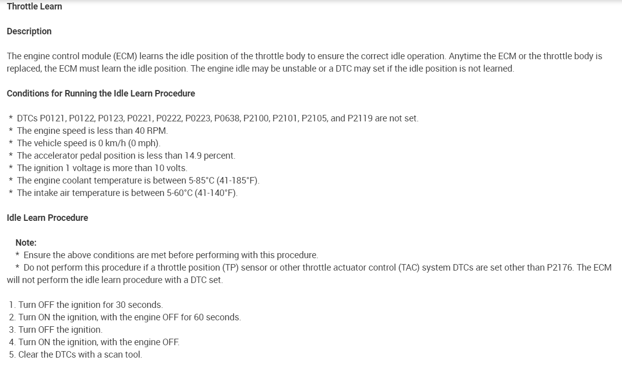

The engine control module (ECM) learns the idle position of the throttle body to ensure the correct idle operation. Anytime the ECM or the throttle body is replaced, the ECM must learn the idle position. The engine idle may be unstable or a DTC may set if the idle position is not learned.
Idle Learn Procedure
Note:
* Ensure the above conditions are met before performing with this procedure.
* Do not perform this procedure if a throttle position (TP) sensor or other throttle actuator control (TAC) system DTCs are set other than P2176. The ECM will not perform the idle learn procedure with a DTC set.
1. Turn OFF the ignition for 30 seconds.
2. Turn ON the ignition, with the engine OFF for 60 seconds.
3. Turn OFF the ignition.
4. Turn ON the ignition, with the engine OFF.
5. Clear the DTCs with a scan tool.
Check out the images (below). Please let us know if you need anything else to get the problem fixed.
