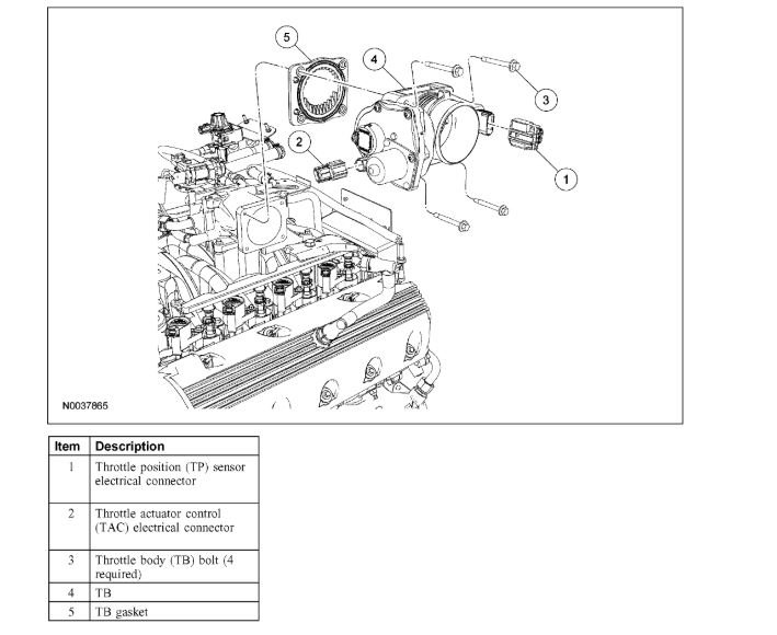

There is no relearn for the throttle body itself. It is a plug and play.
https://www.2carpros.com/articles/stall-at-idle
