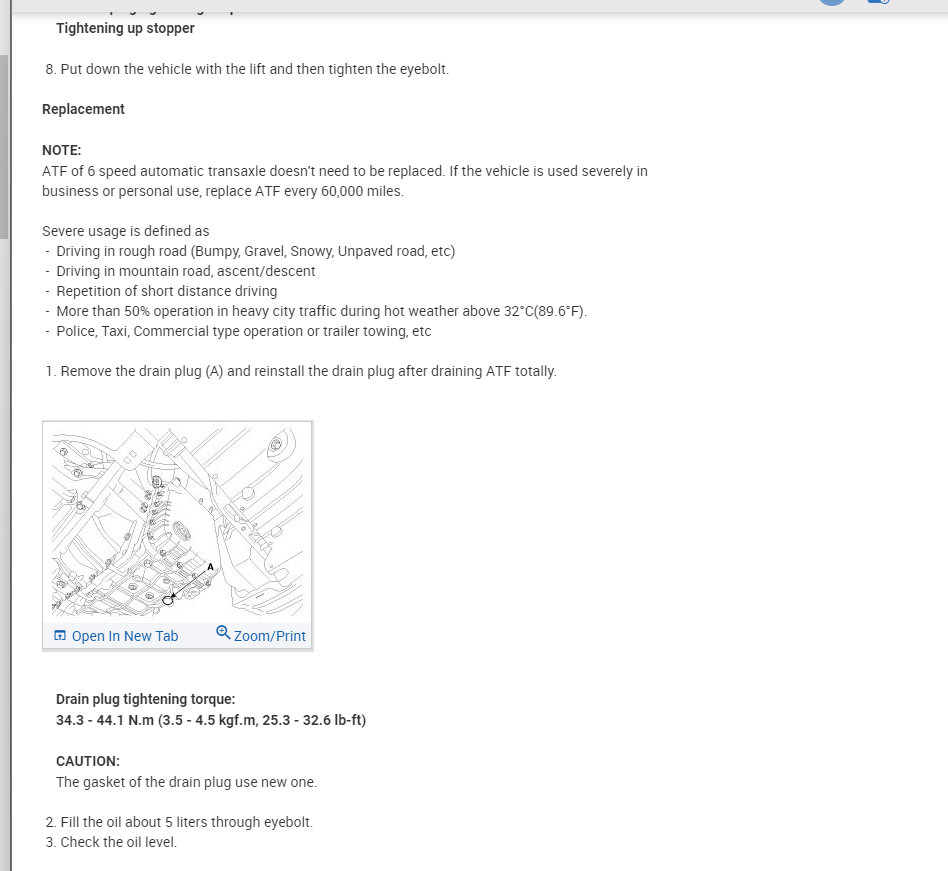

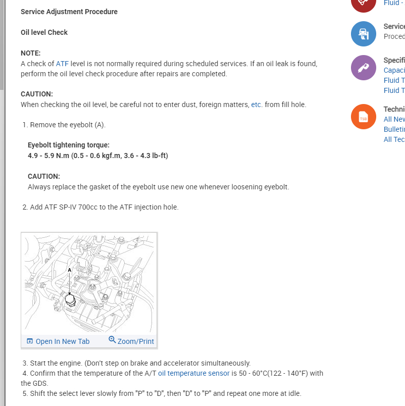

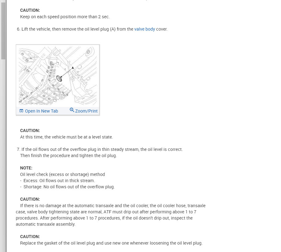

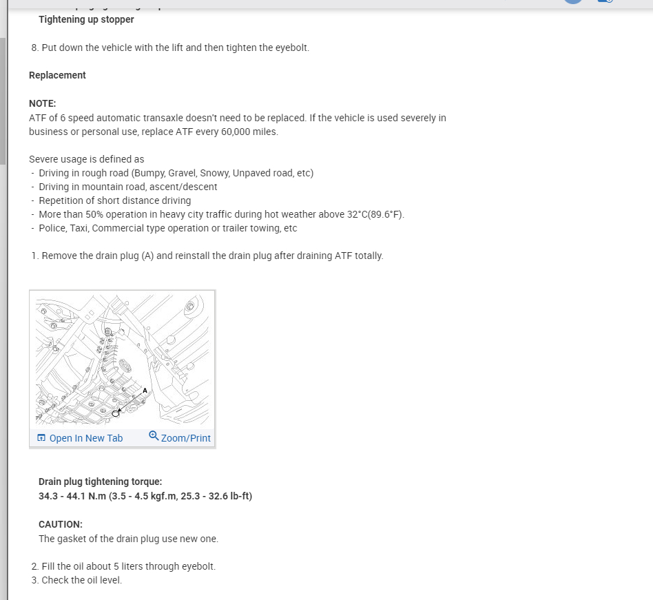

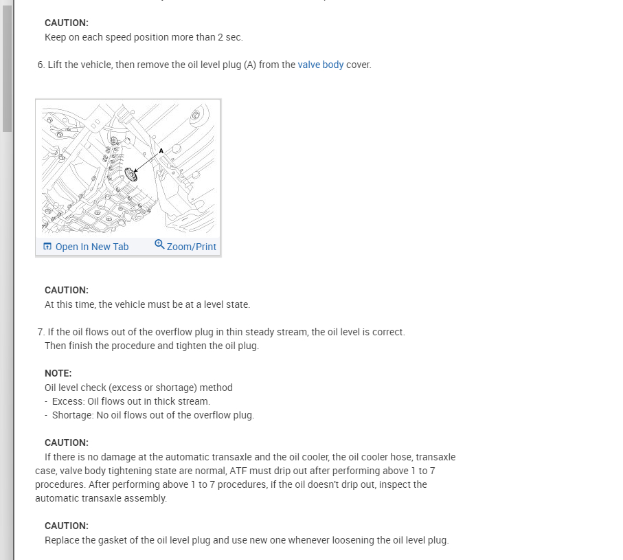

If this is when the vehicle is in gear, I would agree that the throttle seems like the likely issue but if the throttle body made no difference, then we need to check the transmission fluid and see if there is metal or debris in the fluid.
https://www.2carpros.com/articles/how-to-check-and-add-transmission-fluid
What I am thinking is happening is the torque converter has failed and it is not performing the torque multiplication that it should. Basically, it takes the engine RPMs, and it moves the fluid through the converter and spins the transmission input shaft. When the stator inside the transmission is not spinning like it should, the RPMs will be limited to around 1,000 and the engine will have no power. So, if this is happening, we should see something in the fluid that would point us to this.
