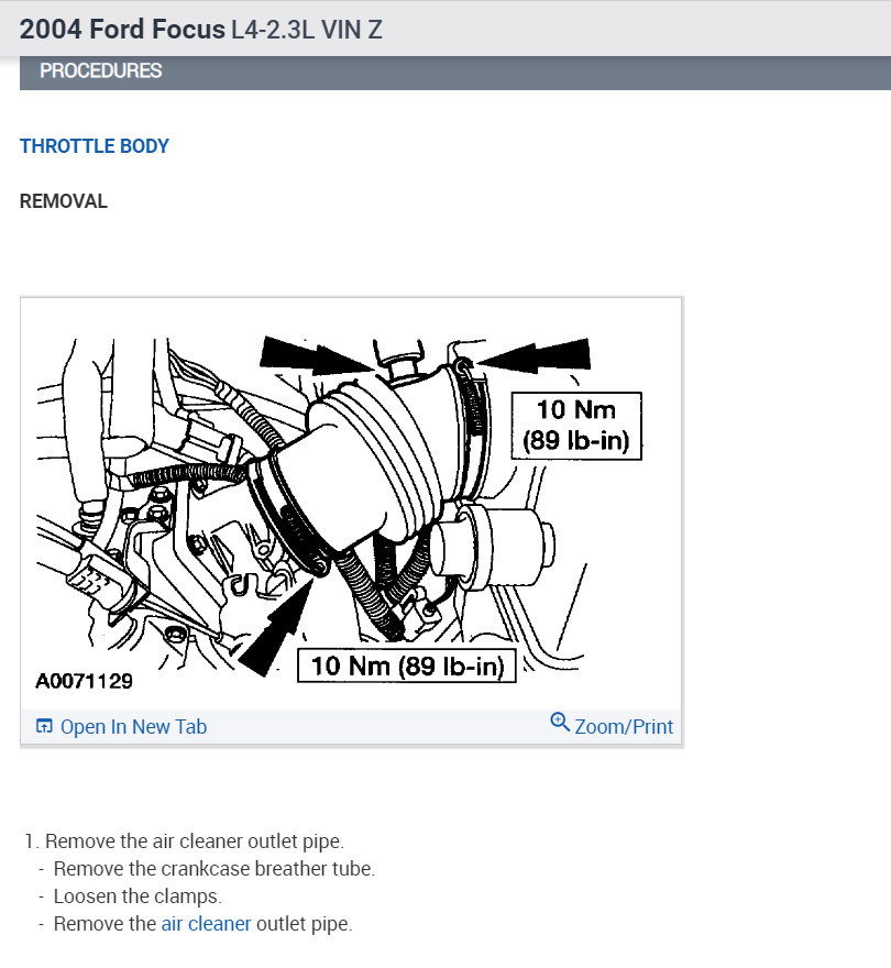

Can you upload an image of the part you are talking about? It sounds like there is a vacuum leak and you are plugging the holes in the air intake boot? To confirm use this guide with the engine cold and check the images below to see if this is what you are talking about:

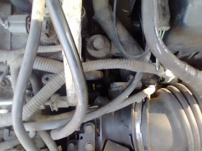

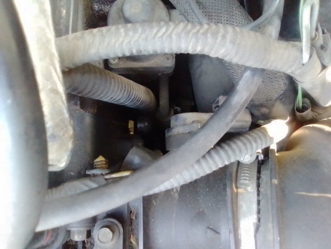

Thank you KenL. I am uploading an image. It is in the same vicinity as the image you provided in your response, but more underneath the hoses, close to the throttle body and catty corner to the 4th spark plug/coil. In the close-up picture, it is the two pieces of plastic stalks, white on left of black stalk.
I hope that is clear enough direction or image. I am used to being the assistant flashlight holder on older vehicles (LOL), but would like to learn my own newer vehicle correctly. Again, thanks for the quick response!
Sep 3, 2022 at 4:11 PM
Thanks for the images. The lever you are referring to looks like a holder for the wiring harness. If you can use a pointer to confirm it would help. It might help if we run the codes to see what comes up, also can you upload a quick video of what the car is doing? You can get a code scanner from Amazon for about $20.00.
