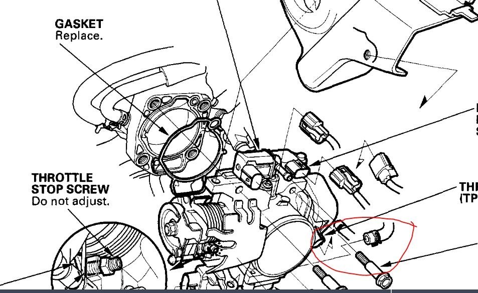

I have the vehicle listed above EX. I had to replace my throttle body. There are two nipples that coolant runs through on the side and back. Where do they hook up to?

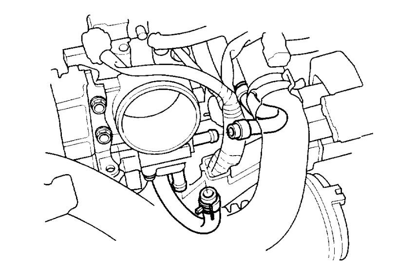

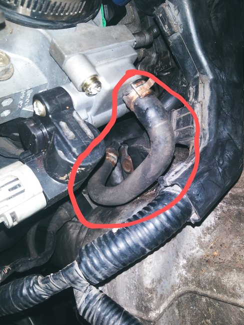

Good morning,
I attached a picture for you. I circled one of the lines. Are those lines the ones you are referring to?
They are part of the cooling system and must be hooked up.
Did you remove them when you removed the throttle body?

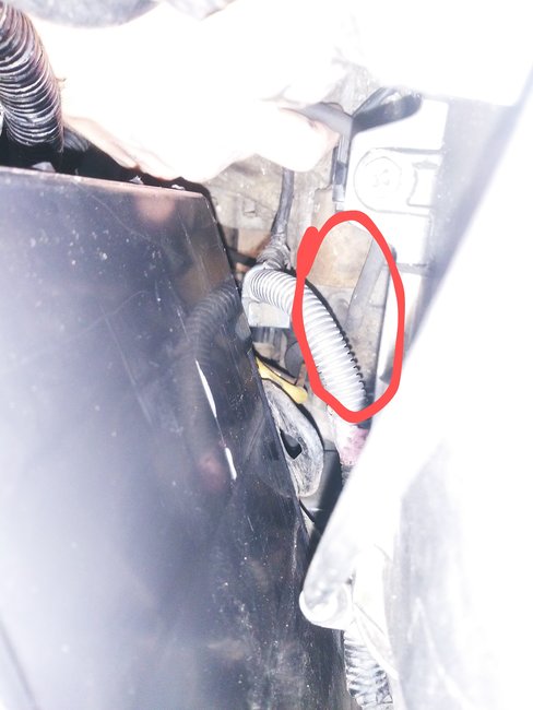

My dad took it all apart and is putting the new one in. But yes those are the lines I'm talking about. I've hooked up the inlet. Just don't know where the outlet goes.
Jun 19, 2020 at 3:50 PM
They both go to the cylinder head. Follow the one down to the head and llook for the other hose.
Jun 19, 2020 at 3:55 PM
KYLEDMARTINEZ98
  • 15 POSTS
This one is the inlet.

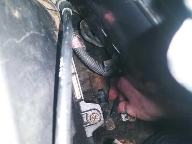

I'm sorry it's hard to see but this is the outlet.

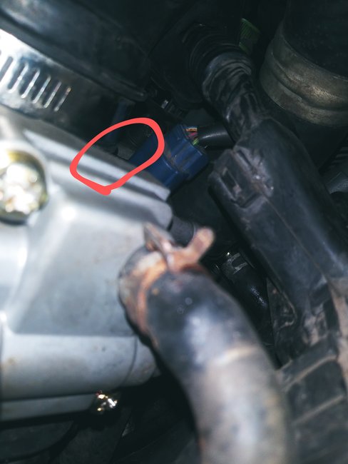

I'm holding a line that was not hooked up to anything. I'm not sure where this line goes to.
Jun 20, 2020 at 2:05 PM
KYLEDMARTINEZ98
  • 15 POSTS
Also hard to see but this is where that line leads to.

There has got to be an open line somewhere for the other hose. They both come from the head.
did you look all around the manifold?
A last try would be to add water to the system and watch for a leak from the open line.
