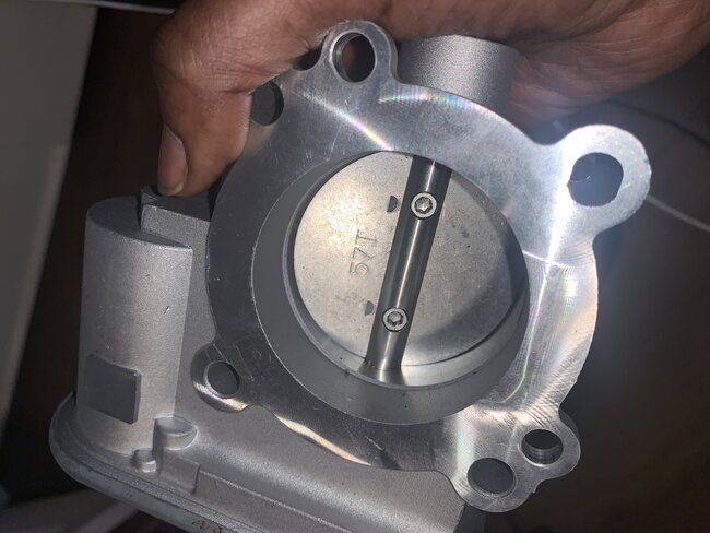

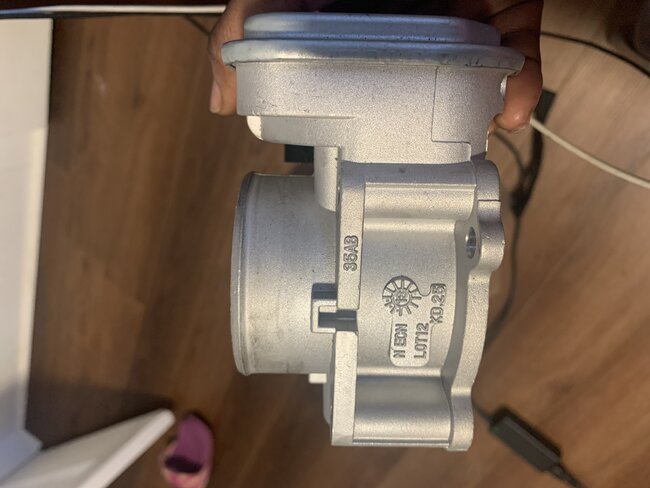

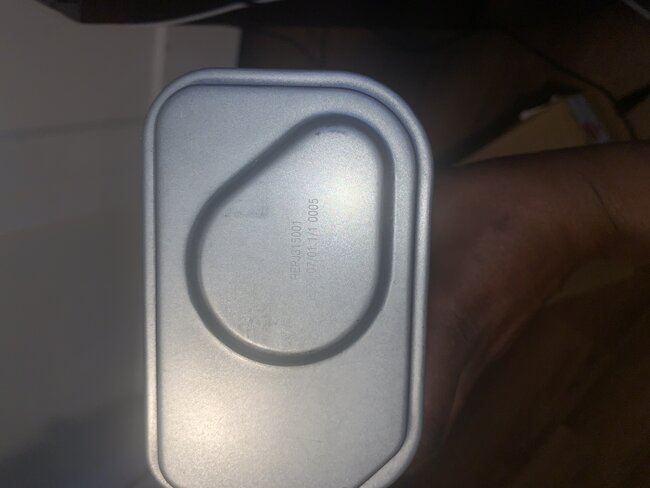

The OEM throttle part number is 4891735AC.
Fitments are,
2011-2014 200,
2007-2014 Avenger,
2007-2012 Caliber,
2009-2017 Journey,
2007-2017 Compass and patriot
All with 2.4L engine.

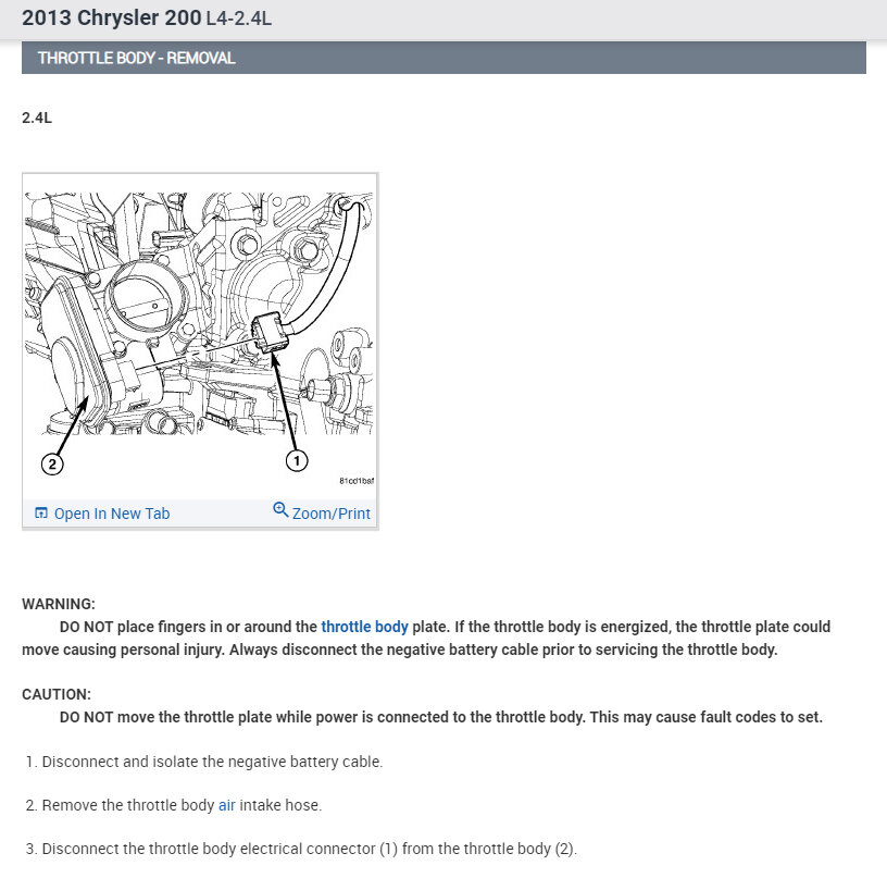

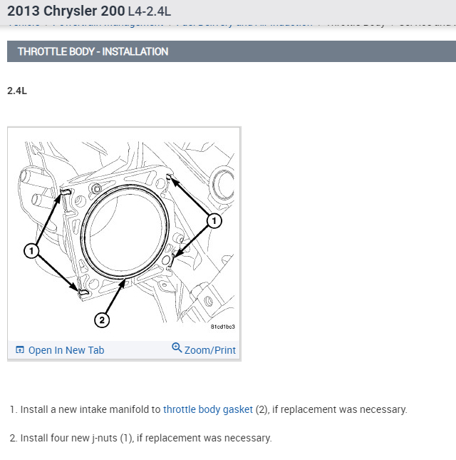

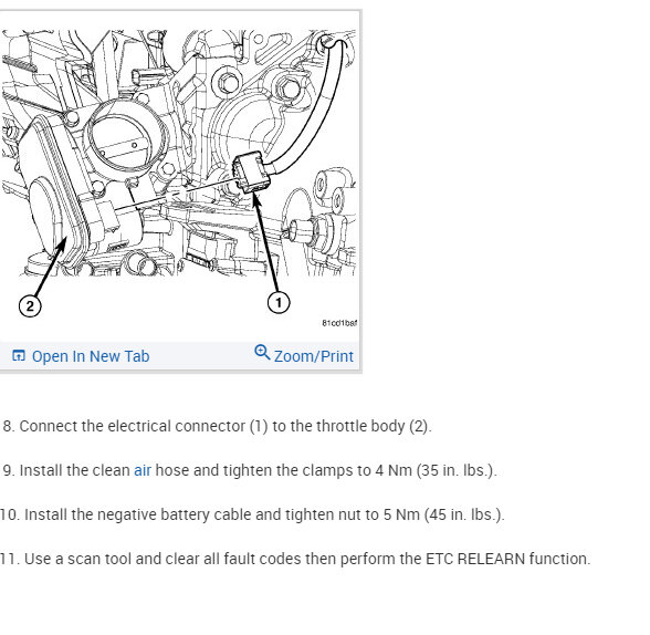

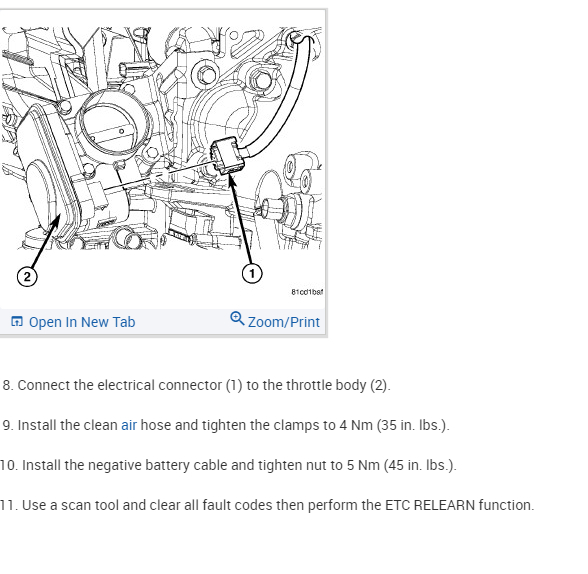

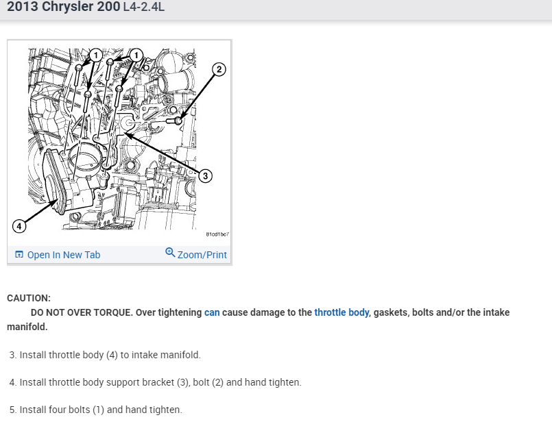

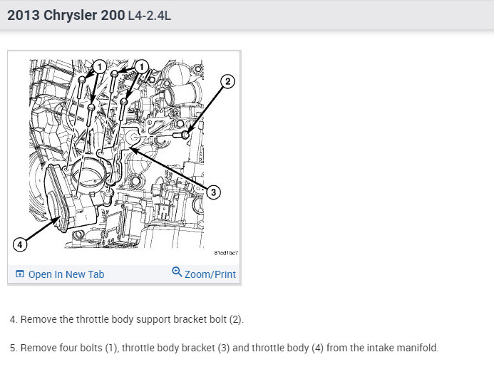

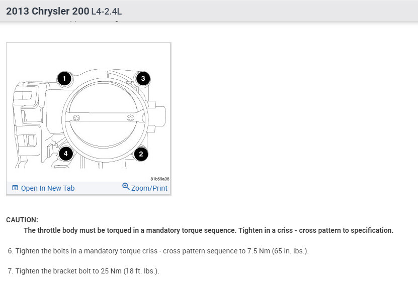

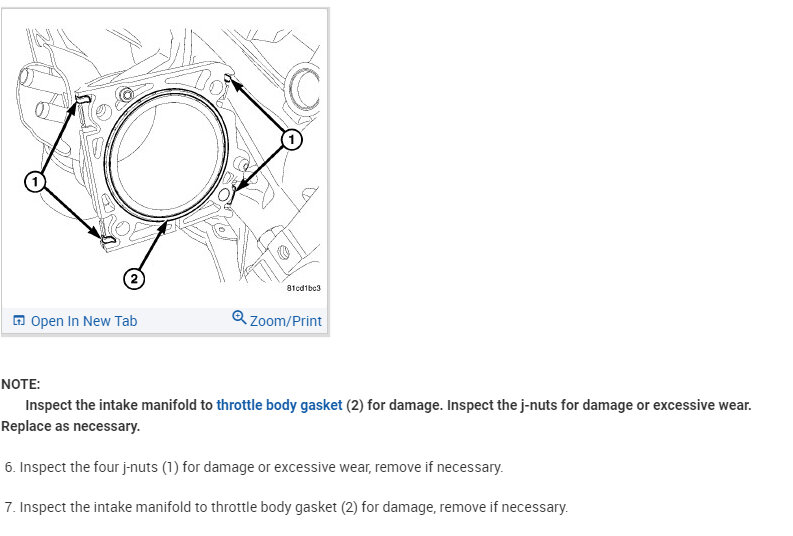

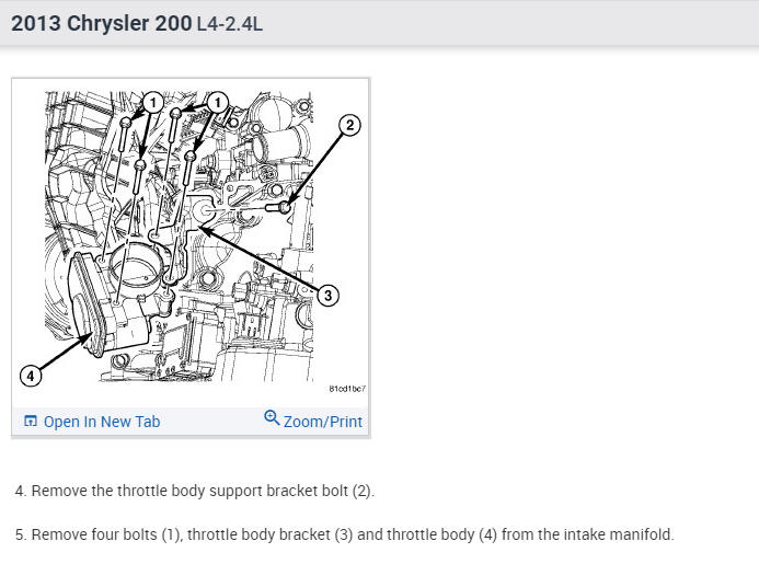

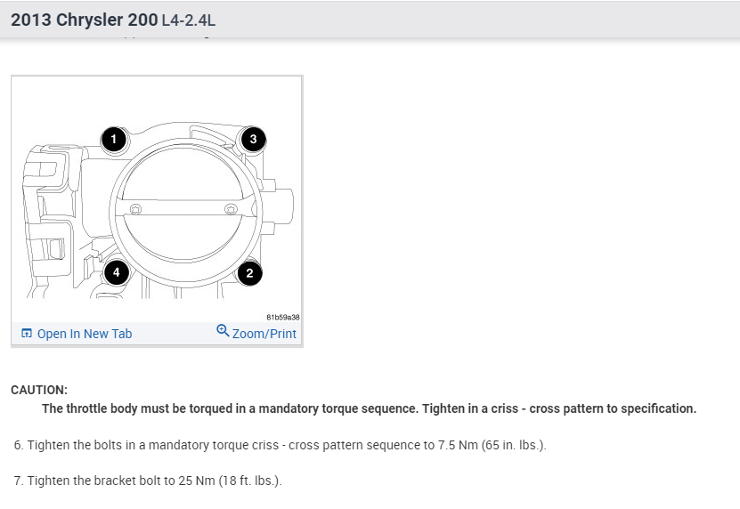

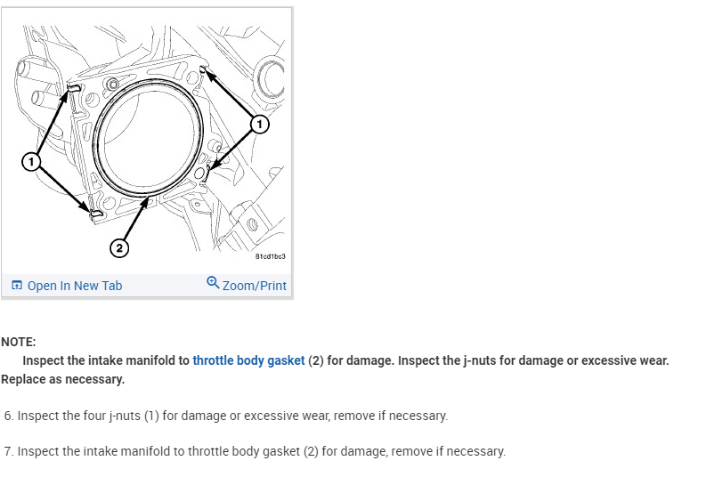

I have attached the replacement procedure below.
Let me know if you have any questions.
