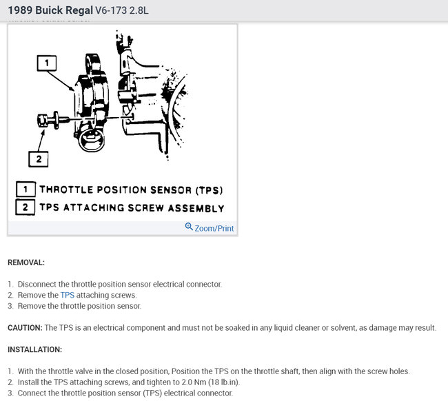

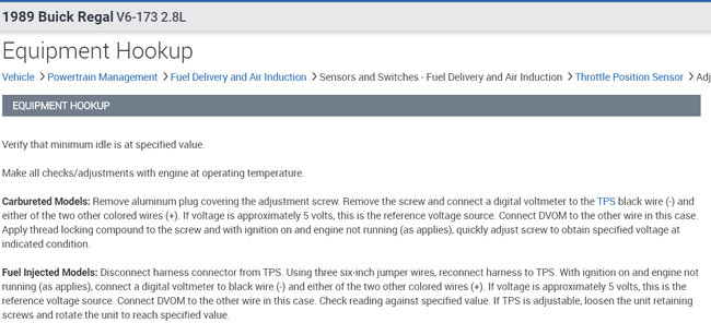

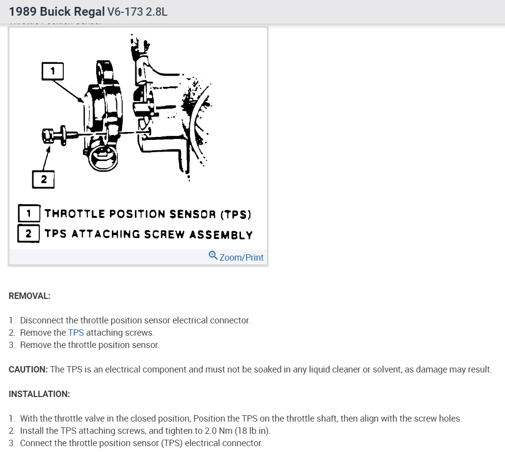

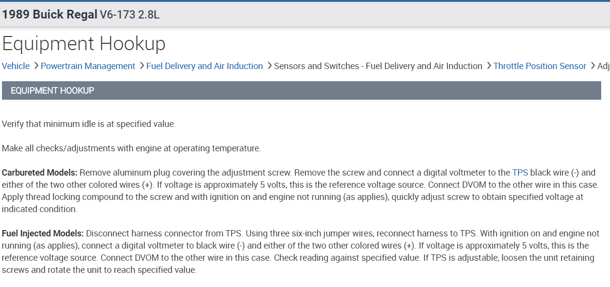

Here is what the book has to say about replacing the TPS sensor. Check out the diagrams (below). Please let us know what happens.
