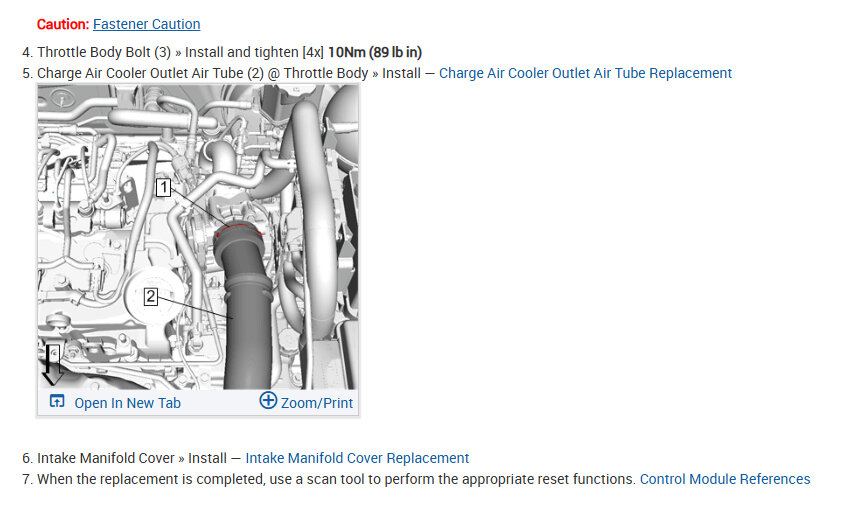

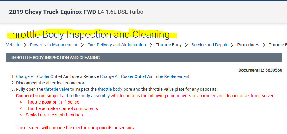

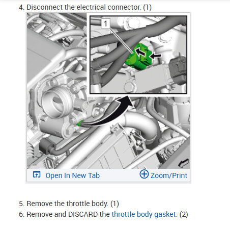

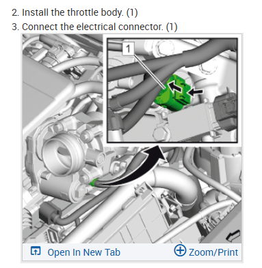

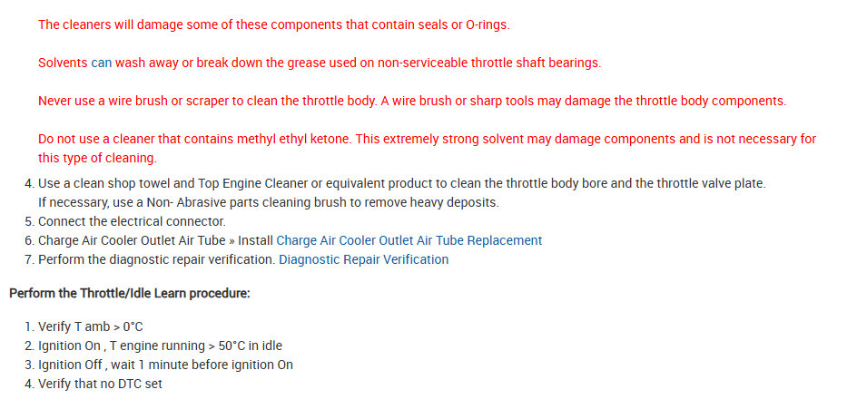

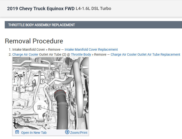

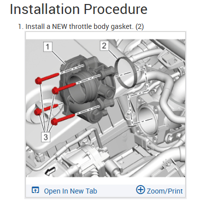

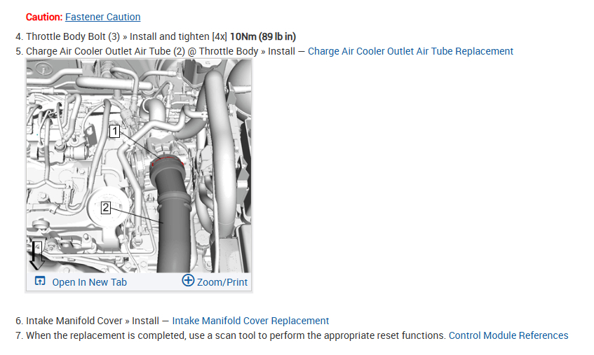

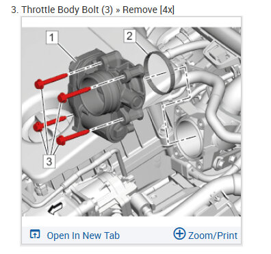

If you look below, I attached the directions for removing and installing the throttle body. Additionally, I attached directions for cleaning and inspecting it.
