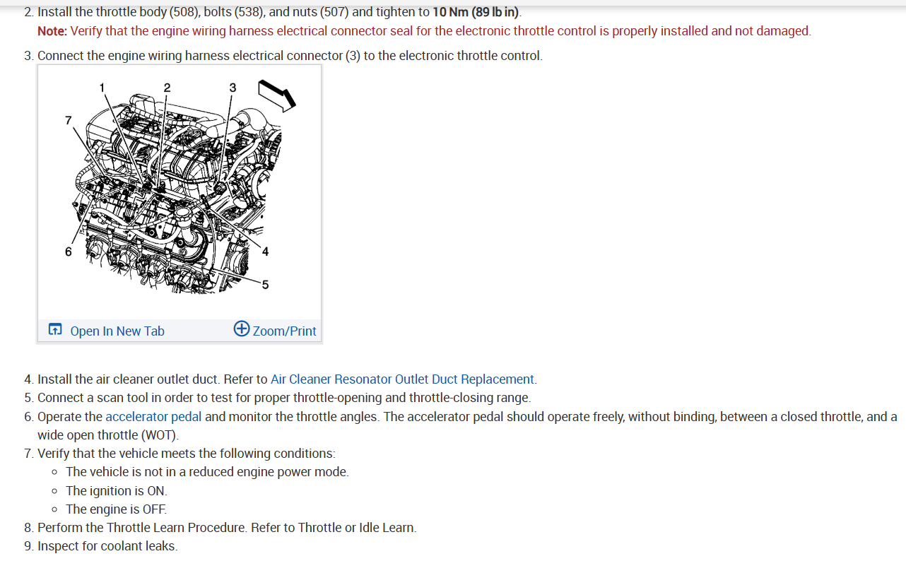

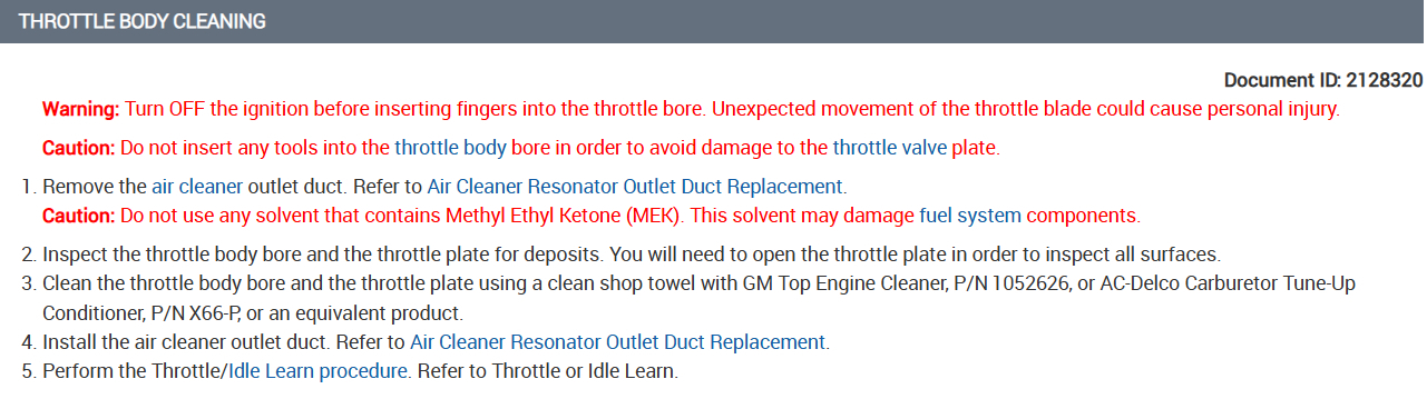

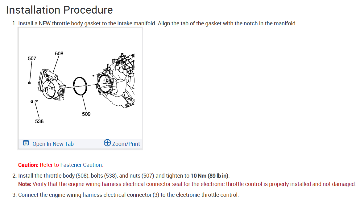

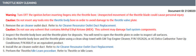

Yep, they don't like to be opened manually, we just leave them shut and clean around the bore the best we can or reprogram the throttle body. The truck won't drive because it is in limp mode.
This guide can tell you more:
https://www.2carpros.com/articles/reduced-power-limp-mode
Here are the instructions on how to do the job correctly. Clear the codes before you begin. Check out the images (below). Please let us know what happens.
