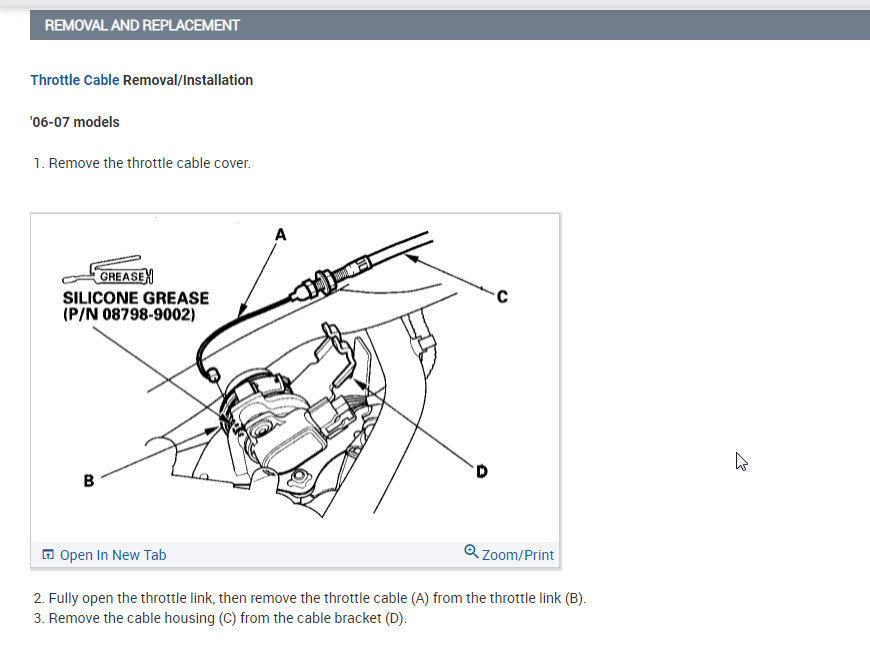

We replaced the starter because it went out. Then we got in to rev it up and nothing happened. We replaced the throttle module and still the same. You can hear the depressing of the accelerator pedal but still won’t rev up the engine.
